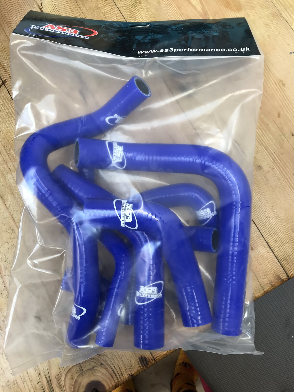

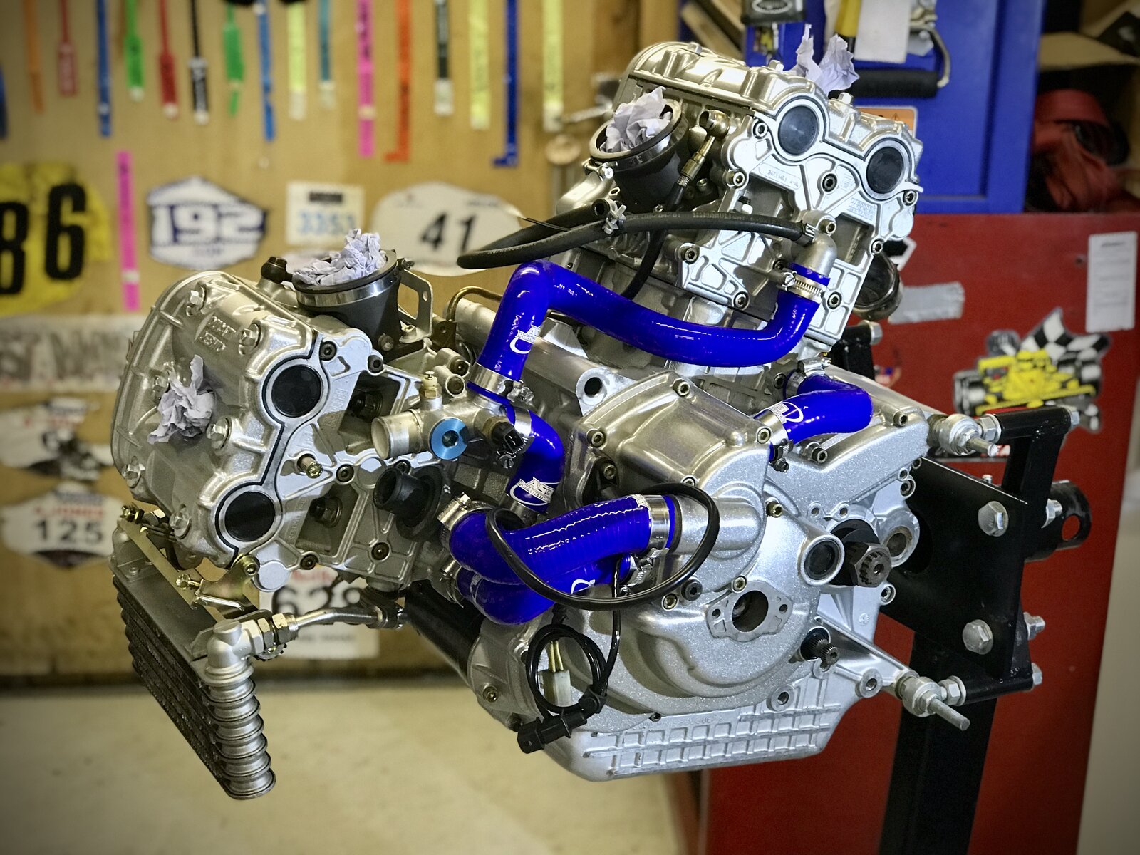

AS3 worked for me, did need a bit of trimming for a good fit. I trimmed by putting a jubilee clip on the hose where I needed to cut it and using it as a hard guide. Perfect cut.
You would expect that this ought to be noted on their package somehow to raise awareness and assist in an informed pre-purchase decision, particularly as many bikes are stored indoors.
Those look perfect and exactly you what I’m after….did AS3 build the kit specifically for the 748 for you or is that a kit for a different Ducati that you’ve adapted/cut to fit??
