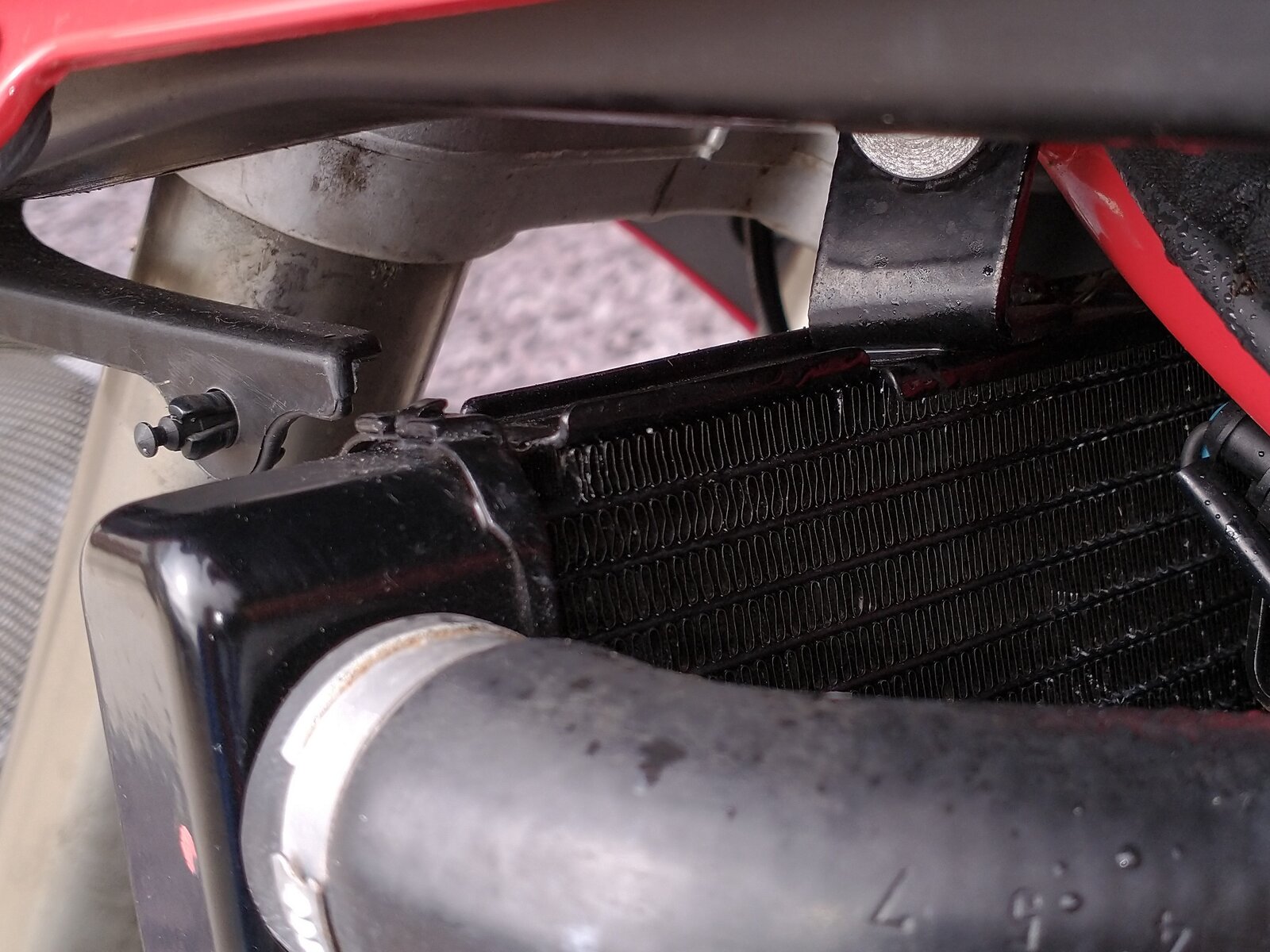

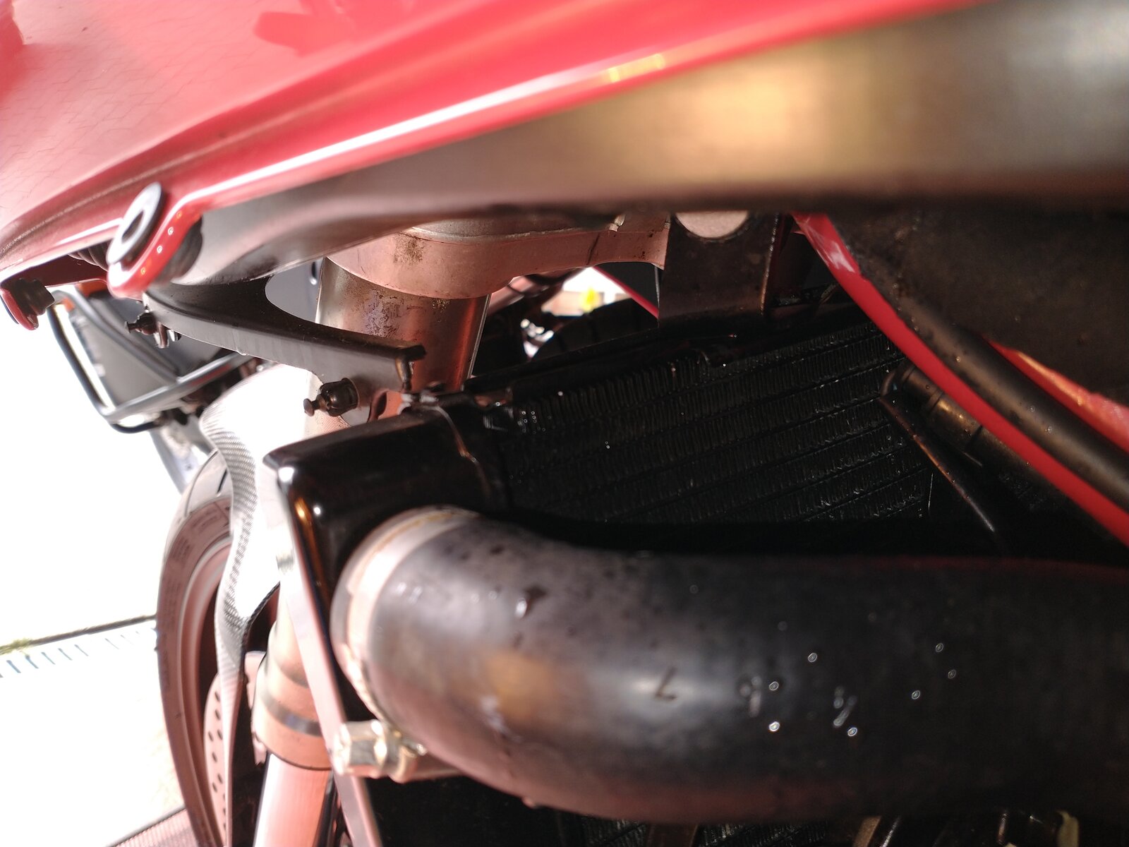

    quick one here as my issues are growing and I cannae keep up Captain!
    Anyway, my 2008 848 has sprung a coolant leak from the left, upper bracket that holds it to the frame; not happy, it fair squirts oot when the throttle is applied!
    I have attached a few piccies for your perusal and welcome any ideas, suggestions or otherwise; Some have a screw driver inserted to show the leak point.
    Is it fixable or am I looking at a new rad?
    If I can get it fixed does anybody know a good place on the West of Scotland, particularly Glasgow?
    Are weak brackets/welds an issue? Should I be worried?
    Cheers in advnce
    BTD

  7. Yup, it does look like a serious option. However, I have been consulting the Hive mind on Utube and it seems that brazing pin hole repairs is not that hard, I am tempted to give it a bash just to learn the skill. I console myself by the simple thought that the radiator is already fecked, I can't make it any worse, only better. The only issue being the location of the hole, I may have to remove the bracket to effect a decent braze and I don't know how the brackets are mounted; thats for tomorrow...stay tuned!!!

  10. The next question is...if I am going to epoxy the hole can it be done in situ?
  11. Would epoxy be up to the job? The hole is caused by metal fatigue from the bracket flexing onto the radiator.
  12. as above, that looks very similar to the one i fitted a few years ago and it's been fine. It did need some fettling* as said, I had to tweak the fan mounts and the lower fixing needed a totally different fixing to standard. Also as said, you will struggle to beat that price even direct from China now.
    * it took me 3 attempts to get an acceptable rad but I think these were teething problems that are in the past. The two issues on separate rads were:- fan fixings so far out that tweaking was out of the question, and the second one had the filler neck too high so was distorting air filter intake.
    On the epoxy front, I tried this on an 851 rad before I found an ST2 could be modded and it held pressure for around 6 months but started to slowly weep again. Maybe careful preparation by bead blasting might have given the core a better key to effect a more permanent repair as getting in to clean and then apply the epoxy to the right area was half the problem, maybe not so with yours.
  13. Epoxied it for a larf in situ. We'll see how that goes! If it doesnt work tomorrow I'll get one of those cheap chinesium ones.
  14. agree, it won't remove the fundamental flaw so unless the core frame perimeter is braced then it will only leak again.
    @Bonkers the Dog not sure if you've had a look for previous threads but it's a well known design flaw that even lead to replacement under warranty when new in some cases here, (in the USA it was all cases!). They nearly always fracture on the left because of the argument between the two hose junctions and the rather inboard top L/H mount and the rather flimsy core framework perimeter but apparently can sometimes fracture in approx same place at top right also..
