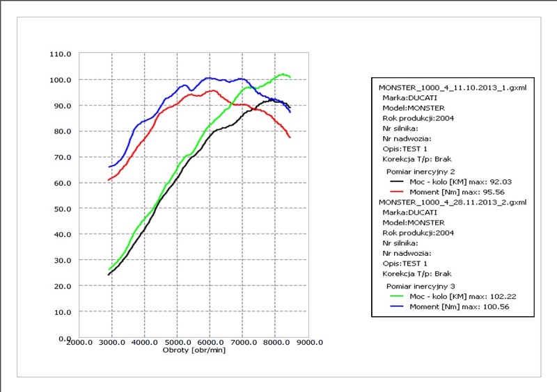

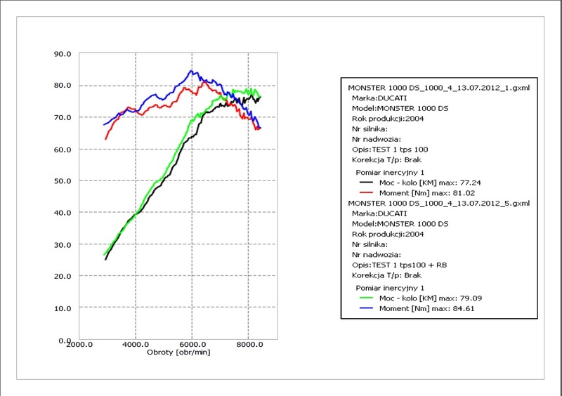

  1. It took me over year to get to this one. (all numbers are shown on back wheel so on crank should be more)
    Initially was:
    Black is power, red is torque - so standard monster with some slipones and racing air filter.
    Now is:
    Green is power, blue is torque. Funny thing about last chart is that only difference between black and green curve is main ignition map. Black is standard, as it came from factory, green is with ignition map from Monster S2R 1000 '08MY, so basically same engine different maps :)
