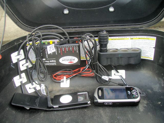

  16. Not heard of CB on bikes but I'm sure that's something guys in the US could shed light on..........especially Harley owners! lolNot sure of the advantages of CB if any over Bike2Bike but kit made specifically for use on bike has to win.....so that may exclude CB?
    Mounting space would be another factor, ingenious setup I remember seeing one time involved all hardware being mounted in the topcase with a couple of clever connectors ported into the back of it to connect with onbike wiring.
    Motorcycle Info Pages - R1200GS DIY Mods > Autocom install in Top Box
    Sorry, no specific recommendations but I'd have a nose around a couple of the 'adventure' biking sites e.g. advrider.com and or ukGSer.com and often some good reading on WebBikeWorld, see here:
    Motorcycle Intercoms - Radios - GPS - webBikeWorld
    ....scroll down to Motorcycle Radio Reviews and also Wired Motorcycle Intercom Reviews

  18. Yes thats what I'm looking for but after looking at that TopBox config; bloody Hell. I don't run a TopBox on the PP so I'm ultra pressed for space.
    The quest continues...
  19. No.....that's the 'pro' kit from autocom. You can get that, but it's meant to be a permanent fixture on the bike. Perhaps under the pillion seat if there is space.
    You can also get a 'personal' unit...wired or wireless (I have wireless) that can be plugged into the bile for power. You can then have the unit and radio on you, rather than the bike, or in a small tankbag. The pro unit could also go I'm a tank bag too... Check out the autocom website for ideas.
