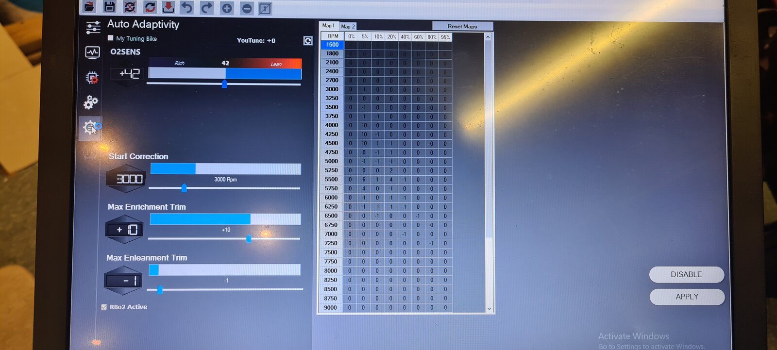

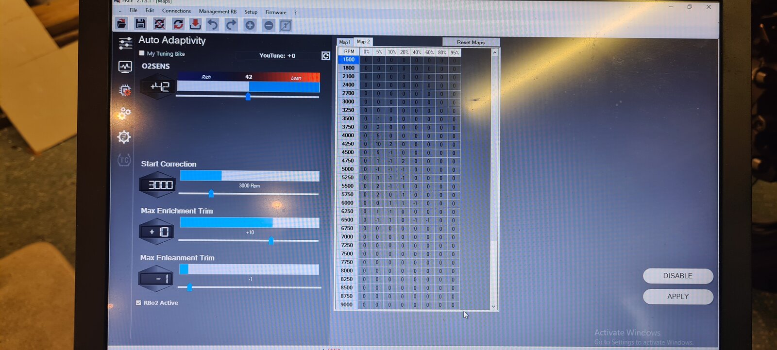

    I've uploaded the auto trim setting for you. As you can see, I've recently reset them then rode to Weymouth back at the end of October, about 30 mile round trip. It was cold, so not much full thottle action.
    I've also changed the enlearnment to -1 as I figured, overfueling would be less likley to cause it to misfire and I would hear pops/bangs from the exhaust. I dont beleive I had a misfire on the way back on that trip
    It was on the default settings to-7 and +7 IIRC but I had the issue then as well.

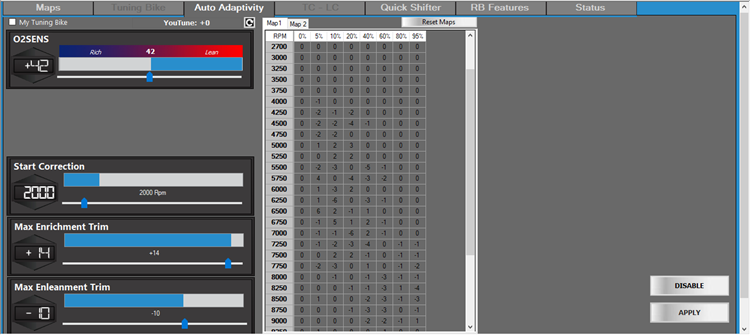

    this is an old screen grab i have on file,
    i think you should increase the - value to -10 and try the +14 setting i am using.
    also are you accepting the auto adaptive changes correctly?
    i save a copy on my laptop and indicate changed and date, and then accept the trim changes by right clicking over the Map1 or Map2 table, this will also ask you if your happy to reset the trim table.
    once you do this also save a copy and send to the RB unit ( if you don't do this the device is still on the old fuel table)

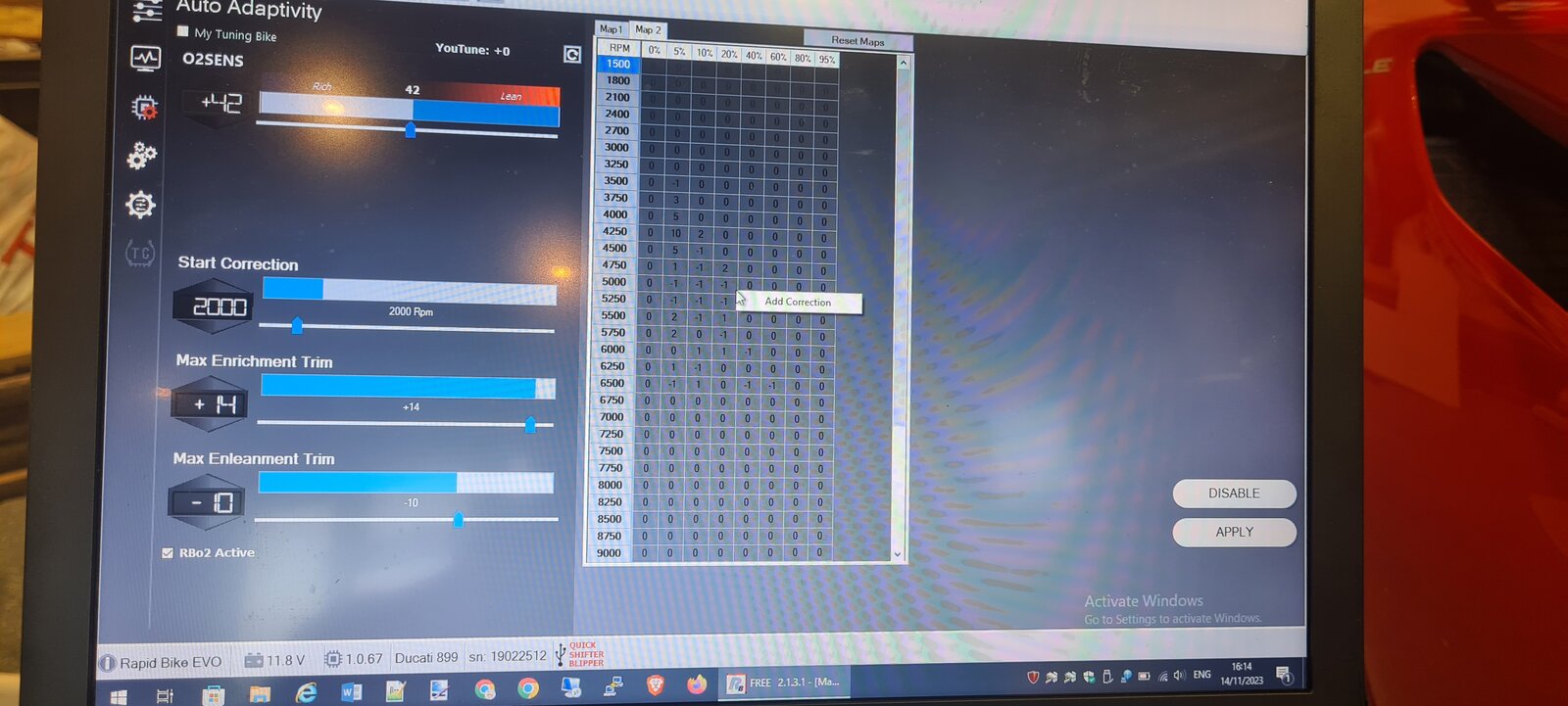

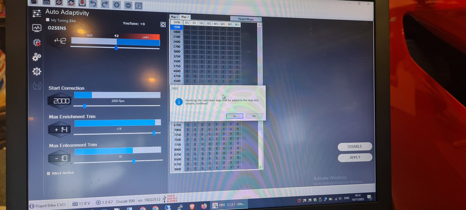

  10. Ah! I see what you mean about the Auto Trim settings. Its really not clear but when you Right Click on the Map1 & Map2 tabs, there's an Add Corrections pop up - I've now done this but it'll have to wait until next year to check it :(
    As you can see, Ive changed the settings to match yours.
    I'll do the cable check later in the week or tomorrow.
  11. i also found out the hard way as i ended up driving to a Semi local Rapid bike dealer, who took me through the software and adding the trim table changes.
    make saves and also send the new saved file to the RB unit otherwise it will be just on the saved file and not active.
  12. Thank you for sharing. That's really useful to know. I am backing up the RB settings from time to time but was not applying them as I figured that was automated in the background. I'll definitely apply these from now on. Appreciate your advice.

  13. If you are sure your O2 sensors are working correctly you can try +10 / -10 settings initially - I wouldn’t recommend going too high there’s potential for issues if an O2 sensor fails.
    Take the bike on a run - ideally using as much of the rev range in each gear as possible. It’s not ideal for the Rapidbike’s learning process to go on a sedate autumn ride as it doesn’t give it much data to go on.
    Then apply the changes for each cylinder - save the map and upload the map to the bike.
    Then take the bike on another run. Repeat process.
    And again.
    By around the 3rd time you should see less and less adjustment to the mapping.
    Initially you might see changes of the maximum value of 10 in quite a few of the boxes - these figures should reduce as you get closer to the optimum after each time you apply the changes to the map.
    Then you are supposed to reduce the values to +3 / -3 or similar to prevent massive changes being made in the event of a failed O2 sensor.
    Remember if you aren’t reaching the higher rev ranges in each gear it won’t be adjusting the mapping for that area - far easier to achieve on track than on the road.
    In the screenshots you have shown you can see it trying to add the maximum enrichment of 10 in 3 of the boxes from 4000 through to 4500rpm at 5% throttle. If you apply the changes and run the bike again then you should see that value drop as you can closer to optimum. Take screenshots before you apply the changes each time so you can compare changes and confirm those big numbers are reducing as they should. You can see from the table that you haven’t revved the bike out through the gears because it’s not making any changes for the higher rev ranges and throttle percentage.
    I would expect to see much greater adjustments being made on the first run with it reducing each time you apply the changes.
