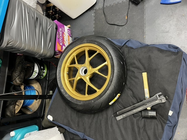

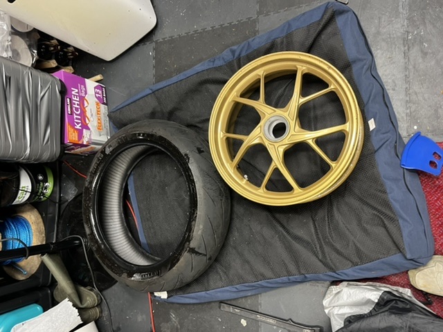

    Me change tyre myself! Rarrghh!
    Was surprisingly easy.
    The savings I’ll make will pay for the tools in 12 months. Plus more tools always good.
    Also - more convenient to change tyres at my whim.

  3. Are you totally sure the tread pattern is going in correct way?
    :D
  4. Well done, envious; it was bad enough replacing tyres on trad steel rims - had levers flying all over the place and trapped too many digits - quite dangerous IME!
  5. Yeah. I checked and double checked. Then drew a big fuck off arrow on the tyre in chalk. :D

  6. Nice work. How much is the rig out of interest? I’ve got a compressor and the local bandits where I live charge me £15 a tyre! Fleecing bar stewards….
  7. And soapy water all over the place. And pinching inner tubes. One of the few jobs I don't ever want to do again!
  8. Once the tube is installed put a small amount of air in the tube to get it to shape before fitting the other bead, prevents the flat tube getting caught by a lever or the bead.

  10. Thanks! I feel inspired :) My mate must have changed 30 odd tyres in front of me but we were always blethering away while he did it and I didn’t really pay much attention to what he was doing:laughing: Isn’t that terrible? But the poor bugger passed away so it’s too late for tutorials.
    I’ve got a compressor in the garage so I’m toying with the idea of going all in:D:fist:
  11. I actually inflated and seated this with a normal electric car tyre inflator…although I had ordered a compressor from ScrewFix (£99) it hadn’t arrived when I did this. Will probably be even easier with a proper compressor!
