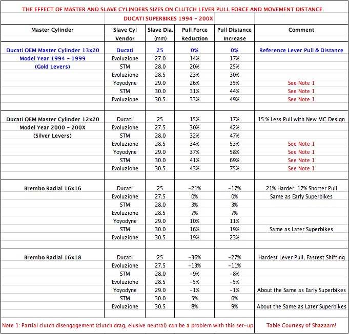

  1. As the title says, what's the best size RCS clutch master cylinder when used with an Oberon clutch slave cylinder?
    Anyone running an RCS master with an Oberon slave please chip in with how it is for you!
    If you can't answer that do you know the size of the OEM Panigale clutch master cylinder piston size? There's so many numbers on the OEM m/c I don't know which, if any, refer to the piston size.

    Yes the Oberon unit is 29mm (I think the stock 999/1x98 slaves are 26mm iirc).
    That makes sense regards the RCS19, as I understand it the larger the m/c piston the more force is required to activate it (because you are forcing more fluid through the same diameter hose in the same amount of time) but requires less lever travel for the same effect.
    The opposite is also true, a smaller piston will require less effort but will require a longer 'pull stroke' (here we go...) to achieve the same amount fluid movement.

    Feel, travel, light/heavy-ness, etc etc are related to the size of both the master and slave piston viewed as a system, it's the ratio between the two that determines 'how' it will perform.
    I think the OEM Ducati clutch slave piston is 26mm, Oberon is 29mm.

    Yeah I think as long as the lever doesn't come back to the bar the total plate separation will probably always be the same or similar, it seems to then come down to how much hand force is required to get it and how easy the clutch is to modulate when required.
    OK I'll bang in an order for a 16 and will get used to it anyway, thanks again for your help and to all the other contributors - cheers guys! :upyeah:
