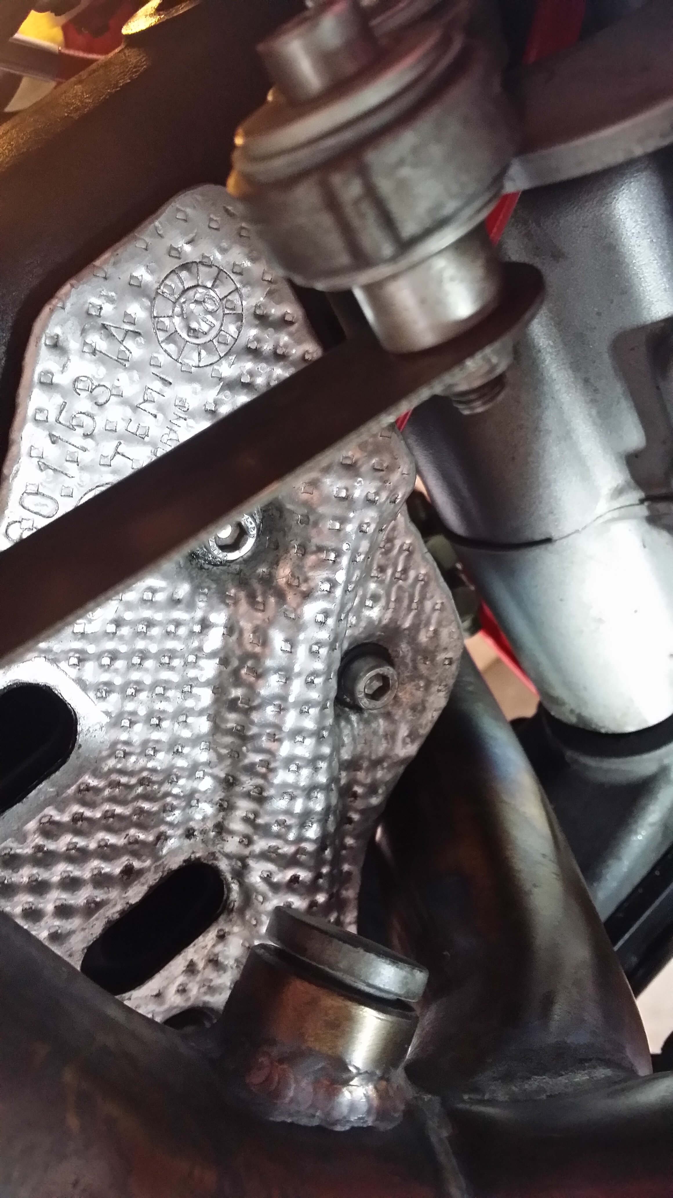

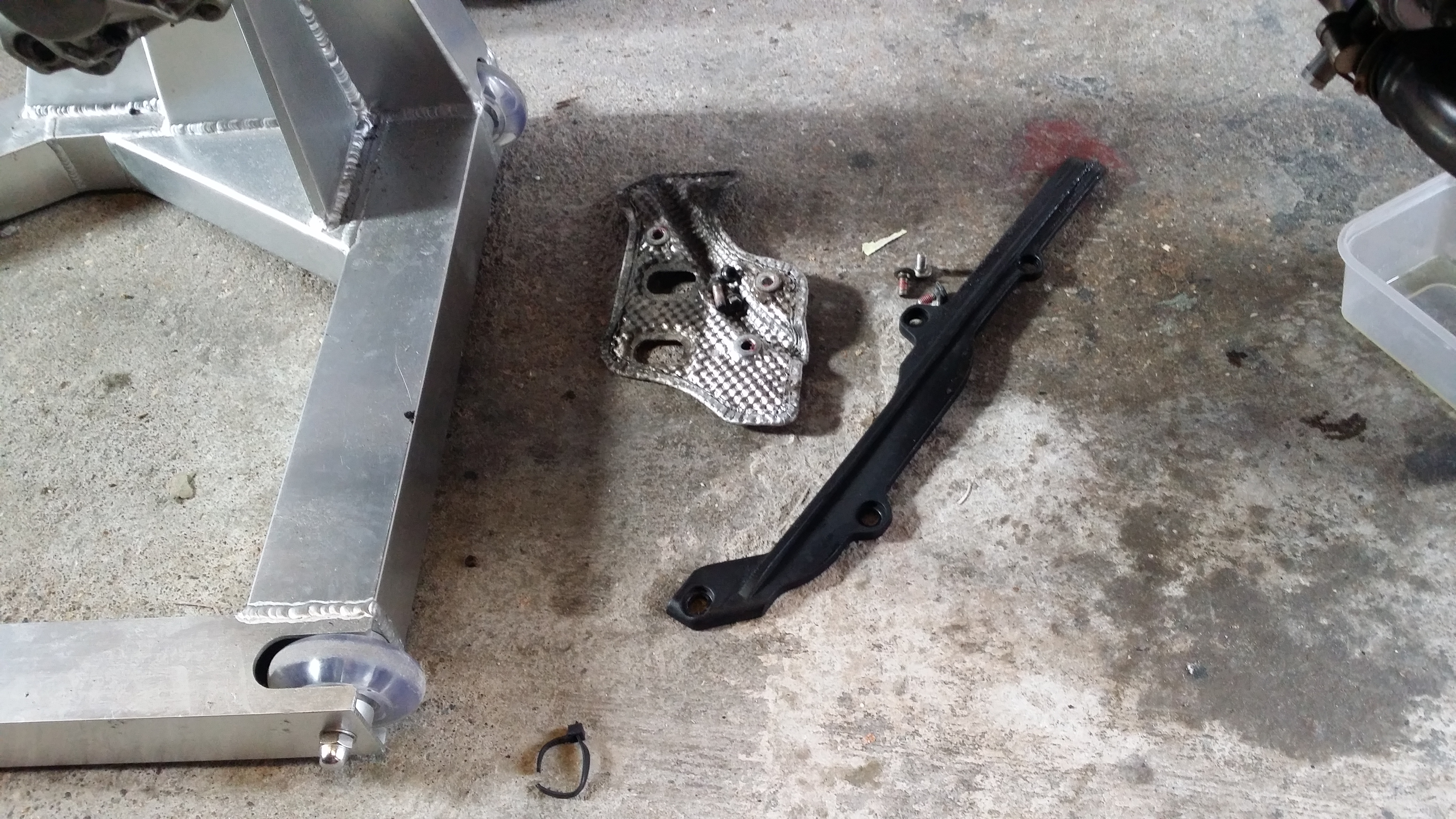

    Not a very hard job....the brake line doesn't go inside the swingarm like I thought. I runs under the heatshield and then theres a plastic guide that also holds it in place... 20140405_094918.jpg
    As per usual it was all held in place with mild steel which was corroded, all swapped out.... 20140405_094944.jpg

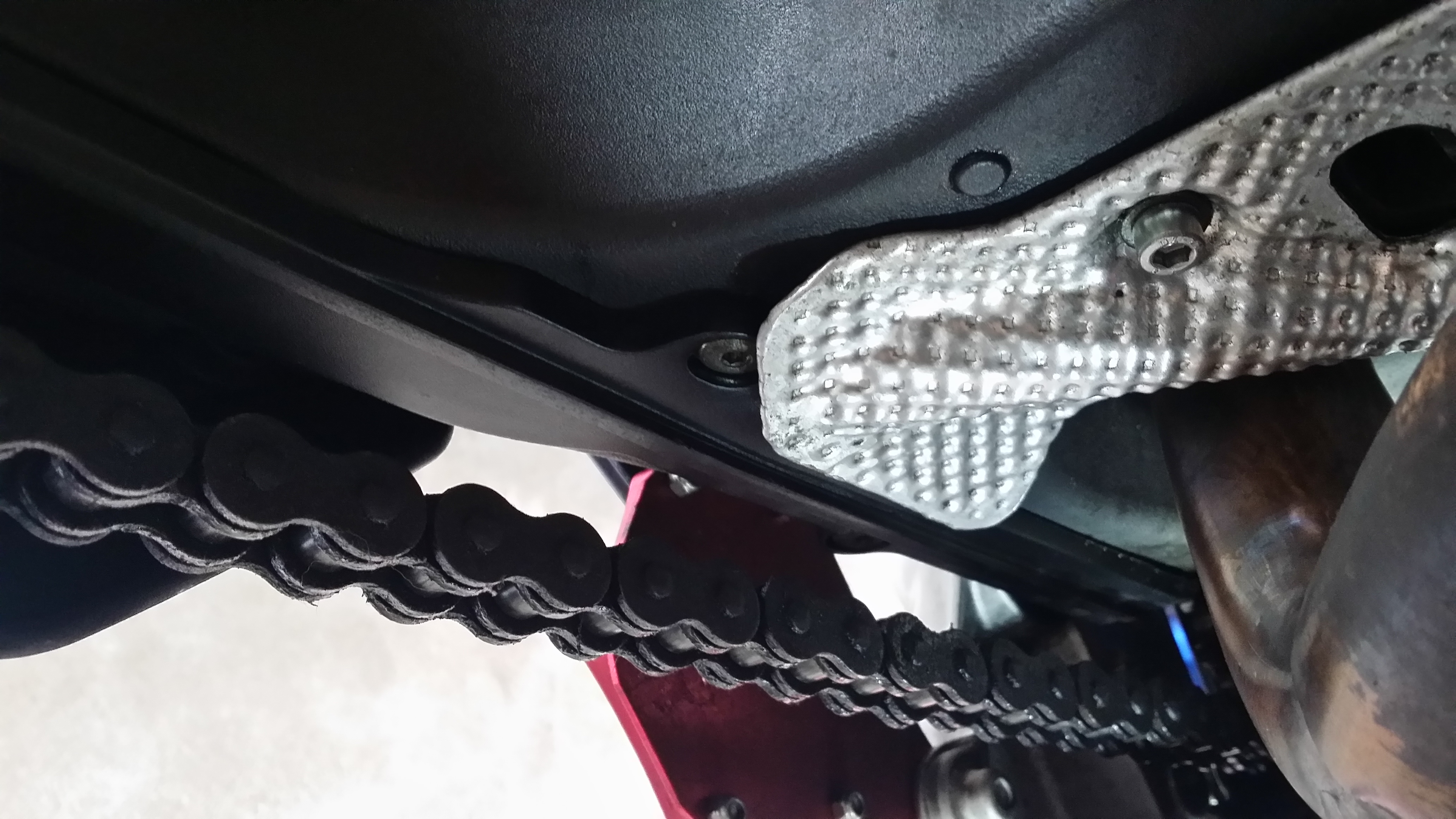

    That's the route that the brake line takes.... 20140405_102440.jpg 20140405_102456.jpg

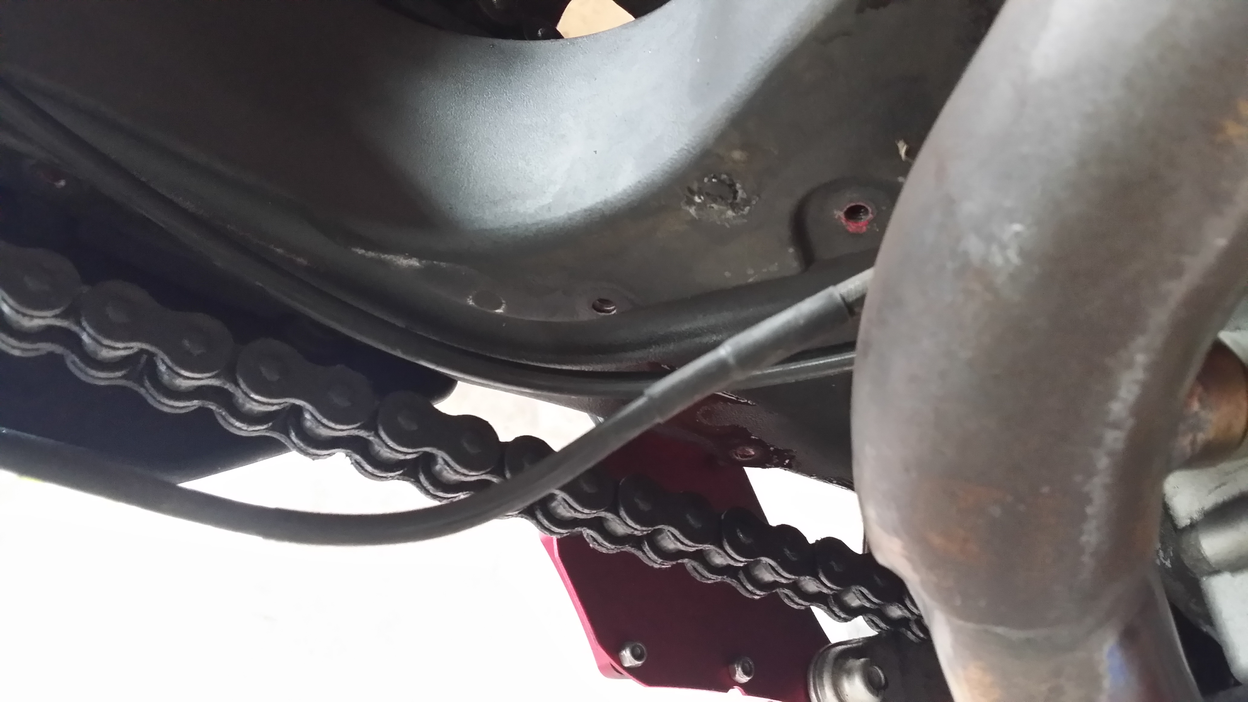

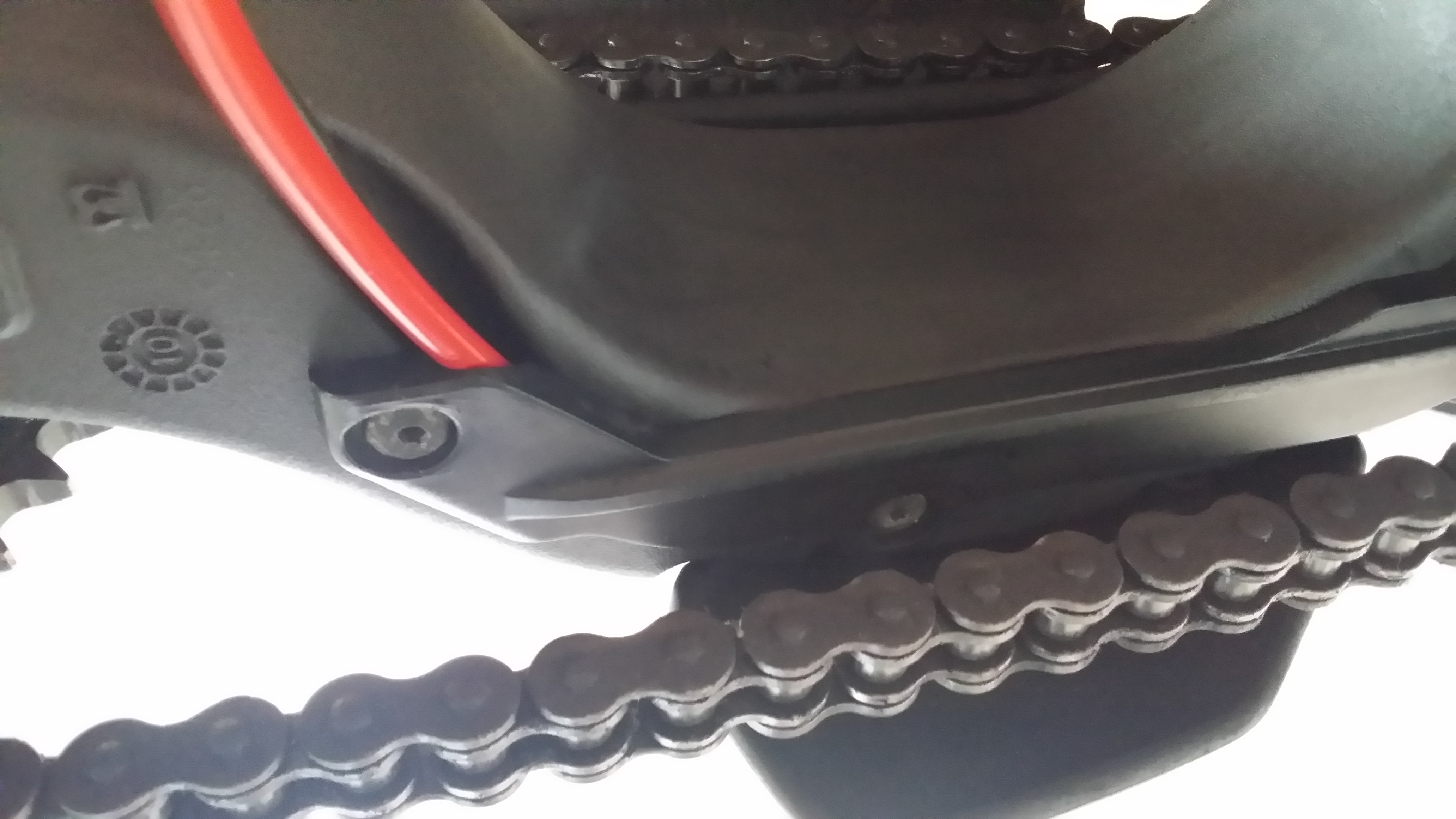

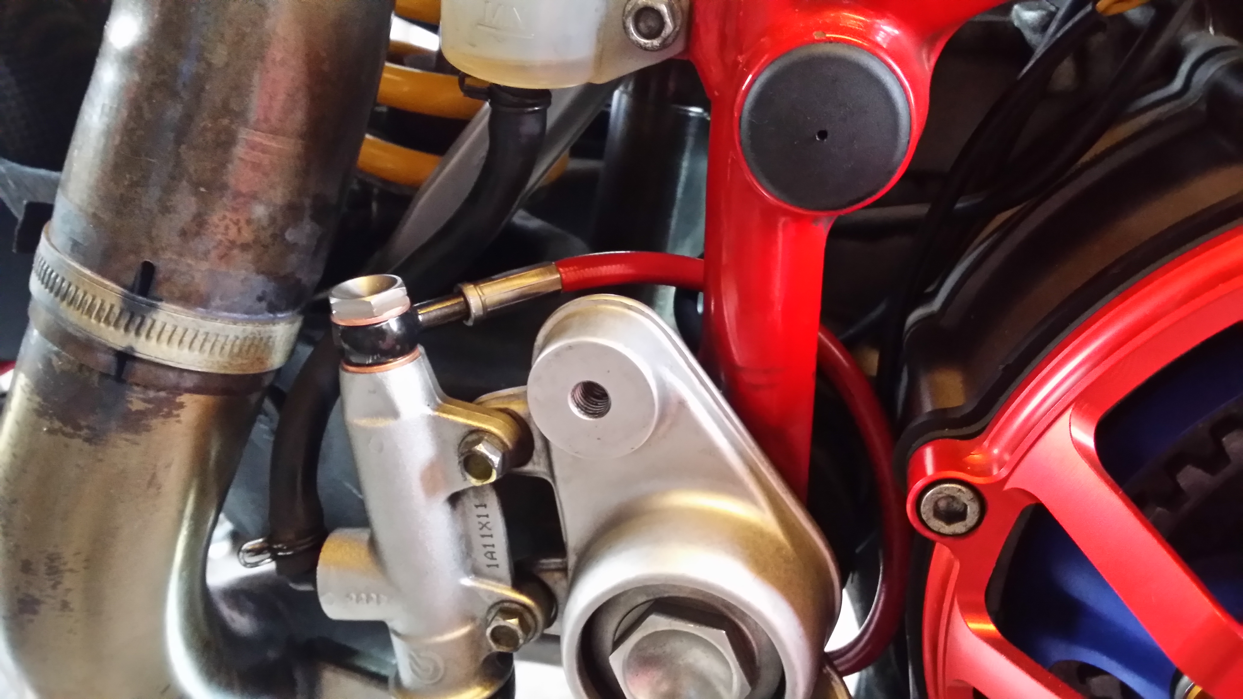

    And finally the exit - on its way to the brake caliper....another trip down to the stainless fittings shop...don't have wide head stainless bolts...
    Bleeding the caliper was a little fiddly getting the air out but otherwise fine. Thought the pics would make the post a little more interesting...

    I did the same thing on the 748 last week, which essentially has the same rear end, but the line routes over the top of the swingarm instead. I found bleeding it from empty was a real pig, and it seemed like it was never going to fill up, but it got there in the end. I did bleed it with the caliper off and higher than the mastercylinder so all the air in the line would rise upwards, which may/may not have helped!

    Yeah - it seemed like it was never going to bleed so I took the caliper off the mount and then tie wrapped it to the side of the bike but higher and then loads of air came out...easy after that...
