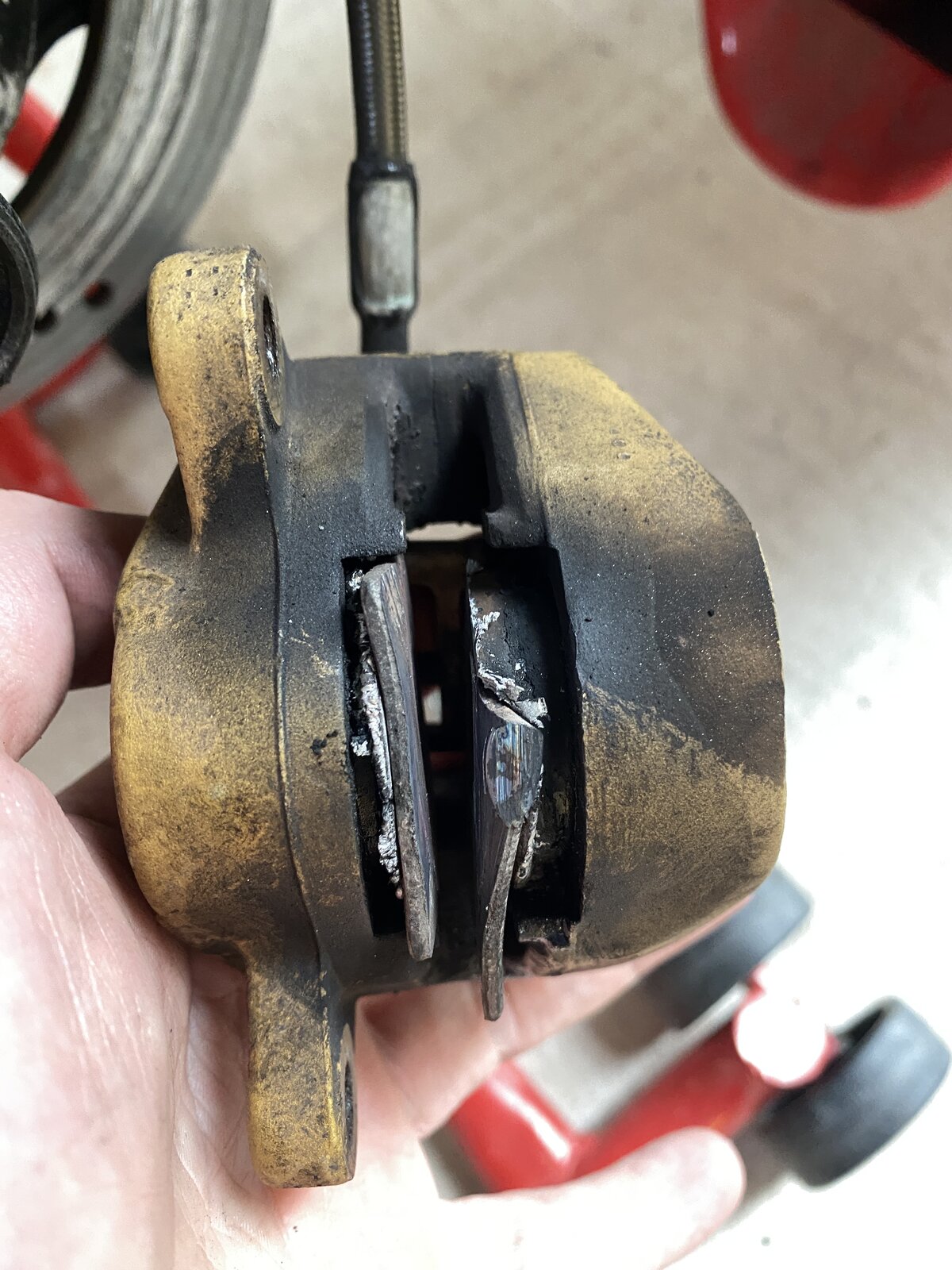

  1. On my way into Worcester today, bike seemed a bit strange, saw smoke in the mirrors. Pulled over, caliper was basically on fire.
    Once I got the bike home and pulled it apart this is what is left of the pads - two bent up pieces of metal. The pistons are toast also.
    I can’t find any rebuild kits on eBay but after the heat it experienced I’m thinking just to get another caliper.
    There’s a couple on eBay, but does anyone have a spare they can sell me?

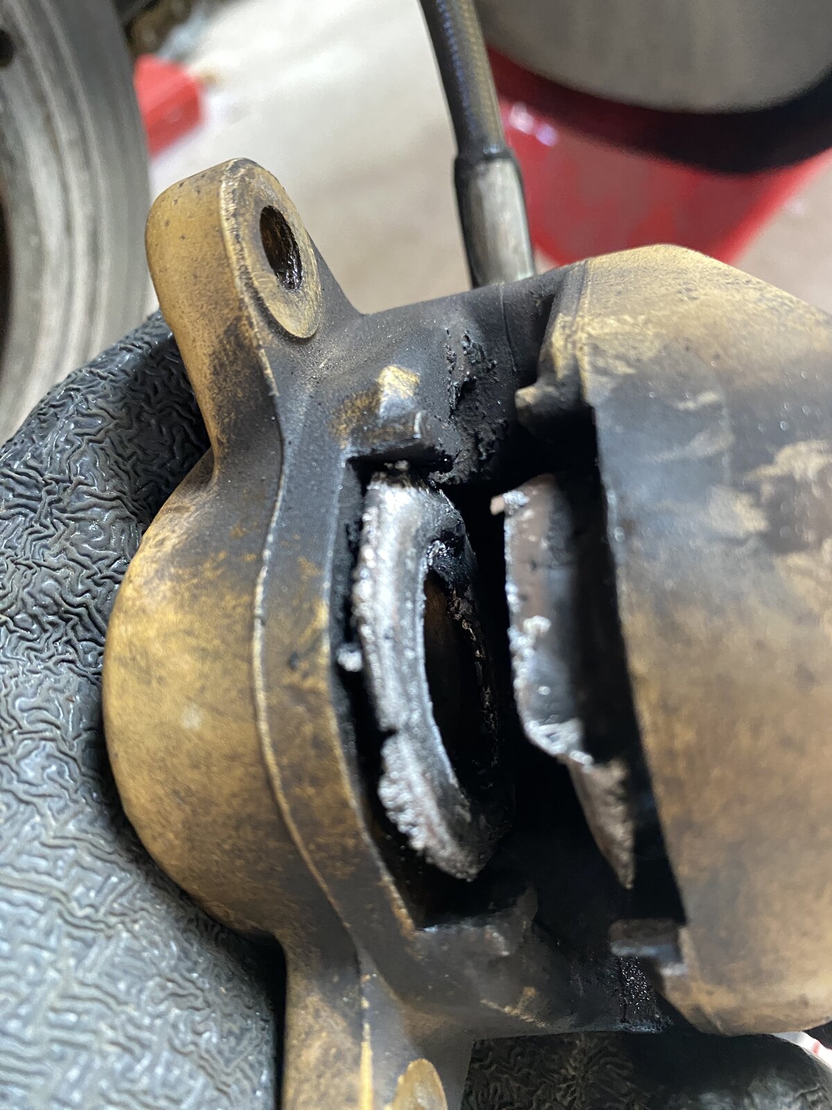

  2. Pistons:
    • WTF WTF x 1
  3. I would be checking the hub as well.
  4. The question I'd ask is: what caused this. I'd hazard a guess that the rear master cylinder is faulty and got stuck.
  5. I think I’m to blame. I fitted new rear sets and I think the brake lever pivot that holds the brake light switch, was binding which let the pads stay in contact with the disc.
  6. I did exactly the same a couple of years ago on my 749R.
    Caliper, pistons, pads and disc complete toast.
    Had just fitted rearsets and hadn't adjusted the plunger on the brake..
    Replaced the lot with second hand.
  7. not enough free play in the master cylinder pushrod is a common one on 748/916 etc, and more likely to happen on a hot day. There are several threads on here about this. :upyeah:
  8. That makes sense, I did actually adjust it to be a little bit longer...
  9. that will almost certainly be it, sorry to say. I used to find that factory spec adjustment was still not enough if ambient temperature sky-high.
  10. Yeah it was 18c in the Midlands today, bloody heatwave! :joy:
  11. I had this on my 748, bike felt slow, I stopped and looked down and the disc was white hot, didn’t have enough free play in the Master cylinder was tbe fault
  12. Had this on a track day, I got flagged down by a marshal and my caliper was on fire! Luckily rear disc was Ok but the rest was finished.
    Best to replace the rear caliper and pads and anything else, the rear brake isn't much good at the best of times but it's better than nothing at all.
