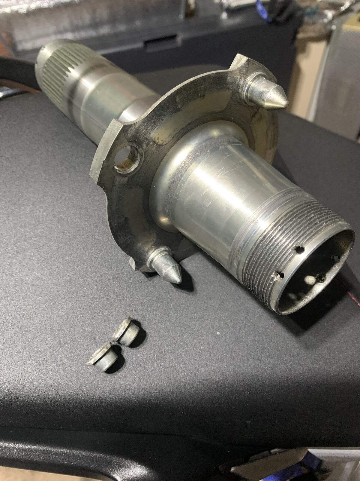

    I'm in a similar position with a 1200 MTS Drive Hub which I have as a spare. The 4 drive flange wheel locating spigots are press fitted into the spindle drive flange and theoretically they can be replaced as I've just pressed the two broken ones out that I need to replace. I can't see anything on any Ducati parts diagrams that show the spigots as replacement parts.
    Here's a pic of the one I have showing the stubs of the spigots. I might have to have some machined up by a jobbing shop in order to be able to place this spindle back into use.
    Anyone got a clue where to buy these spigots off the shelf, if at all possible ? Many thanks.

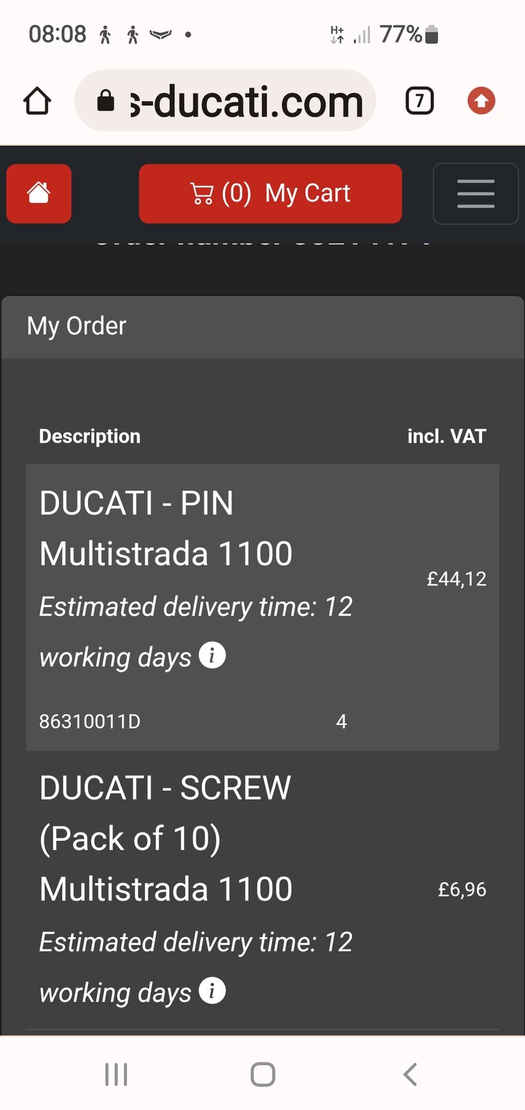

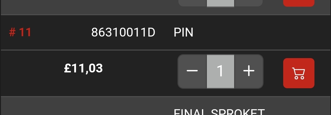

  8. Hi rich ,hopefully iv been able to order some from Ducati parts .com its a supplier in the uk.its hard to see on thete drawings but Ducati call them pins,when they arrive I'll send you a photo and better description of what to look for ,fingers crossed they should arrive soon.steve
  9. Thanks Steve. Did they give you a part number ?
  10. Yes I'll attach photo of part no.
    There not cheap for what they are.
    Remember my bike is the older model 1100ds but they might be exactly the same part.hope this helps steve.

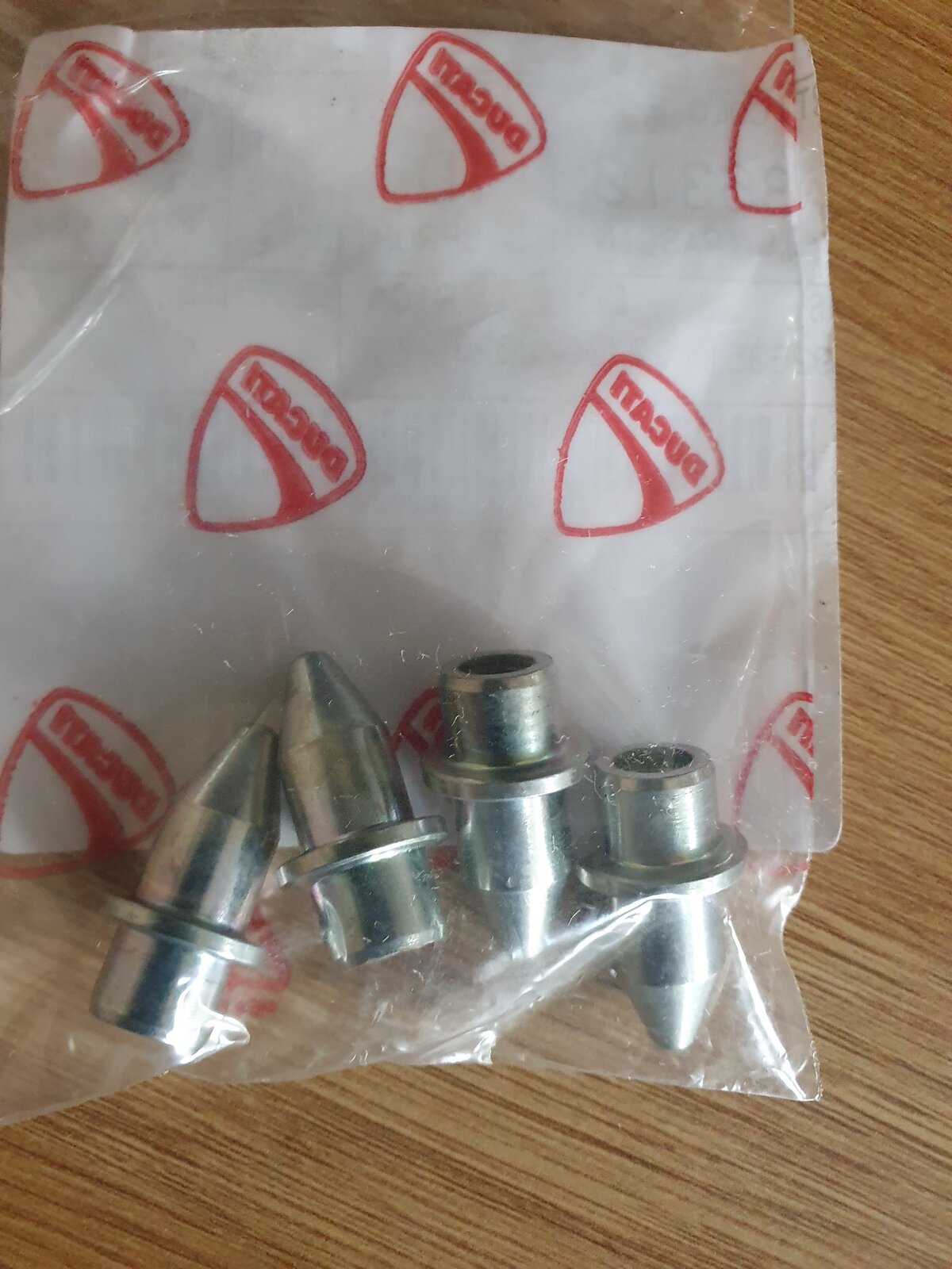

  12. Hi rich these pins arrived today so the no is right good luck with yours.steve
  13. Spot on Steve. I ordered mine using the same part number as yours. Look to be the same but worth a punt. A new spindle is £732 for the MTS 1200 so for the sake of £25 for two pins, it's worth me seeing if I can keep the old spindle active instead of writing it off. Glad you got yours sorted mate.
