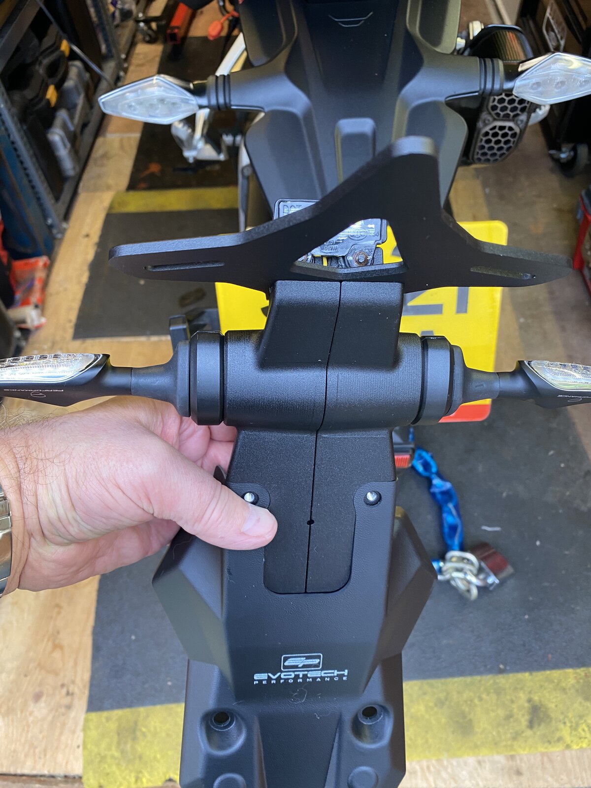

I swapped mine from my 1260 to my V4 PP, when I fitted an evotech tail tidy However the plugs were different on the V4 so I had to cut and re solder the plugs over, no big deal That maybe the reason they are no longer listed as they have changed the plugs Hope that’s of use

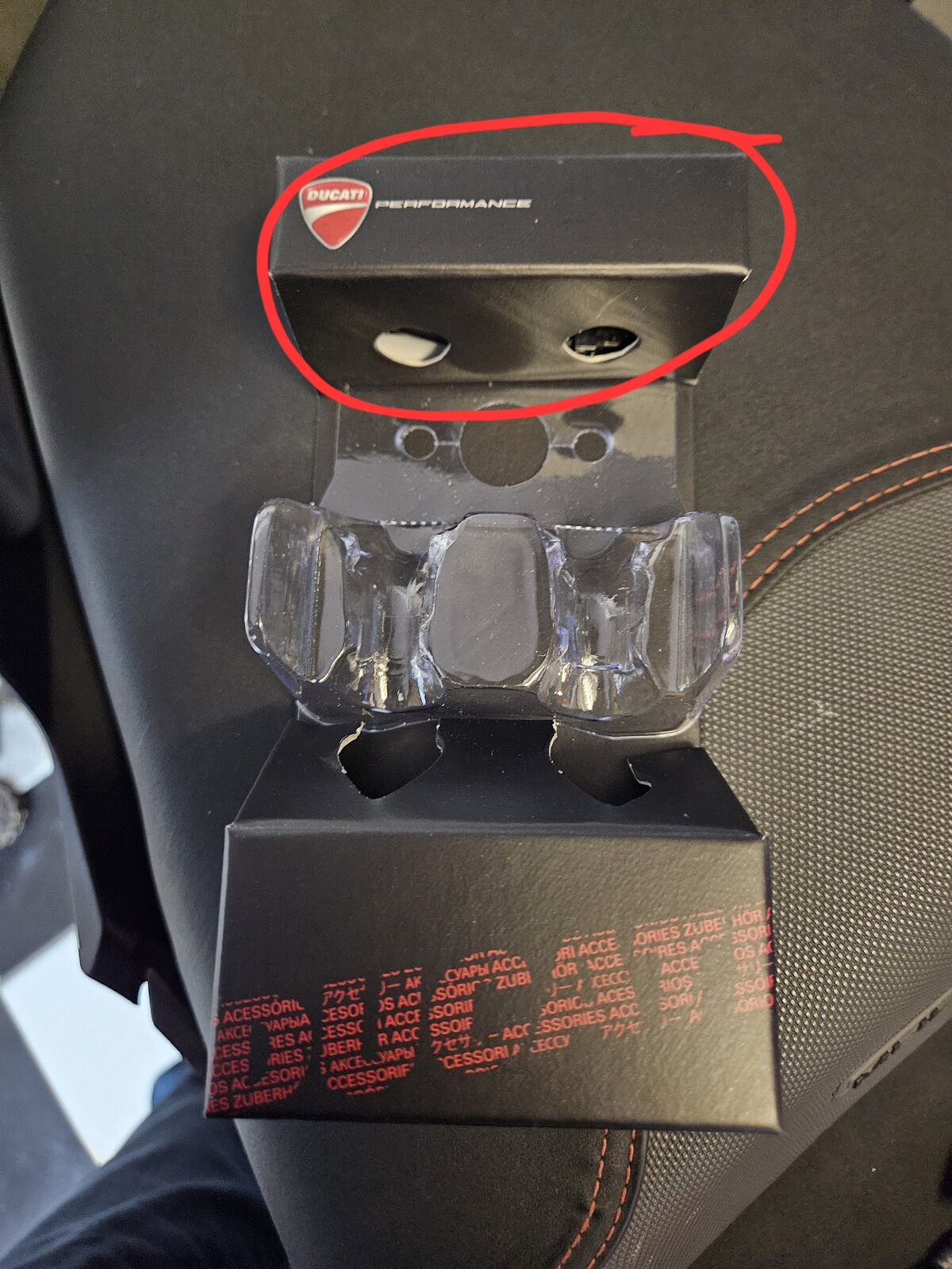

Well I just went to for mine: Part number 96680971BA And they don’t fit. The plug on the indicator is much bigger than the one on the bike, I wonder if you can get an adaptor ? I don’t fancy splicing and rewiring them

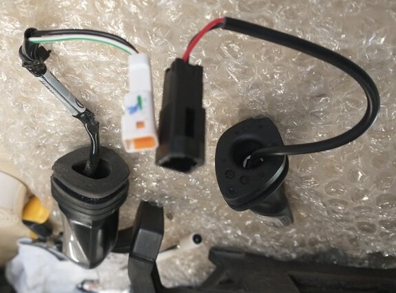

I've got the same problem, connector on the dynamic indicator is different from the one on the standard indicator - 2 pins the same but much larger shell: There were no adapter leads or instructions in the box. @Oly - did you resolve this problem?
This. The indicators I received came with the adapters. Something amiss with your purchase or they (Ducati parts) have decided to stop adding them…?
And they were @Mark H & @kartman - Many thanks. Now I have to send a second email to the supplier asking them to ignore my first one
