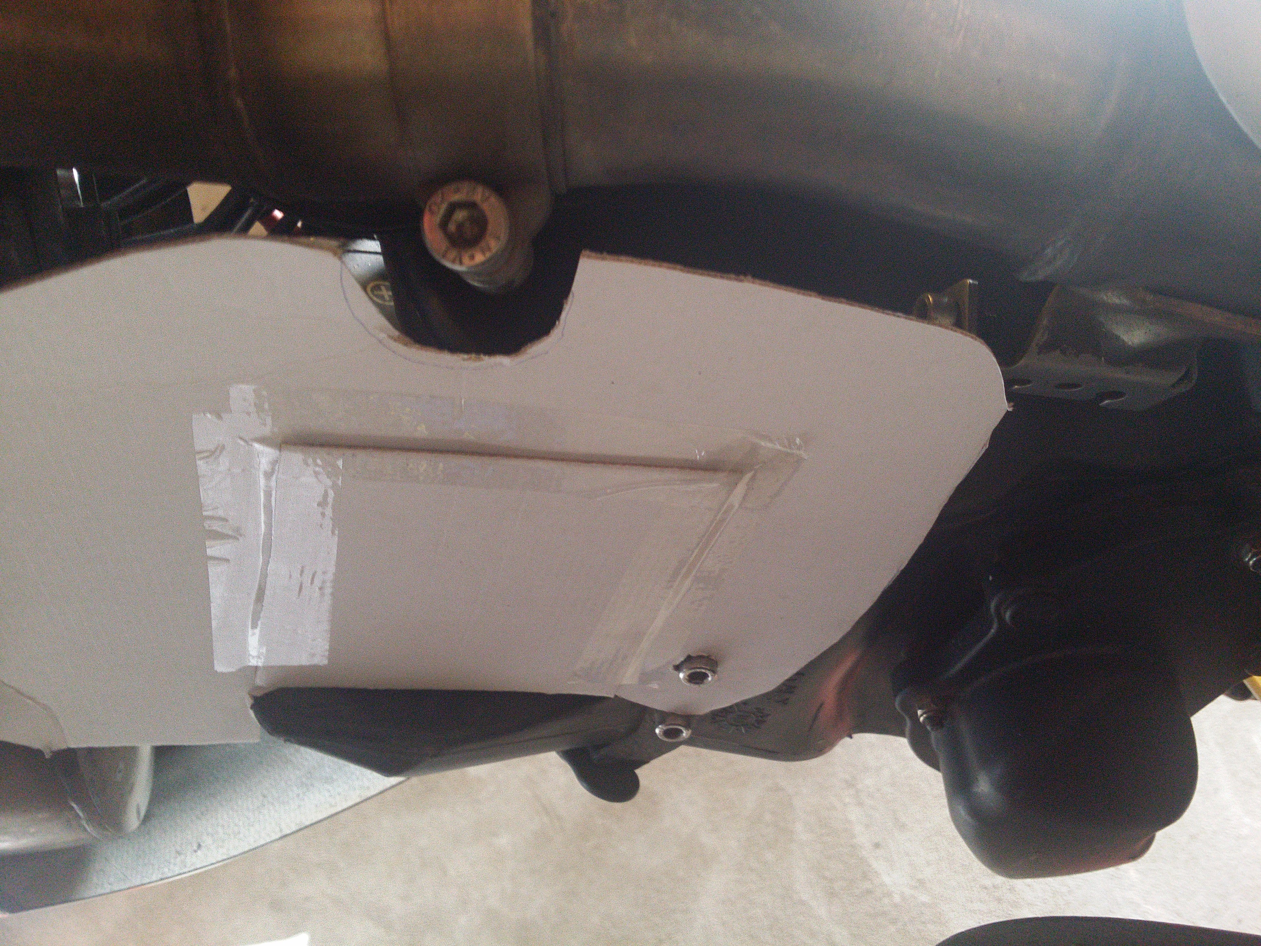

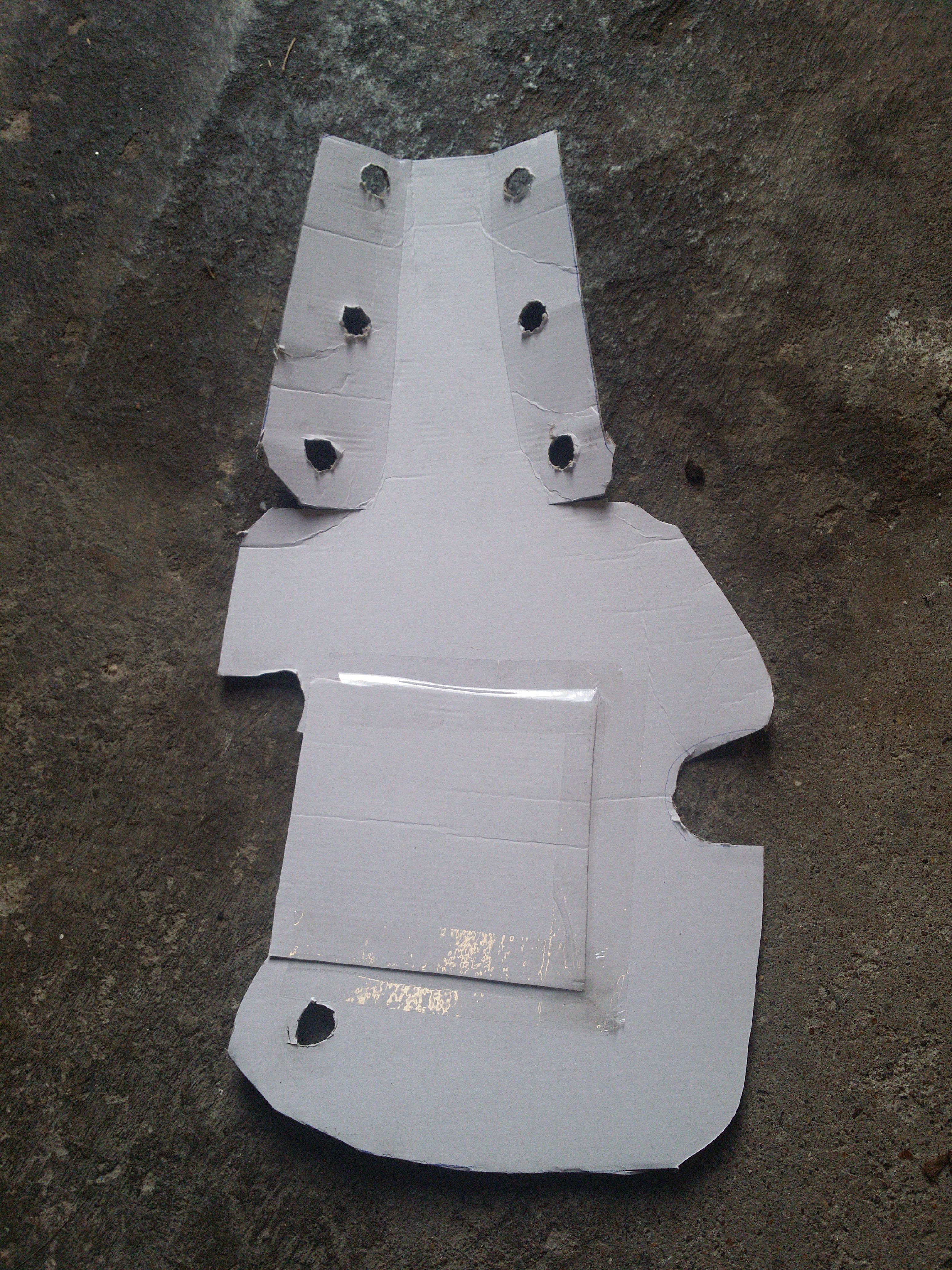

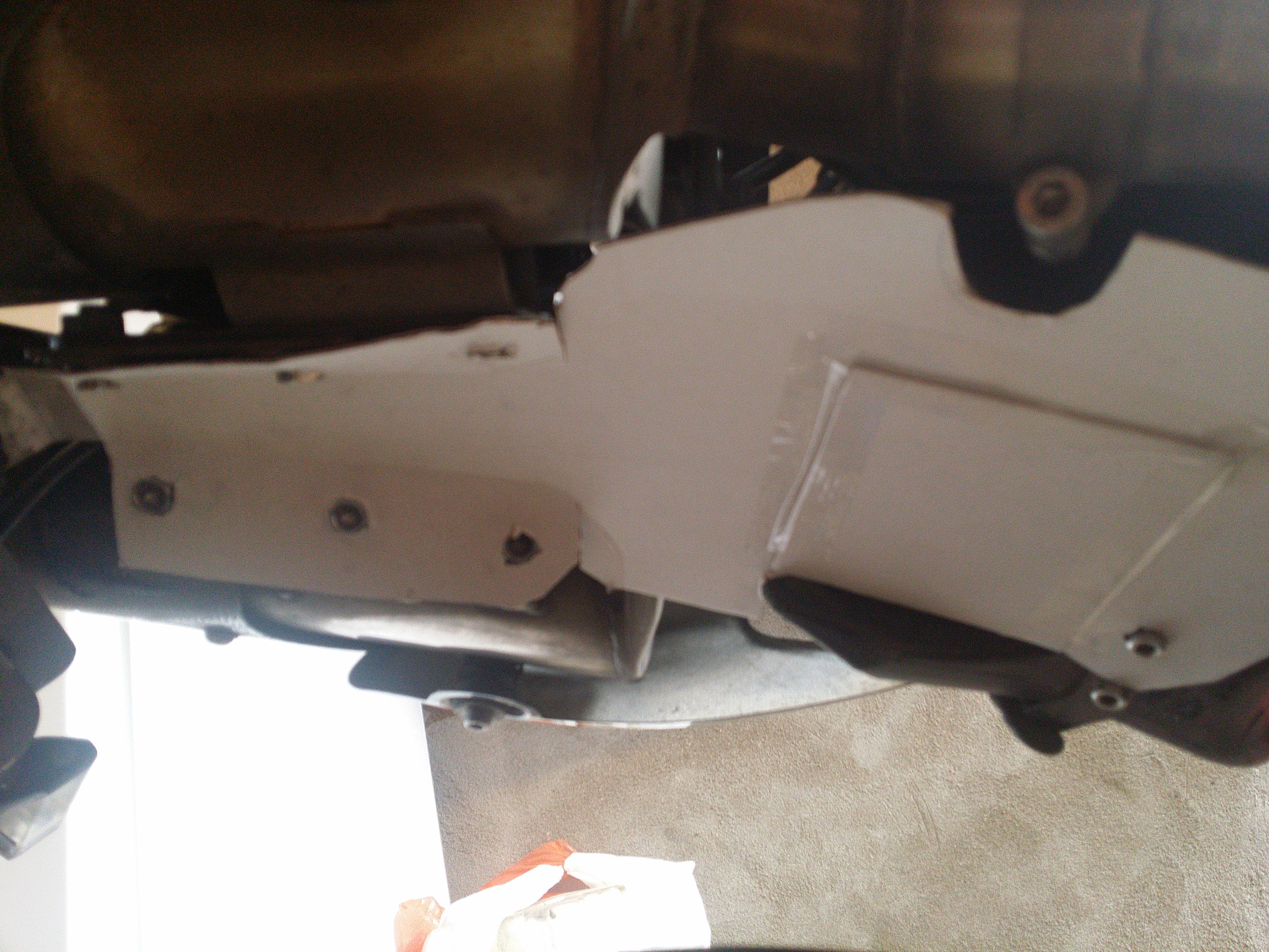

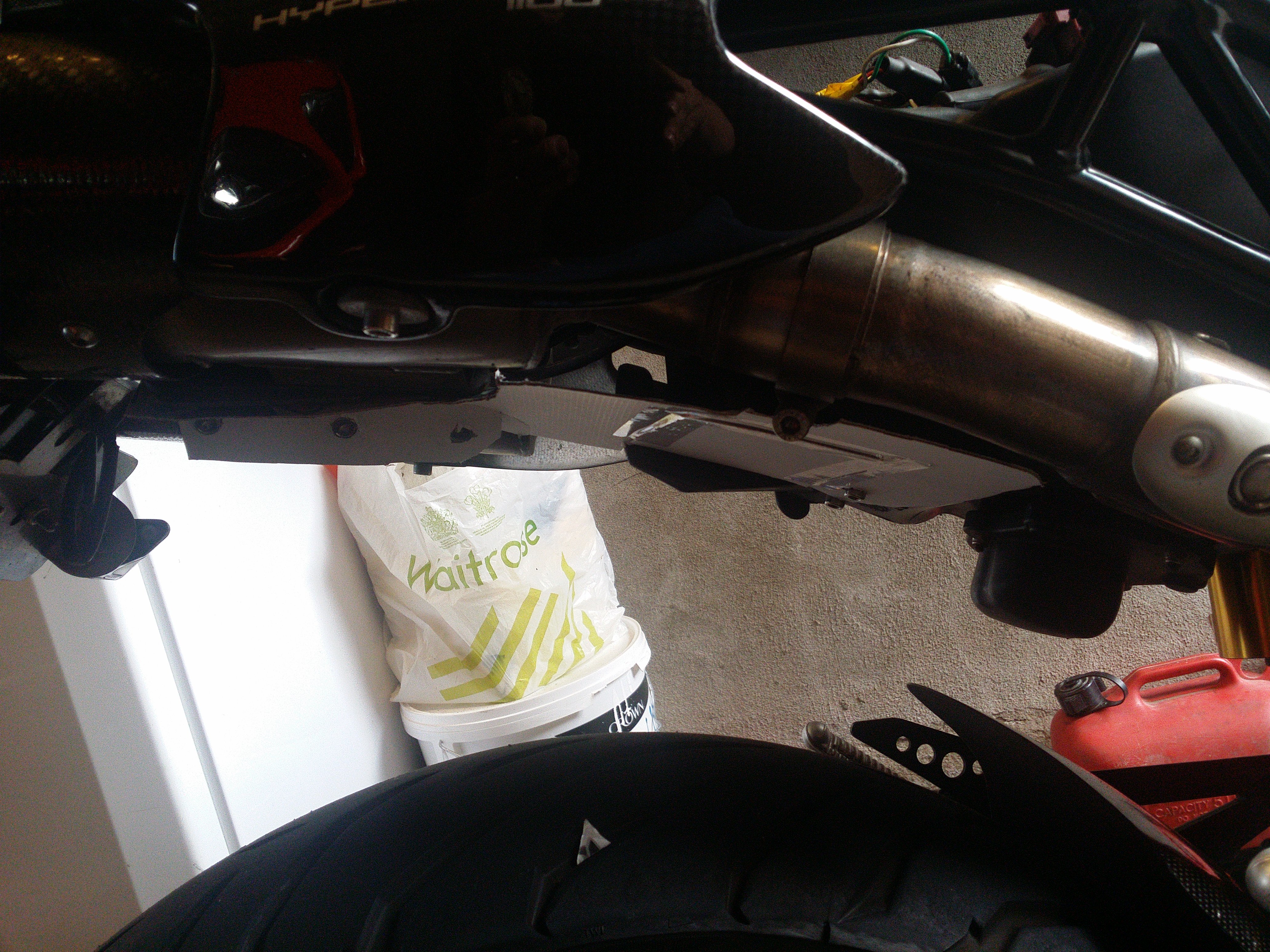

  15. Just to let you know I haven't forgotten about this, in fact, ive got a mock up ready to drop off to them tomorrow morning first thing. I had a quick meeting with the design lad and he pointed out that my idea for hinging the mudguard from the rear exhaust hanger/tailtidy mount point wouldn't be enough so ive extended my design down to the point where the 2 bolts are that hold the battery strap - meaning that at high speed (going forward) there will be wind resistance trying to push the mudguard down without that mount point. So, theres 6 mount points at the top and one at the bottom. Im hoping to have a stainless steel test piece by Friday...
  16. Thought id put these up (just so you know something is happening....) essentially the mount point is the same place as the tail tidy and round the wheel further down one of the mount points for the bar that holds the battery strap. As I said before the fabricator was concerned that the force of wind at high speed would push the mudguard down into the wheel so it anchor's there (you can just make it out) it means it can be removed from underneath only... IMG_20140727_195510.jpg IMG_20140727_195537.jpg
    The taped back on bit is where I got a bit too overzealous with the scalpel....is everyone happy with that design. I think ive covered more than the stock one does. Once Theres a final design I think ive got enough in the kitty to get 10 made and ill also get them powder coated black then they wont stick out like a sore thumb...the whole idea is that it wont be seen....is everyone happy with that??
