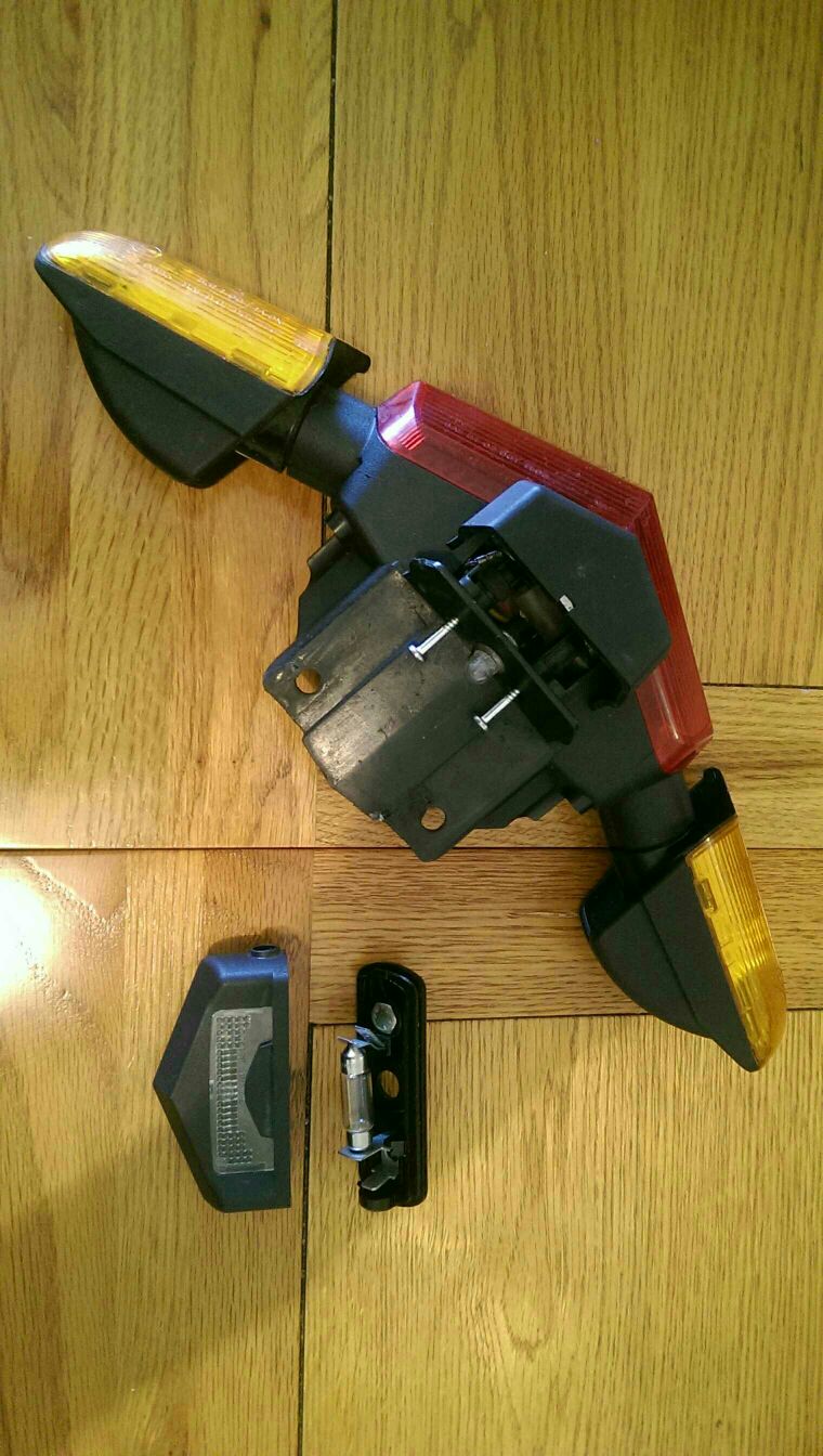

    Bike came set up as on left, but also got the (I assume) number plate light separate. Can't figure how it should fit. Looked at parts list but still no clue.
    Is one for a BP and one a mono? Or early and late model?
    Thanks
  2. You're missing a pressed metal bracket (and an o-ring ;))
  3. but I have a bulb which i assumed was the number plate bulb already sticking out the back. Whats that for then?
  4. Early models have a remote license plate light.
    • Useful Useful x 2
  5. I have an early model but i'm guessing it got adapted (butchered) after the previous owner snapped the bolt from the underside of the exhaust which holds the large silver/grey bracket.
