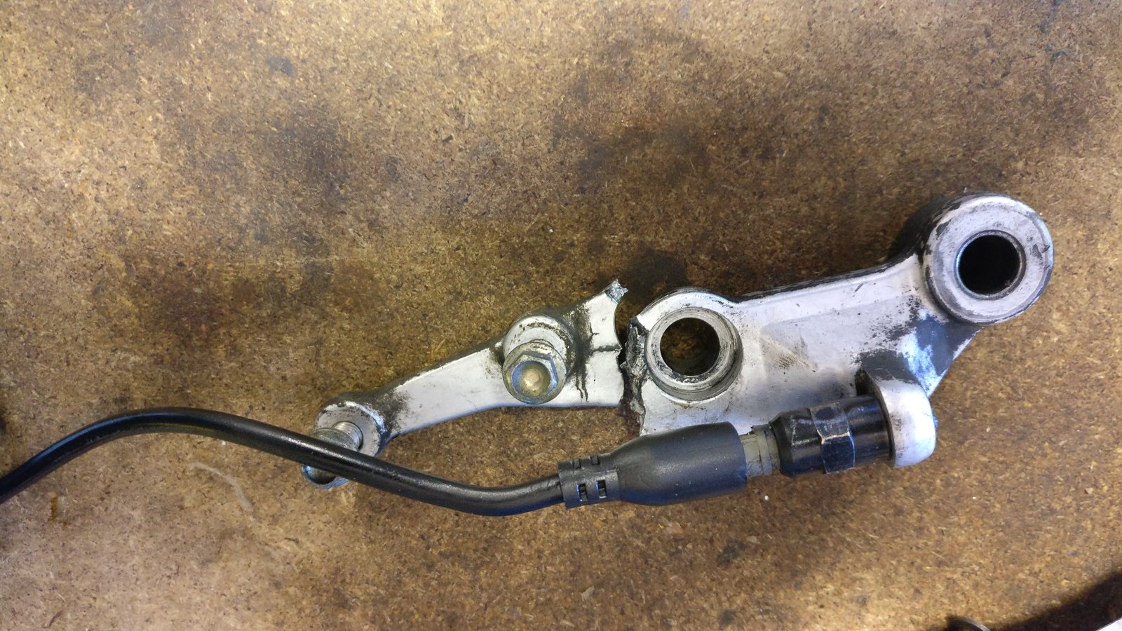

  1. Managed to break the bracket while attempting to undo 748 wheel nut, dammit. Switch doesn't want to separate from the broken bracket, so I'm looking to replace both. Used spares anyone? Bracket is #82910781A, dunno what the switch is (apart from being made of soft brass). And we're promised more decent weather next week and I've a new Metzeler that needs some spanking.

  3. You are right about the soft brass body of those switches, it’s a joke isn’t it? As that bracket is wrecked then you could carefully hacksaw down the threaded part that the switch goes into, in two places if necessary to weaken it before trying to remove again.

  5. As the switch is 20 years old, I thought it might be sensible to replace it anyway. Russ said you can sometimes undo it by grinding a slot out of 11mm ring spanner...

  8. Looking at that bracket, it may have been fractured for some time , it doesn't look like a fresh break.
