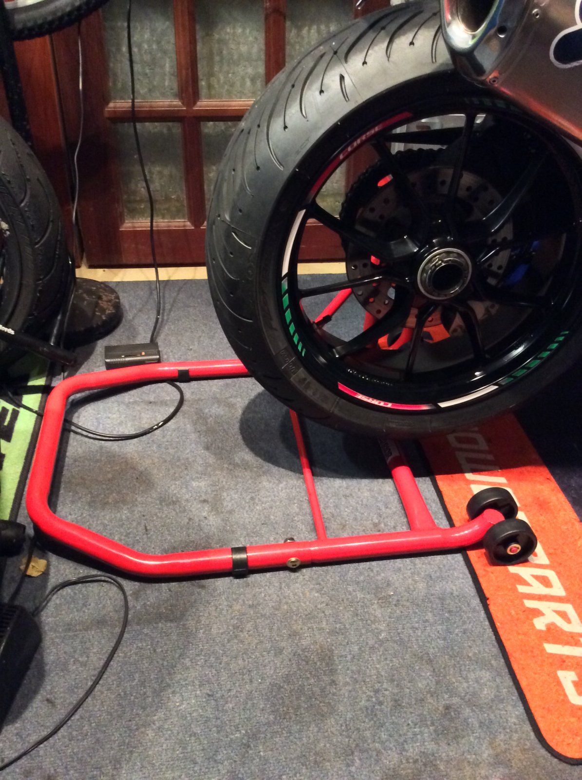

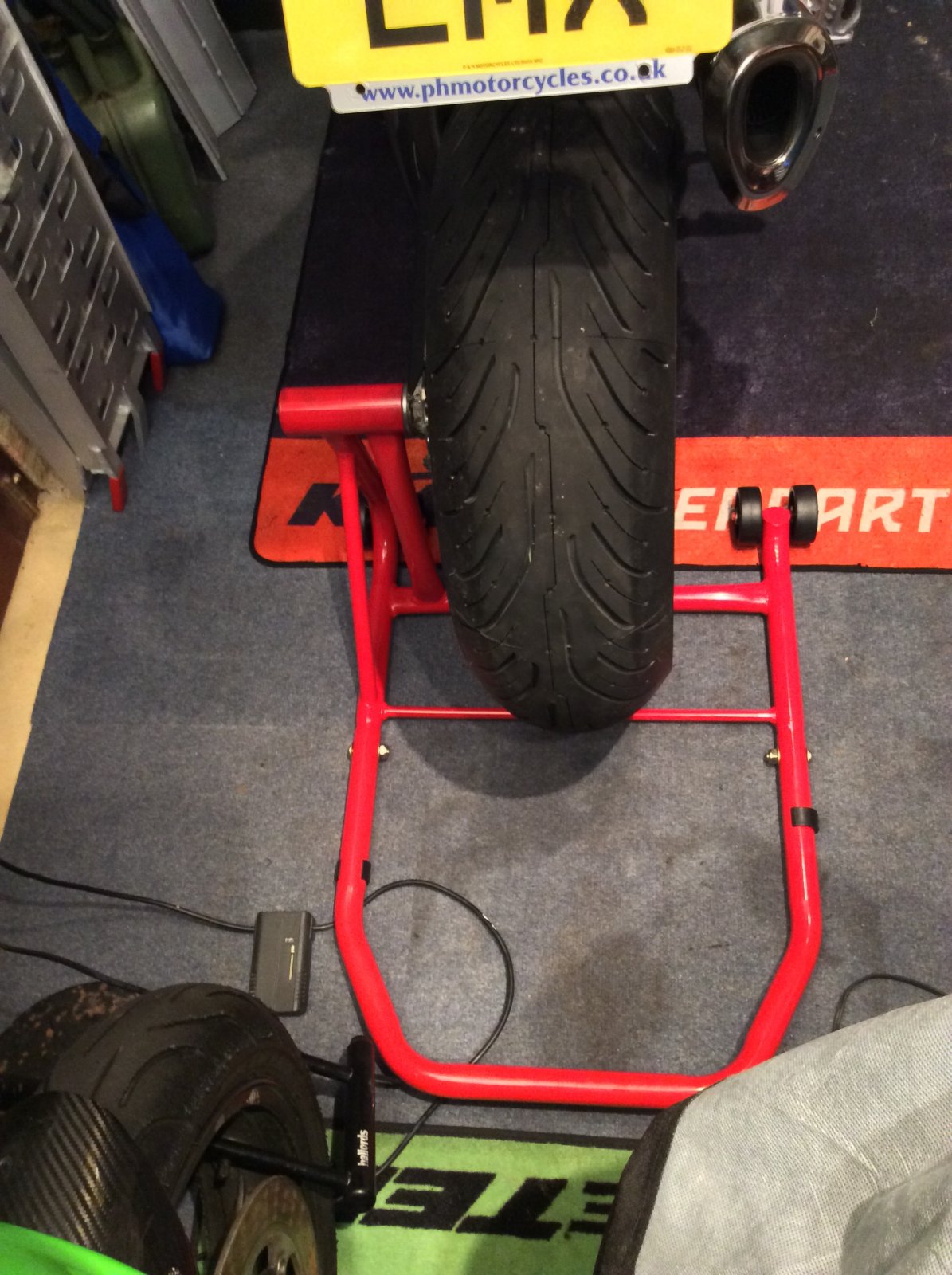

  5. I had a Warrior stand delivered from eBay a couple days ago and it's as solid as my KTM ones which cost the earth like the Ducati ones. I didn't expect it to be anywhere near as strong as it is, no flex and spindle fits perfectly with two sealed bearings. I've even had rear wheel spinning it in and no movement or flex...
  6. Pics...
  7. Sounds like the Demon Tweeks sale price of £35 is a bargain. Andy
