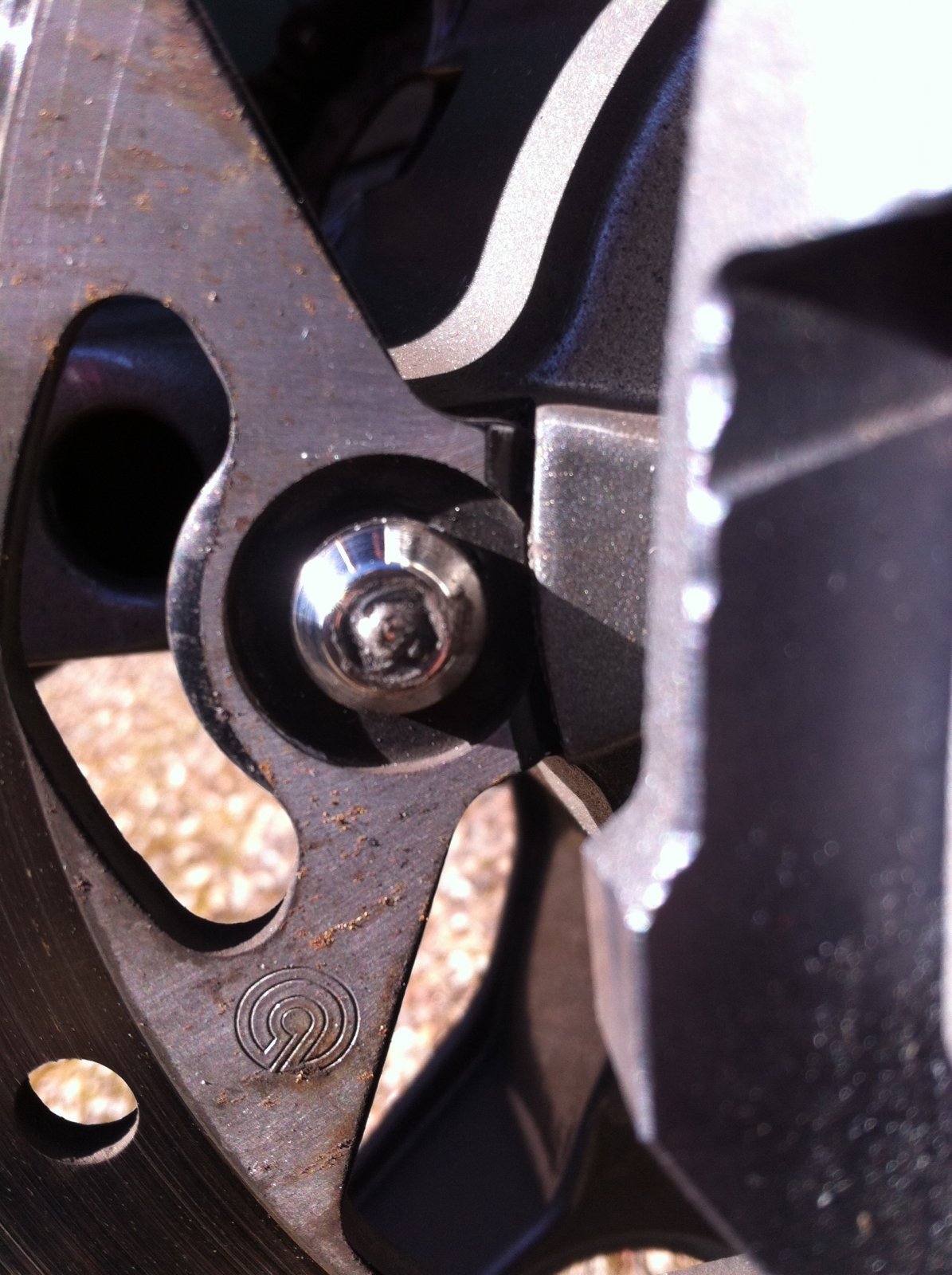

    I think these titanium socket-head bolts are by Racebolt.
    As you can see, I have just placed steel ball-bearings in the socket for the allen-key and embedded them in clear silicone.
    The ball-bearings provide enough of a magnetic signal for the speedo to work and to stop the engine-light from coming on.
