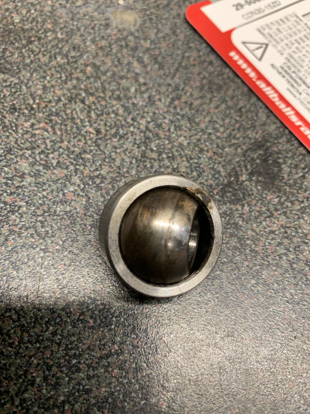

  8. The last picture shows the old top bearing the hardening has gone and you can move the centre an appreciable amount by hand so it’s no wonder you can feel it when magnified by the swing arm
    Excellent result all round virtual beers on me :beer::party:

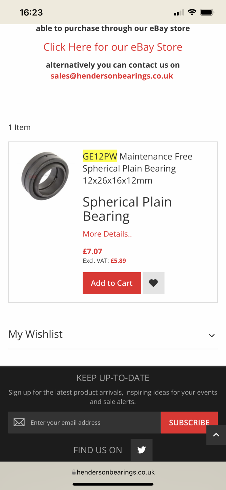

  18. Above picture of Henderson bearings in the UK
    PART GE12PW Sherical bearing only for £7.07 each
    If you can re use the top hats and felt seals you only need the bearing itself free postage as well
