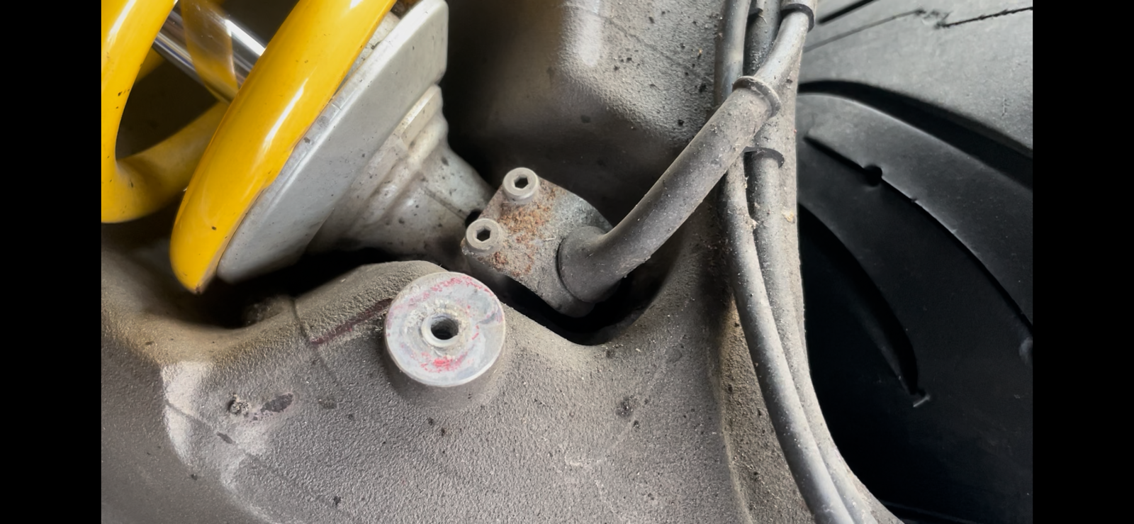

  1. Just taking the rear shock off and have noticed there is some play where it it connects to the swingarm. Not got it completely out yet but would be surprised if this is normal.
  2. I replaced mine not so long ago, there is a thread all about it with part no’s where to obtain them and how to do it
    Take me about 5 mins an end now to change them… bit longer to get the shock out tho

  4. You can’t get the parts from Ducati… new shock only which is silly
    I originally used an AllBalls kit but then found the bearing available for a couple of pounds from the UK
    You reuse your top hat spacers, makes it a cheap and easy repair
    The bearing is a GE12 PW
    Henderson’s bearings stock them
