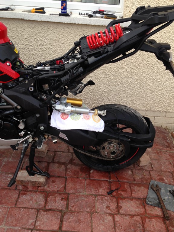

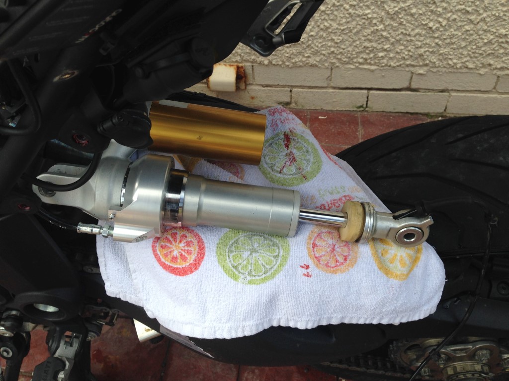

  11. Well got word last night that my spring is ready to be picked up, So I'm popping down to Preston to get it tonight. then tomorrow I'm going to see if I can fit it my self.
    I know you probably haven't, but has anyone on here ever taken the spring off a Sachs rear shock?

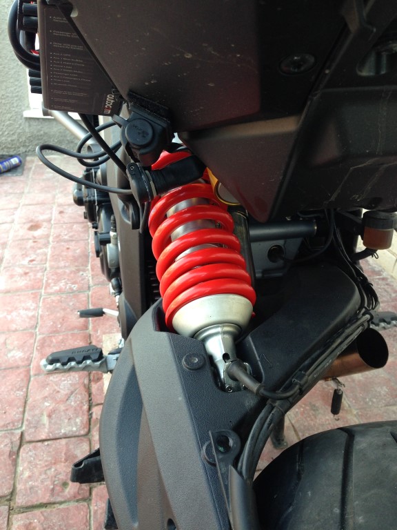

  12. Well I picked up my spring last night from TW Suspension Tech, North West's Motorcycle Suspension Set-Up & Tuning
    I have to say what an awesome job he made of it. it's a 3 stage spring designed for my weight, with pillion, and with luggage.
    I've spent the morning fitting it, what a pig the bottom shock bolt was to get out. I ended up making an extended Allen key from an old Facom Allen key and pouring gallons of hot water over my swinging arm to try to soften the lock tight. Finally after twisting the Allen key so it looks like a cough candy it broke the bolt free.
    Then another half hour unthreading the lower rebound / compression cable and it was free.
