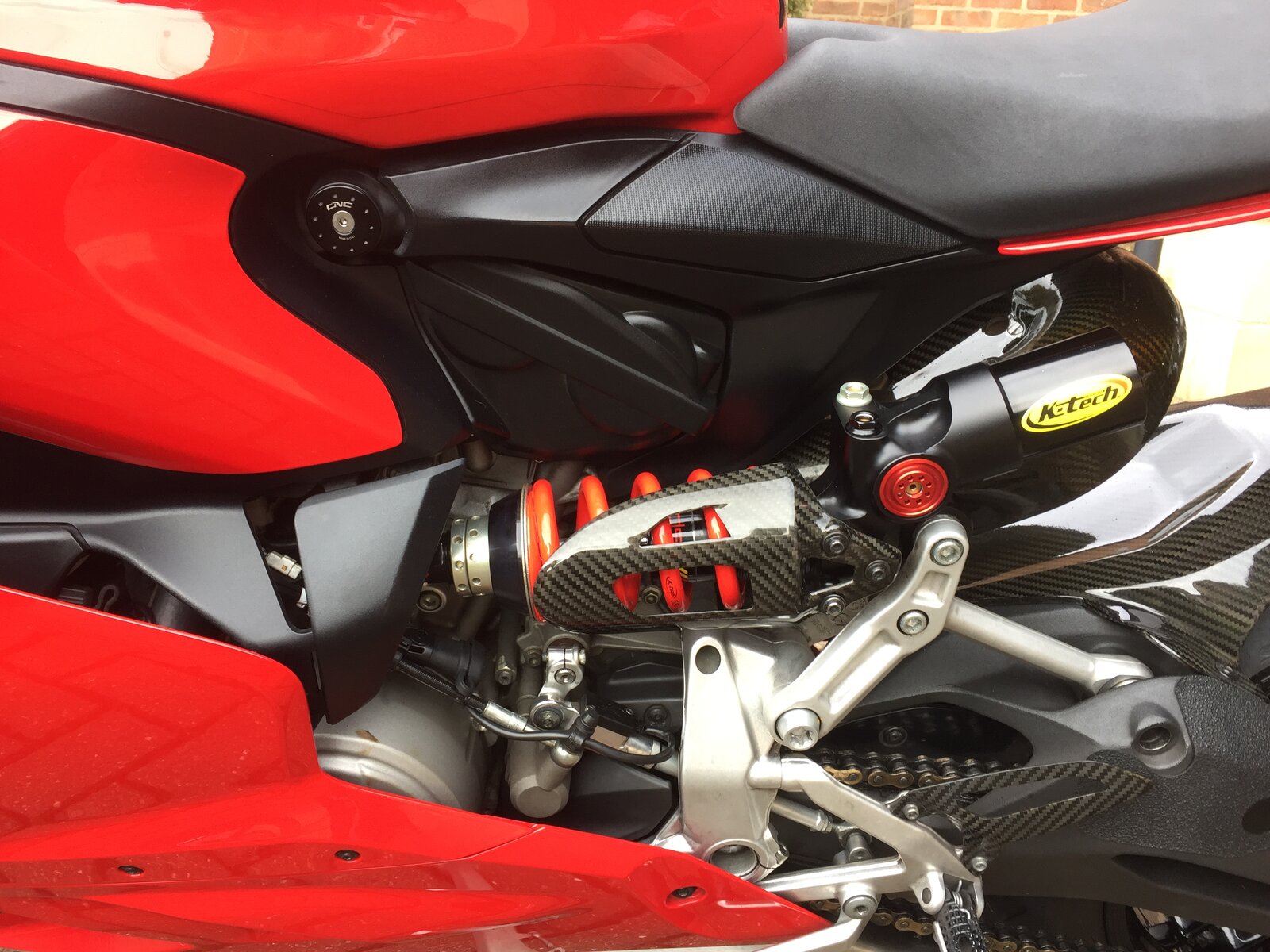

  8. I’ve ran ktech for many years on many on my race bikes... but this year trying Mupo! Oh and what a bit of kit these are!
    So much more compliant, highly recommended!
