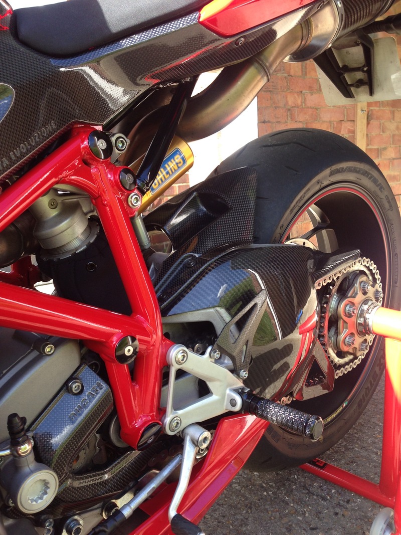

  1. I've recently put a 14tooth front sprocket on and I'm looking to replace the chain/rear sprocket, having not bought a chain/sprocket before I was looking for a little advice. The bike currently has this on it....
    Does that mean I can get a renthal quick replacement? Also what would people recommend, I wouldn't mind a slightly bling setup without breaking the bank.

  2. Im new to ducati but that looks like a standard sprocket to me, you'd need a quick release carrier as well.
