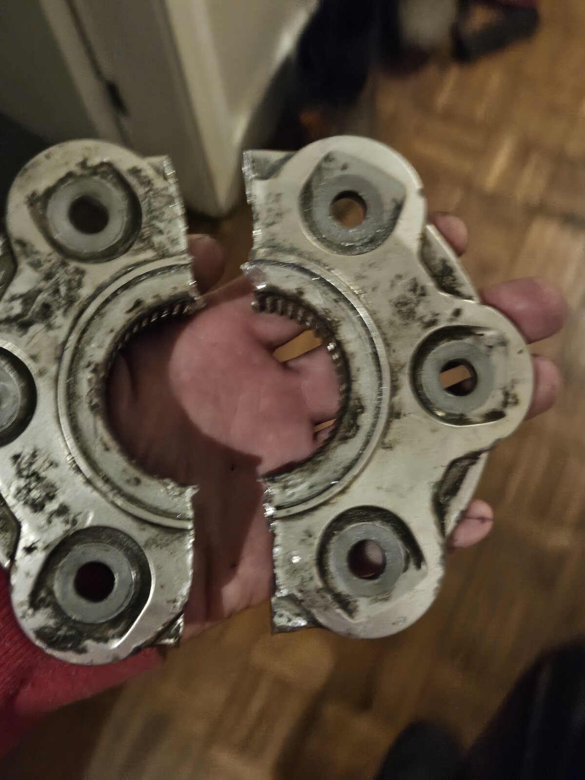

  1. I'm changing the chain and sprockets but the sprocket cover is seized on to the axle. Ive tried hammer and wood, mallet, WD40 and three legged puller (it snapped a leg on the puller). I'm thinking I may have to cut it off with a dremmel and get a new one? Any one have any ideas or experience of this.

  2. Got a picture of the offending item?
    • Funny Funny x 7
  3. Not sure which part you mean but try some heat on it
    This bit. No grease or anti seize what so ever in it!!
    • WTF WTF x 1
  5. Well, at least you got it off - just need to source a new one now!
  6. Local breakers had a (greased) one in stock quite cheap.

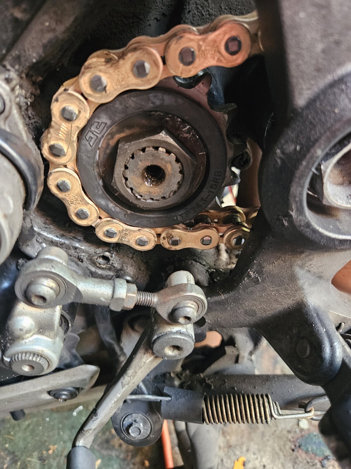

  7. The new front sprocket has rubber deadening on it which makes it impossible to get anything under the lock washer to bend it up. Any ideas?
  8. You could put a small lip on to before fitting to give you something to work with once it is on.
  9. You just don’t won’t to be shy about using the rubber as lever with a screwdriver . Once you have lifted the edge it will be easy to tap the blade in to lift it more.
  10. This, I put a rubber front on my last 1260, it was a PITA to get the washer bent over the bolt. In the end, I gave it a little lip before placing it on the spindle and bobs your uncle, job done.
    As for the sprocket carrier (which is the part you chopped in half), I don't doubt it was seized however for those peering into this thread with the same issue - Let it soak overnight with some anti seize or similar, don't just try to pull, but instead put some bar (I used threaded bolts) through the flanges and give them some love taps forward and backwards with a rubber mallet.
    Doing so will likely break any points that are seized and it should slide off. If not, chop away!
