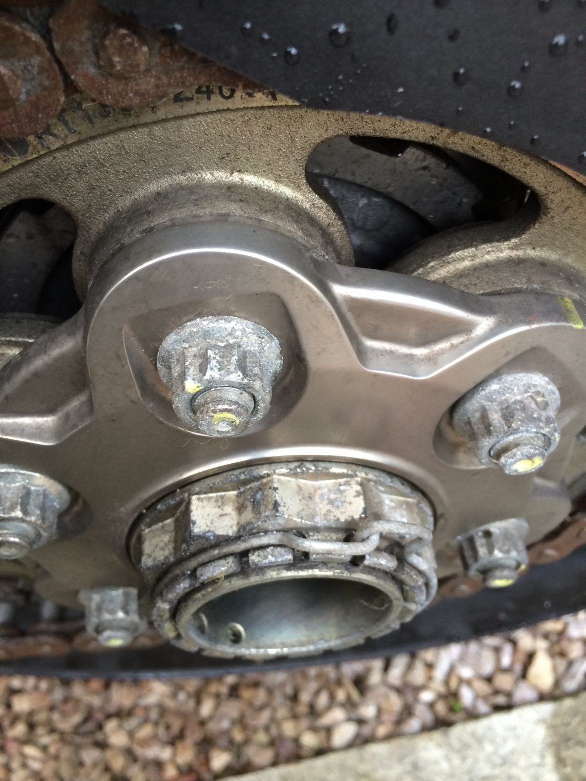

  1. Can anyone advise what size the nuts are on the rear sprocket?

  3. Thanks it's not the wheel nut it's the ones on the sprocket. They've corroded so planning on taking them off and the wheel nuts and getting zinc coated or similar.
  4. I think they're M10 x 1.25mm

  5. Nuts are super fine pitch
    74810461A NUT, FLANGE M10X1. I would suggest stainless or Ti equivalent.
  6. Air con. Ha thought I was being thick. I couldn't understand what you were getting at.
    Does m10 mean they are 10mm and require a 10mm bi-hex socket to remove.?
  7. No...it means they are 10mm diameter thread, so thats a 14mm 12 point socket...make sure it's a good fit.

  9. I'm not sure but I think these are the fine pitch of 1mm not 1.25mm please can someone else confirm?
  10. Yes , they are M10x1
  11. Well that'll teach me for guessing - instead of looking in the manual! Doh!

  15. Royalwkthcream tell me about it had loads of issues with corrosion on the bike. The bike is awesom but corrosion and associated breakdowns have spoilt it really.
    So to make sure I'm clear I need m10x1 which is a 1mm fine thread?
