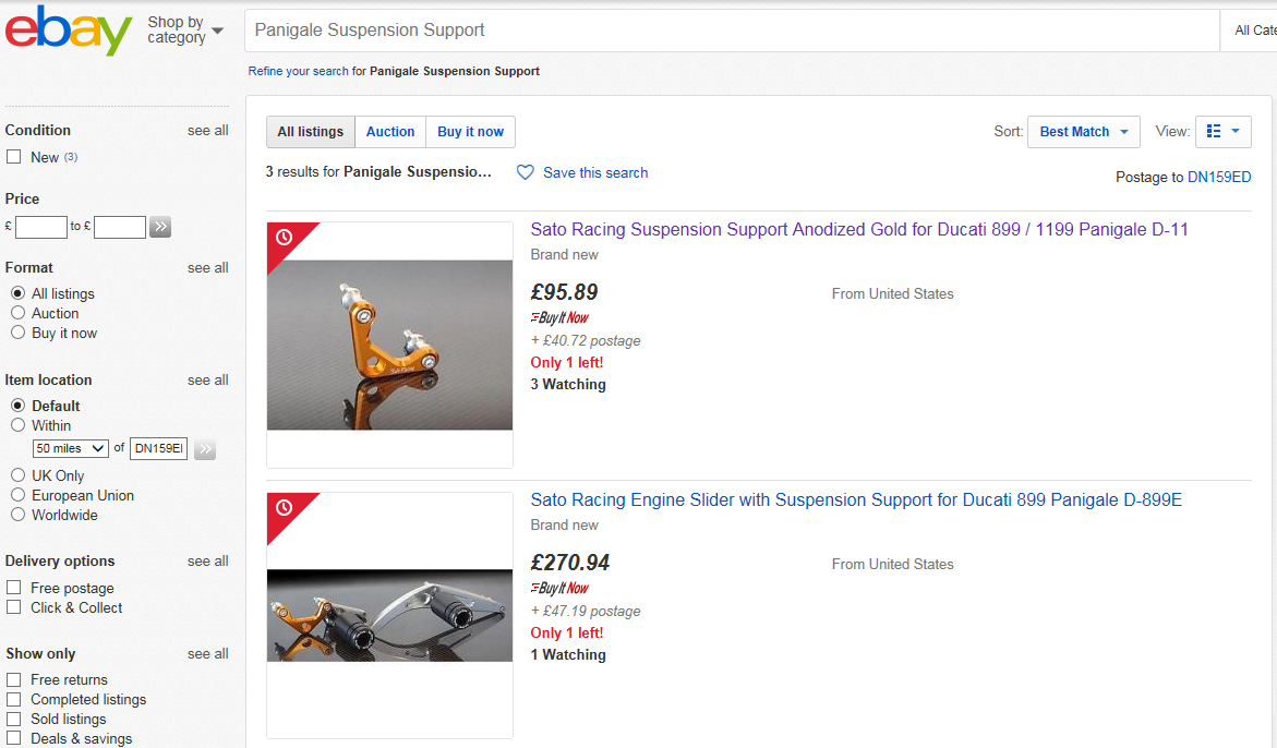

    Just a quick one to see if anyone has any experience of the Sato Racing rear suspension support for the Panigales??
    I understand this is engineered and manufactured to reduce the amount of stress that is put through the suspension mounting bolts which it appears that a number have failed and resulted in at least one fatality due to this.
    I have obviously found the product online and just went to order one off their website, however I cannot check-out as no delivery options are available to the UK :(
    A quick scan of Ebay, shows I can get one but the postage is extortionate... Screen shot below...
    Just wondering if there are alternative products available over here in the UK or if there are any US members that may be able to assist me in purchasing one and getting it to the UK with reasonable postage costs?
    Ben.
