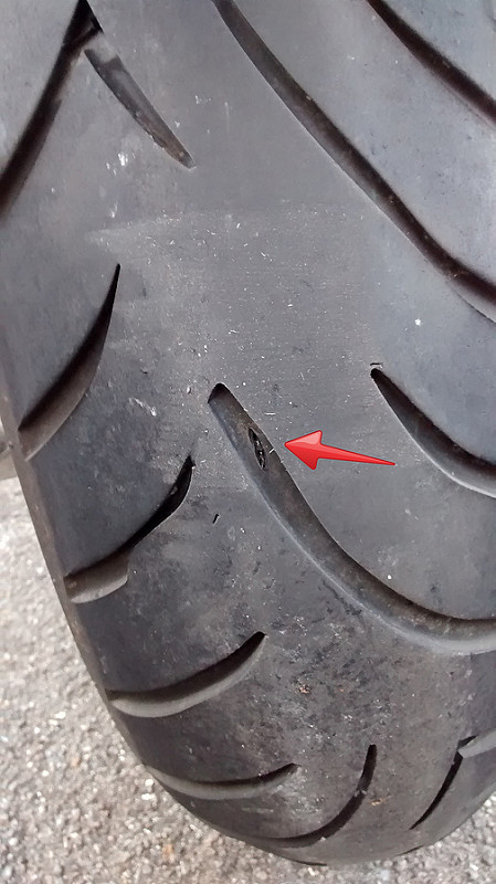

Sorted. Its the tyre. Tied a paper pointer to a few mm between front of tyre and swing arm and rolled the bike forward, at one point the tyre touches the pointer. A close look shows a deep cut about 1cm long deep in one bit of the tread. I can see what looks like a bit of the tyre carcass... New tyre time! Did same pointer trick with the wheel rim, that stays true all the way round. Wonder what caused it?
New tyre this morning and all feels well. Here is a pic of the old one. Avon rep to look at the old one I MIGHT get a few quid back if he thinks its a tyre fault...
That was probably caused by running over a small bit of glass. My back tyre has several of those little tears. Glad you got another tyre, but that really shouldn't deform it
