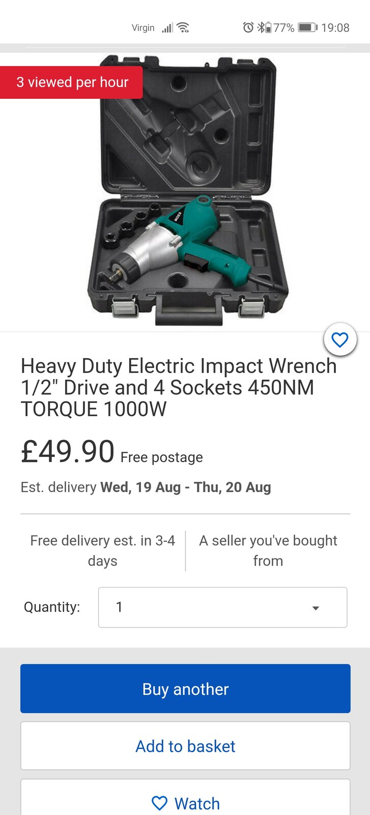

  3. As mentioned numerous times - Clarke CEW1000 is your friend for nut removal.
    • Useful Useful x 2
  4. Looks great. Just read the full post on impact wrenches. I was thinking the Milwaukee As i have batteries but that's some difference in cost and I have power in my garage anyway. Another great tip from you folks
  5. +1 for the Clarke CEW1000 :upyeah:
  6. I got one of these not expecting too much but worked a treat. I tried a 3foot breaker bar with a 4 foot scaffold pipe on the end with no joy....this thing got it off in seconds
