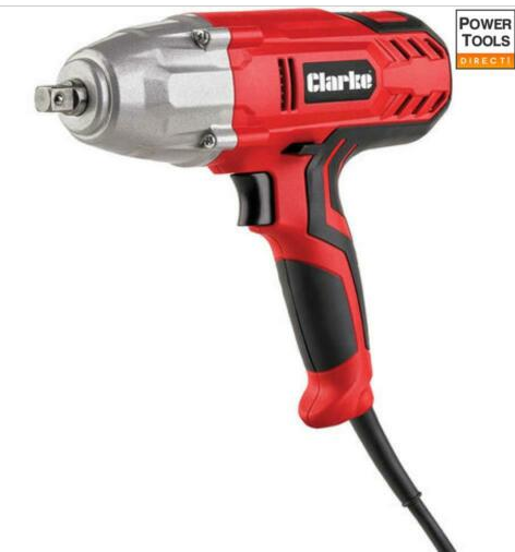

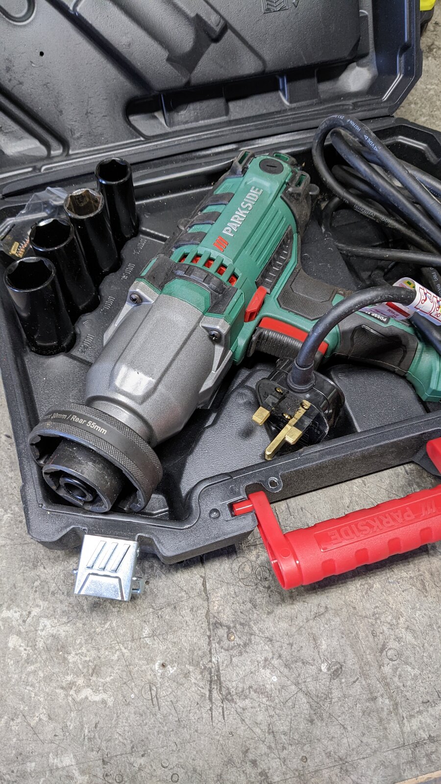

  3. This will shift it. Lots here use these, inc me.
    • Agree Agree x 5
  4. Ride down to the nearest tyre shop and they'll loosen it.
  5. You need an impact wrench with cojones. A battery wrench will not shift that nut when its tight. The Clarke unit above will, an air wrench will. That's about it.
