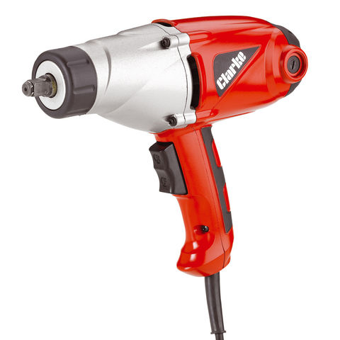

    I take it you mean this:
    Clarke CEW1000 Electric Impact Wrench
    450 nm torque
  10. I have one of those. Easily does my 1098 nut.
