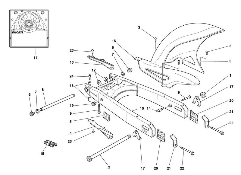

  4. Same measurement as my ST4s (aluminium arm). However, looking at the parts diagrams online, the ST2/3/4 (non-S) spindles have a nut on both sides, whereas the ST4s one is a different part that only has a nut on the brake side, and uses a counterbored head with internal hex on the chain side.
    ST2/3/4 (non-S) - 819.1.030.1A
    ST4s (and M900, M1000, Monster S4, etc) with Aluminium arm - 819.1.039.1A
    Hope that helps

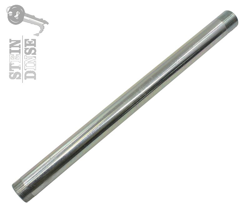

  8. I've been looking for a spindle for over a week now, and finally posted today asking for help.
    And by chance this evening, this was posted on EBAY from an S4:
    A tad expensive, but does have everything else included that I need.
    I was going to have to skim a couple of mm from the sliders in the steel arm to fit the Ali arm, and re-bend the adjuster plates to fit.
    But now I have it all on the way, hopefully before the weekend.
    Nasher.
