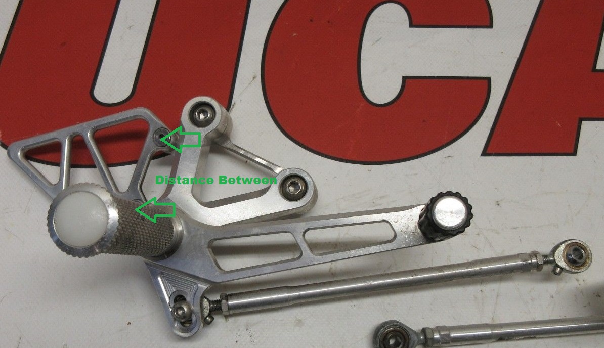

    -Can anyone tell me the spacing between the 2 bolts for the heel guards on standard oem rearsets, as I will be looking to buying carbon heel guards and replace the CNC ones and believe these rearsets have the same spacing distance between bolts.
    Thanks,
    Chris.
  2. 42mm, they are however offset, following the curvature of the bracket so the front hole is around 10mm further in (towards the bike) than the rear - not sure if this matters on yours?
  3. That's great, thank you. The 10mm offset would not be a problem. Seems these have the same spacing.

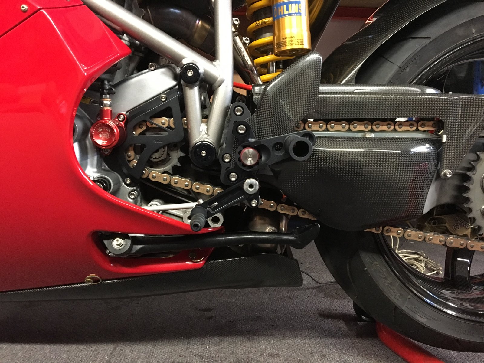

    If you don’t like those heel guards you could use the Corse carbon fiber type ones which go between the rear sets and the frame mounting points.
  5. I was looking at the Corse heel guards earlier this morning, they do indeed look pretty nice!

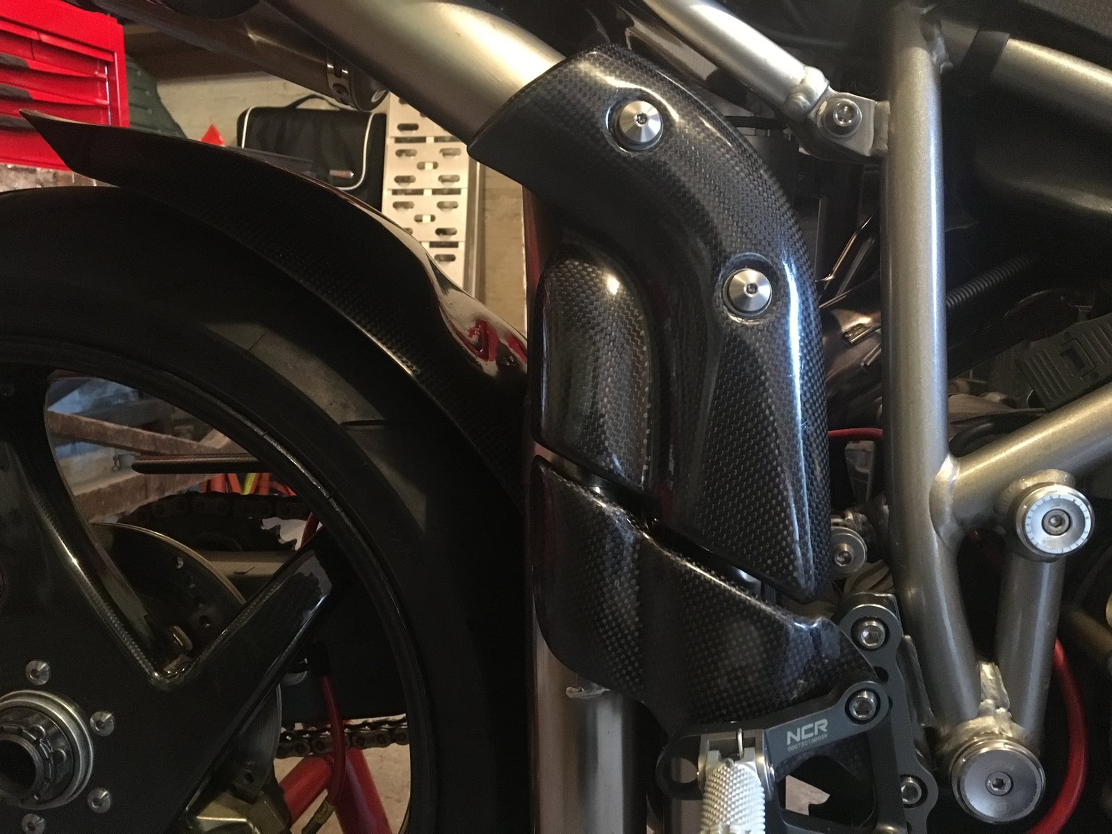

  6. 8EFC97D3-B51B-4076-BB97-02AD30880D3E.jpeg 317D12F3-64C6-453E-AF78-36551579FBAD.jpeg
    Good thing with the Corse ones is that you can alter the hole spacing so the r/h side matches perfectly to the exhaust heat shield. Couldn’t get the gap right with any of the other rear sets I used

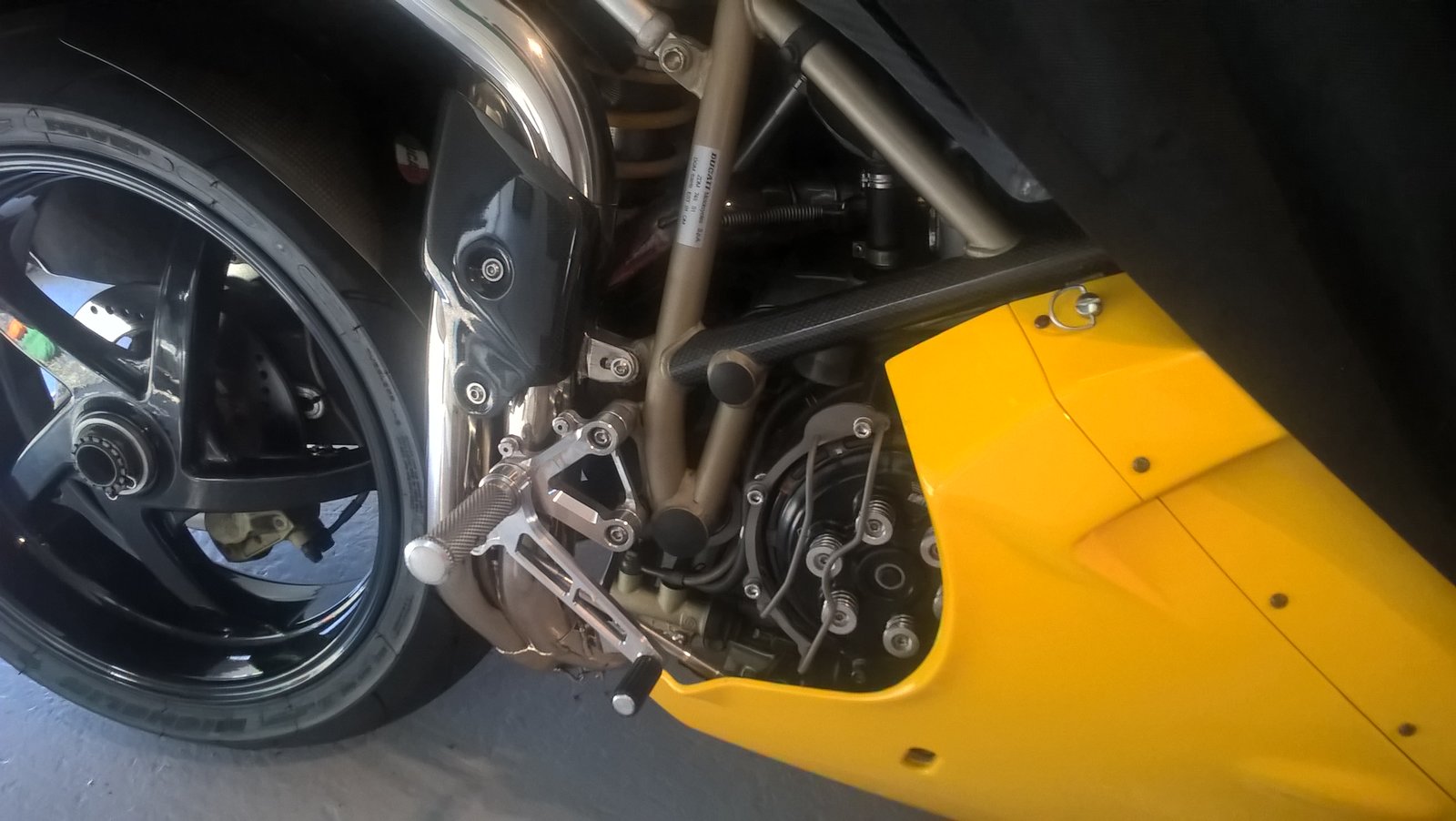

  7. Looks good, I have 'the other type' of heat shield, and the idea to get the heel guards sitting level. I think it will just about clear the heat guard thats sits further back before the protruding part of it.
  8. If not, easy to alter! :upyeah:
  9. well they fit spot on, don't know who made them, but surprised by the quality. Bit to bling like, so will take the shine off with a titanium colour anodize to match the STM guard.
