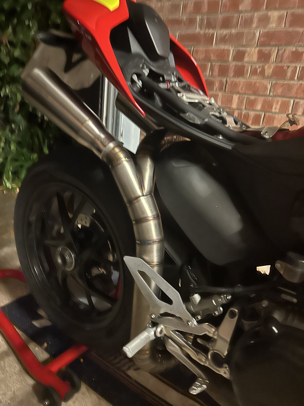

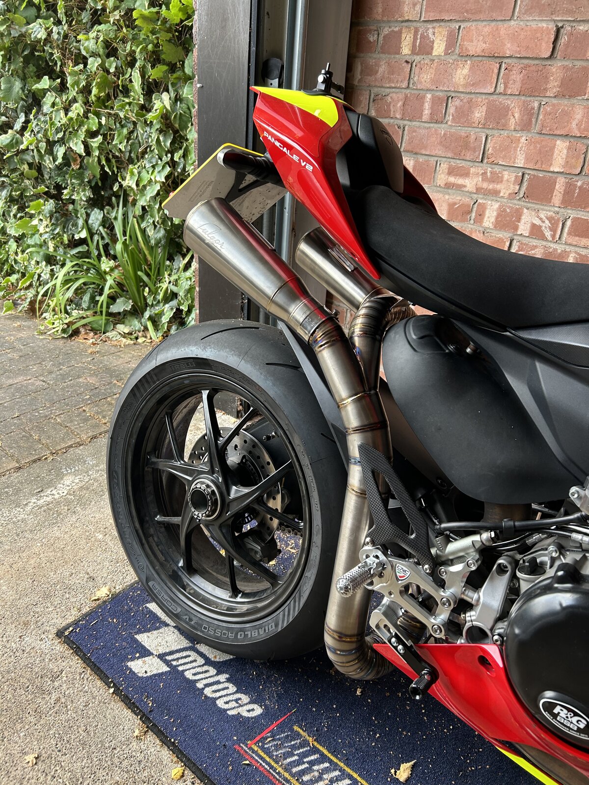

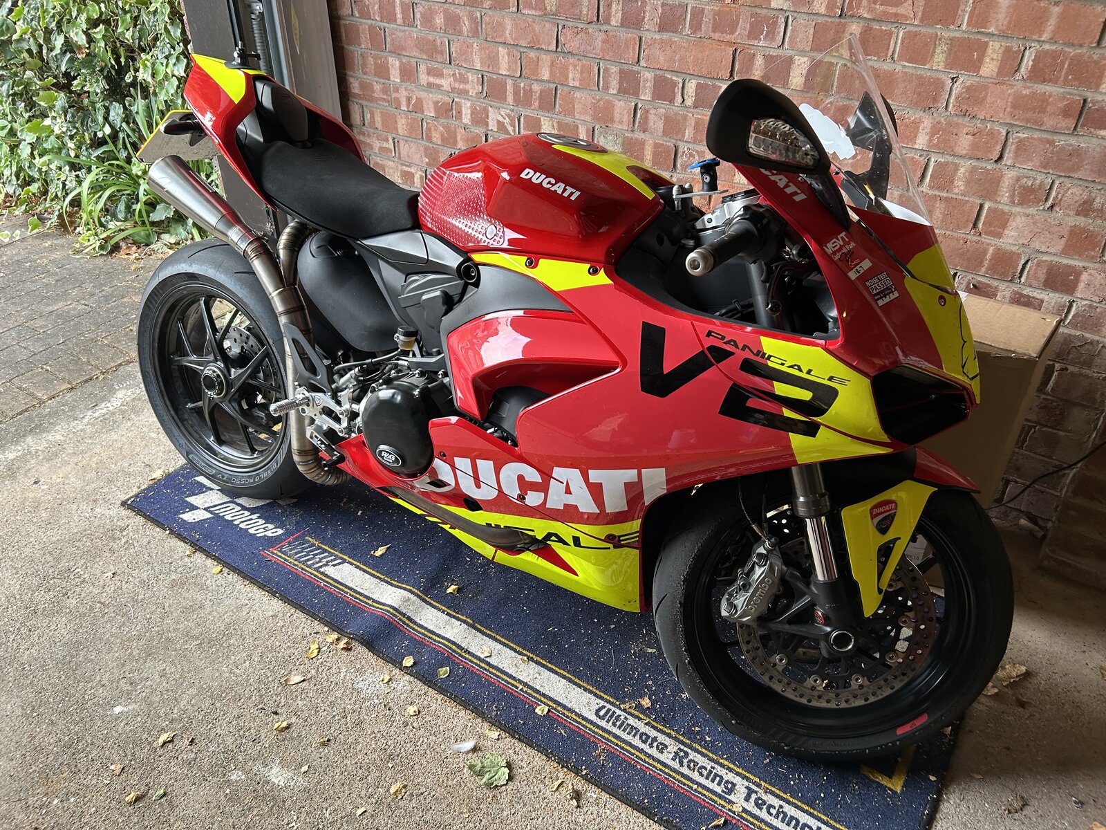

  3. Thanks do you have any dimensions of these assuming you have them. In particular I need to know the distance from the mounting point to the farthest point of the brake lever where it connects to the pin - I have an exhaust installed that comes up behind the footpeg that’s all
  4. I sold the bike earlier this year but hopefully a picture might help you scale it?

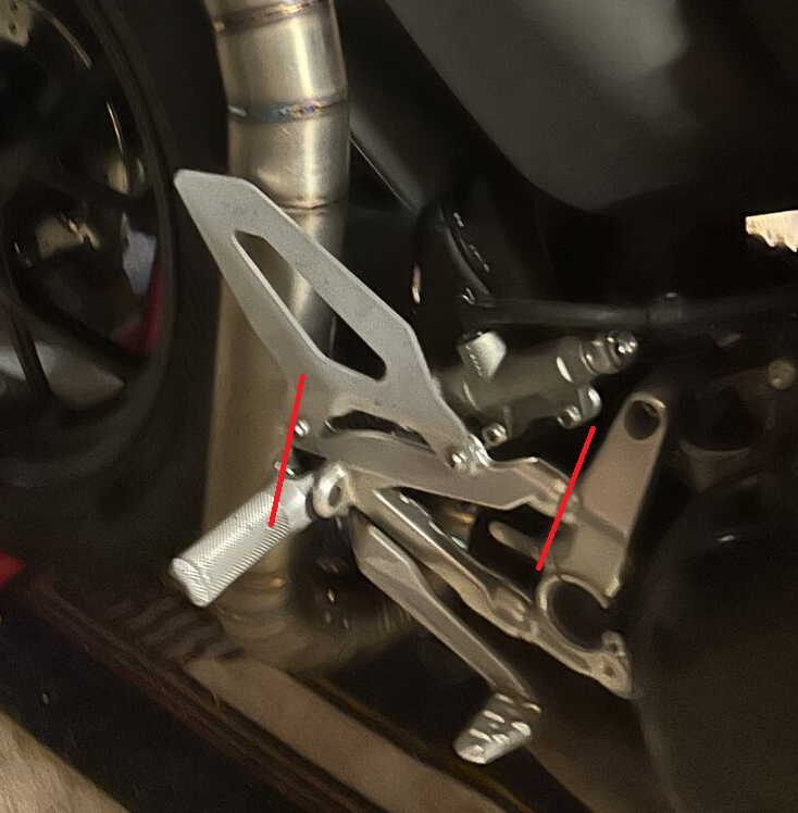

  5. IMG_0923.jpeg Thanks it is so hard to tell! This is the space I have!

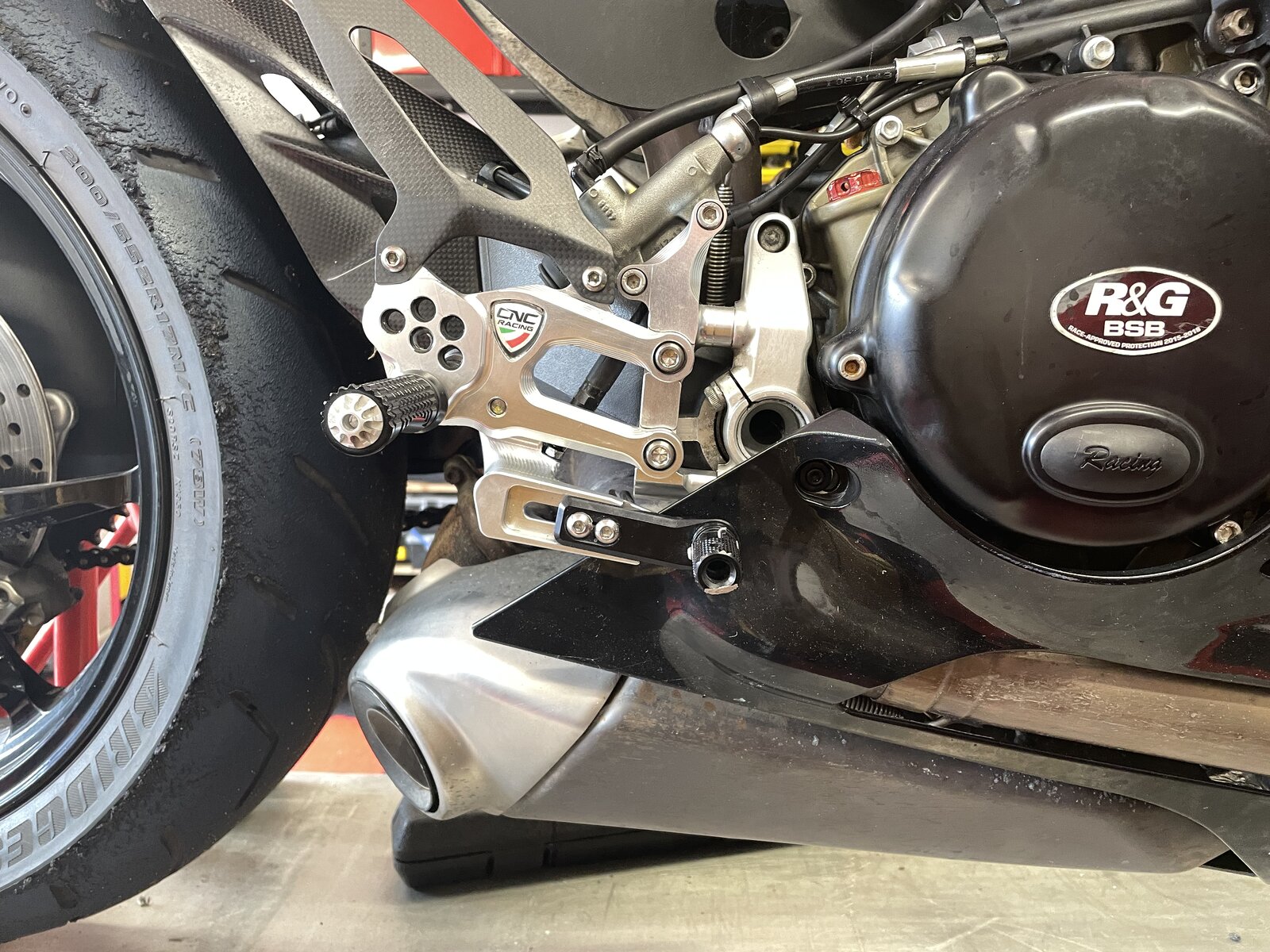

  6. I have CNC adjustable on my 959 but would fit a V2 - the side you need is against the wall, will see if can find a pic
    But able to measure a bit - from frame to back/furthest back point of rear set is 15.5cm (see red from your pic)

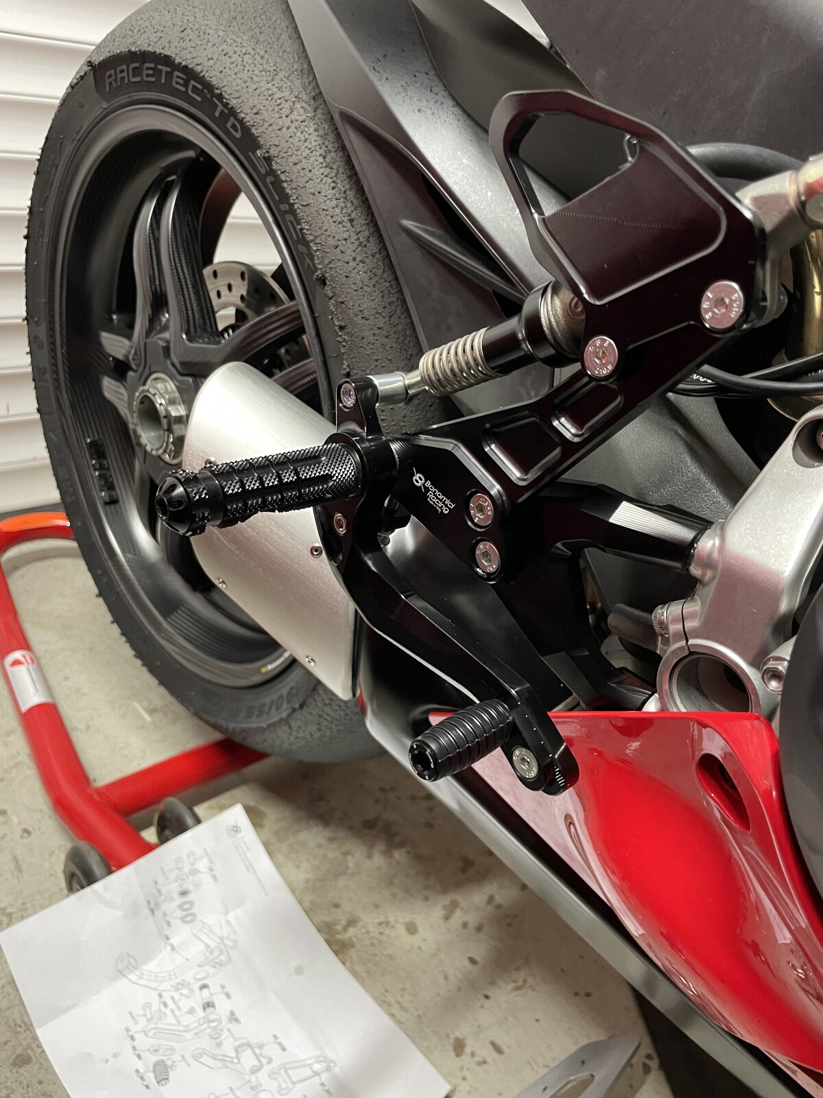

  8. If the V2 is same as 1299, DP have a set of sets which can be road or race. Ive a set on mine and I switched to race as I track my 1299. I now ride solely using race shift and wonder why the feck road shift is a thing as race feels more natural.

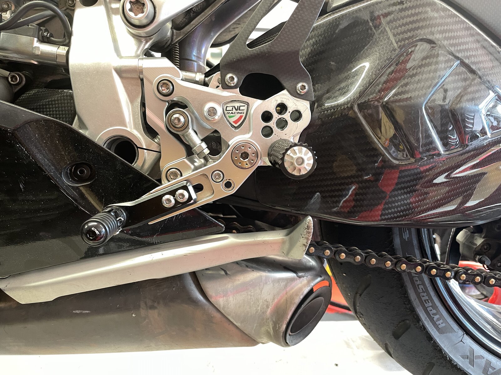

  9. Went with the CNC RPS rearsets in silver/black - hoping to get them installed over next couple of days. Will post a pic. Thanks for all the replies

  13. I’ve just measured them. I have on lowest setting holes, on paddock stand, they are within 1mm left and right for height from the floor to the top of the peg measured
  15. Thanks appreciate the follow up - yours look identical to mine other than the foot peg placement. I’ll have to remeasure although CNC replied to me on socials suggesting that the current v2 model has foot peg disparity!
  16. Well. That intrigued me and I have a v2 on standard pegs in the garage. Just measured it. They are right. The oe pegs are indeed wonky!
  17. I know I didn’t really believe them but didn’t have the patience to remove the CNCs and re install the OEMs just to check! You have confirmed though now which blows my mind how a bike is manufactured like that! Guess I’ll leave them wonky on the CNCs given that is how I have been riding it stock!
