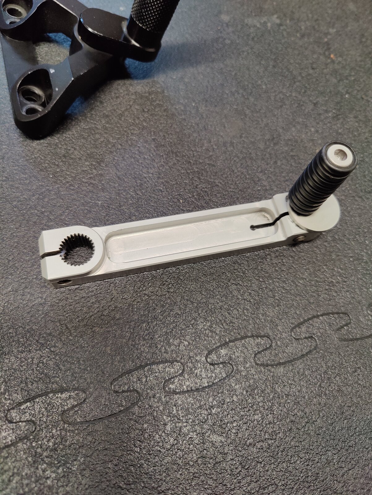

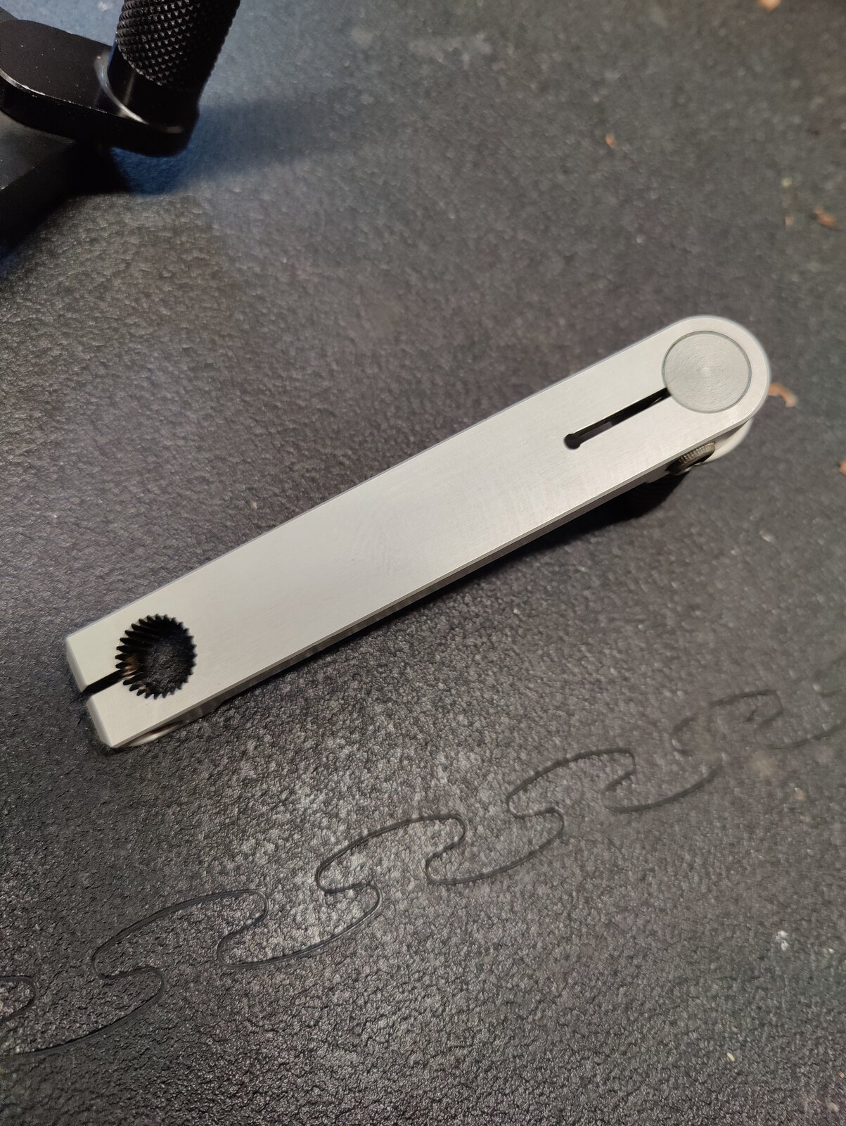

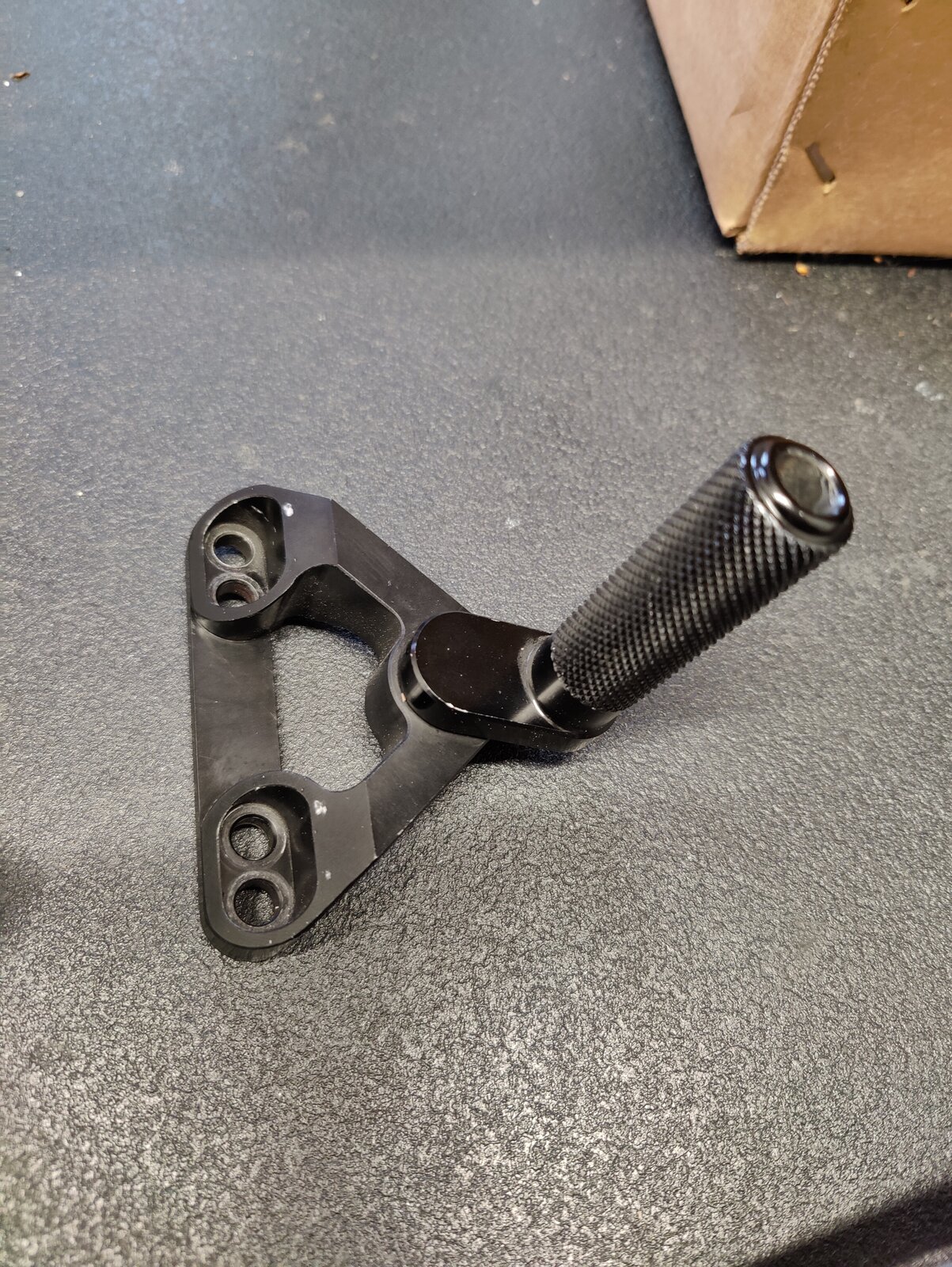

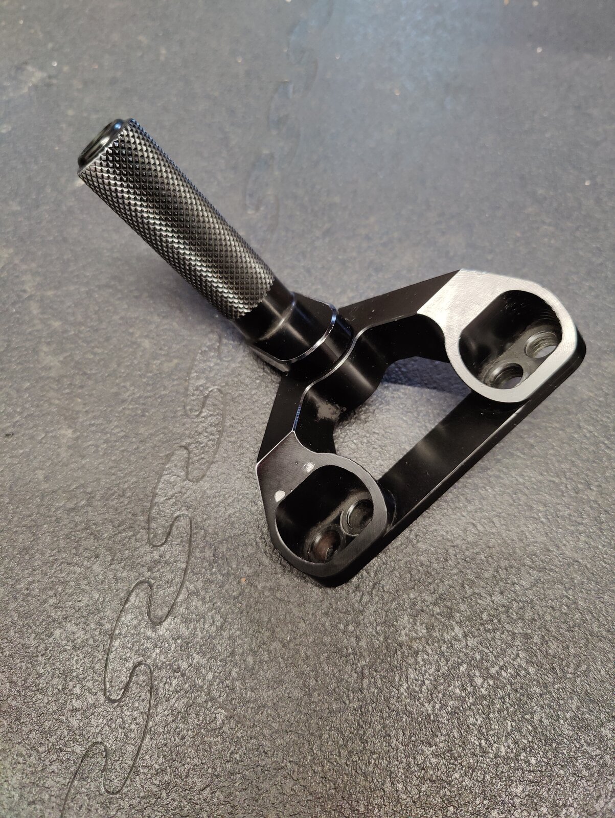

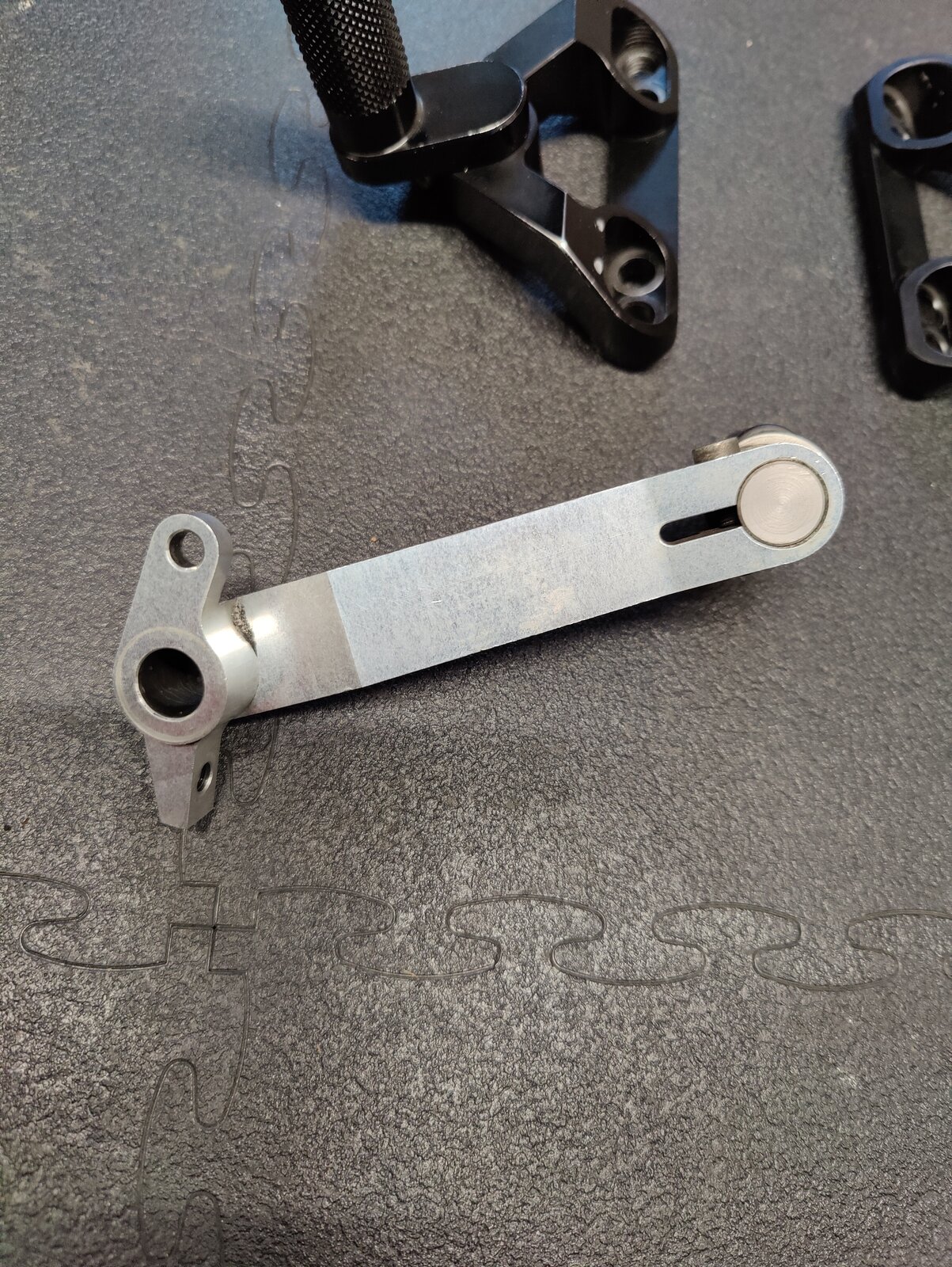

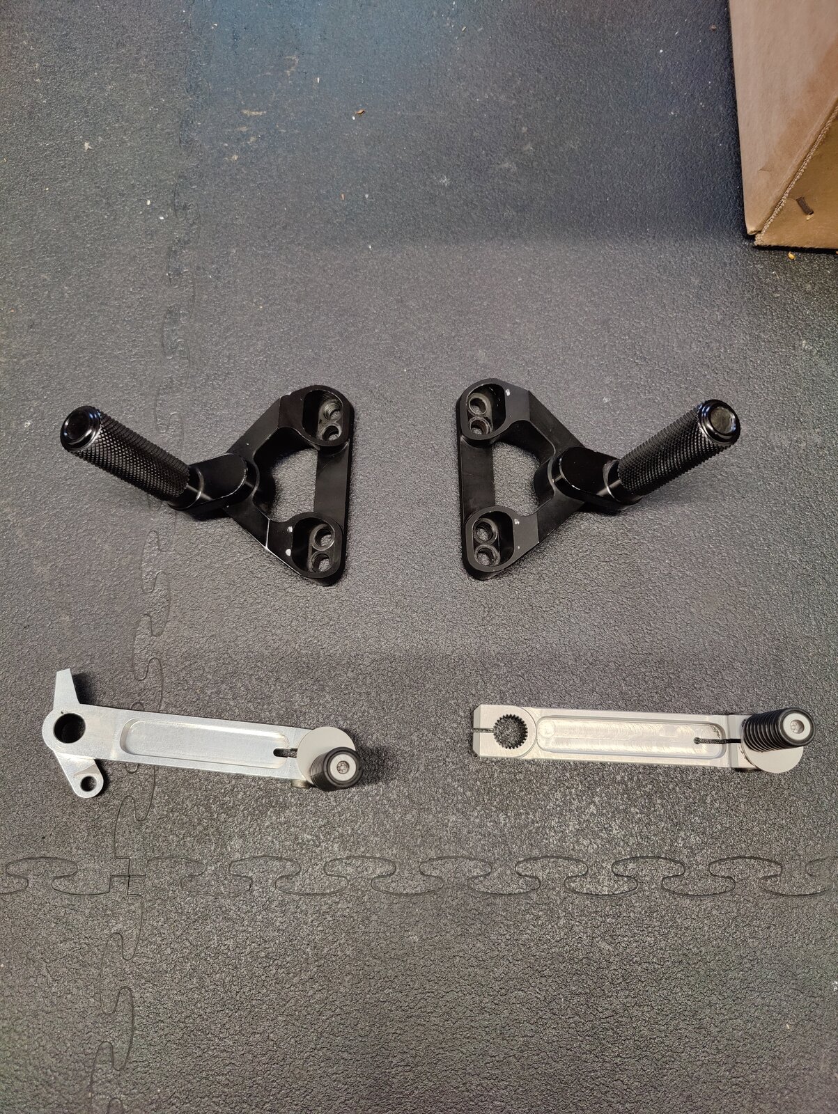

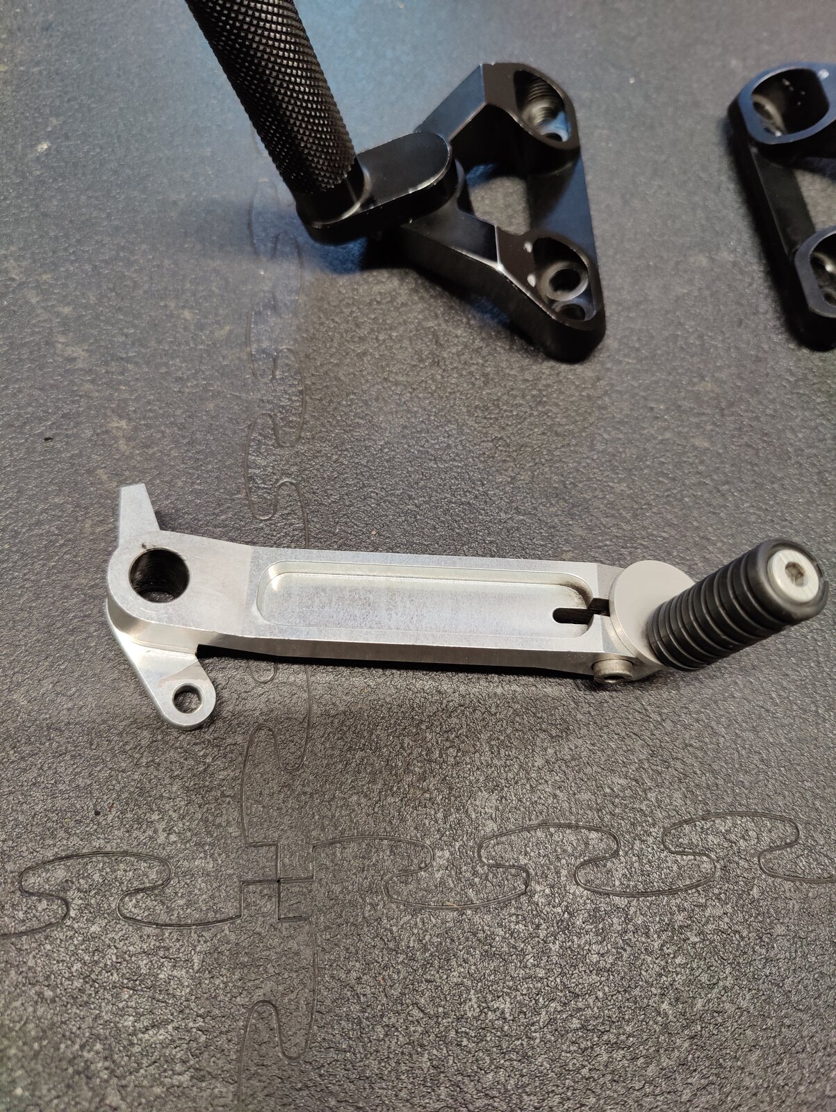

  1. Hello everyone, can anyone confirm if these are genuine Ducati performance rearsets or not? I understand these are also race shift pattern.
    Thanks in advance IMG20230630192942.jpg IMG20230630192937.jpg IMG20230630192954.jpg IMG20230630192949.jpg IMG20230630193007.jpg IMG20230630193003.jpg IMG20230630192931.jpg
  2. They have the appearance of DP ones but back in history, one could buy copies which were very similar.
    I had copies on my 748/916 for years. - really love the simplicity of the design.
    Also, I agree, that’s a race shift gear lever.
  3. I’m not sure about the rearsets being original DP but am pretty sure the levers aren’t. Maybe wrong…
    Do a search through this forum as this topic has come up quite a few times.
  4. Thanks for the swift replies.
  5. You can tell it’s raceshift because it goes directly on the gearchange spigot. Road shift would have to be via a gear change rod. (You can get raceshift with a rod but you can’t do roadshift without it)
  6. That’s race shift.
    You pegs look remarkably like mine (RS).
