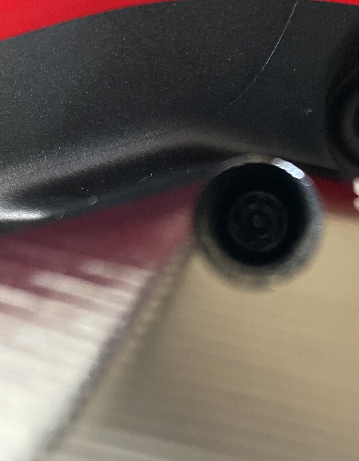

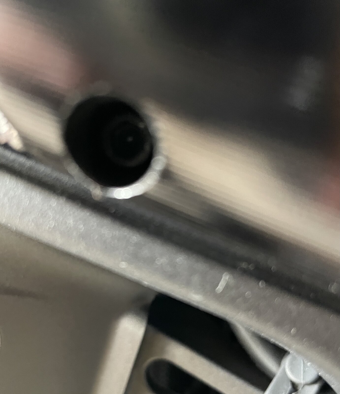

    9A8C4647-CAB9-4EB3-AE46-3713FEF8D4D8.jpeg 591D35FC-AC39-4348-875B-0029FE185222.jpeg
  9. I had similar with a pin on a rear brake caliper , the oversized Torx bit didn't work , I ended up drilling it out , started with a 5mm the then gradually progressed to 8.5 mms , I then used a tap and plenty of cutting oil to clean out the rest.of the bolt , worked a treat , just took my time .
  10. Why won't that drill?
  11. Hell fire Ian, David Bailey’s job is safe with you about :joy::joy:!
    From what I can see :bucktooth: I’m for drilling the heads off

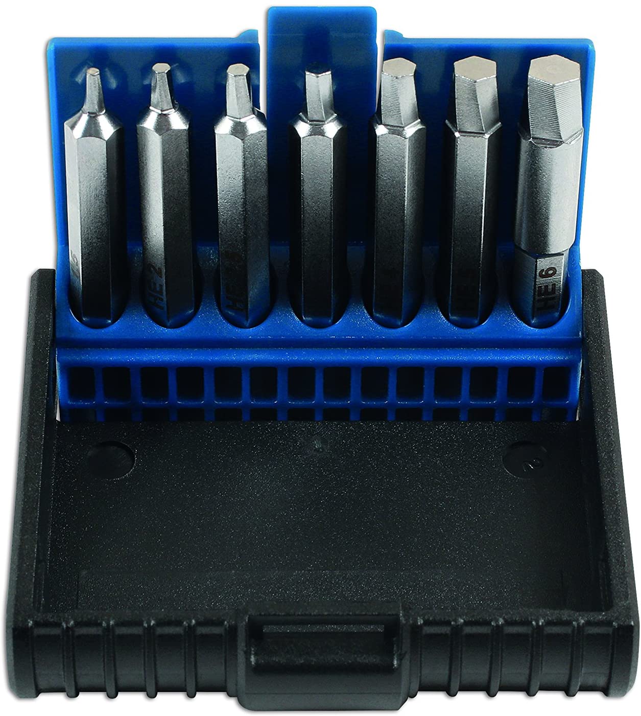

  17. I've removed quite a few rounded allen head bolts will a cheap Speedout screw removal?easyout kit from Ebay they only cost £3.29 from Ebay , i use them fitted in a socket and it's worked perfect everytime so far.
    would really recommend them

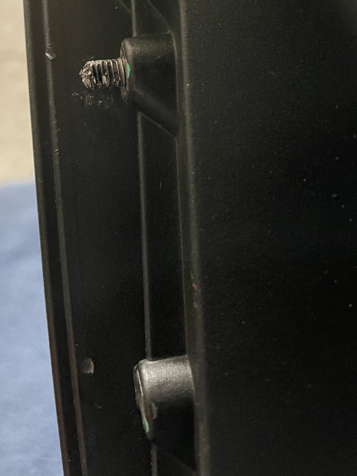

  19. 7295AE04-3DD4-4007-A315-8841965490BC.jpeg Had to drill the heads off the last 2.
    One of the remaining threads screwed out using my fingers, the other is stuck like shut to a blanket.
    I wouldn’t care, there cannot be many threads left in.
