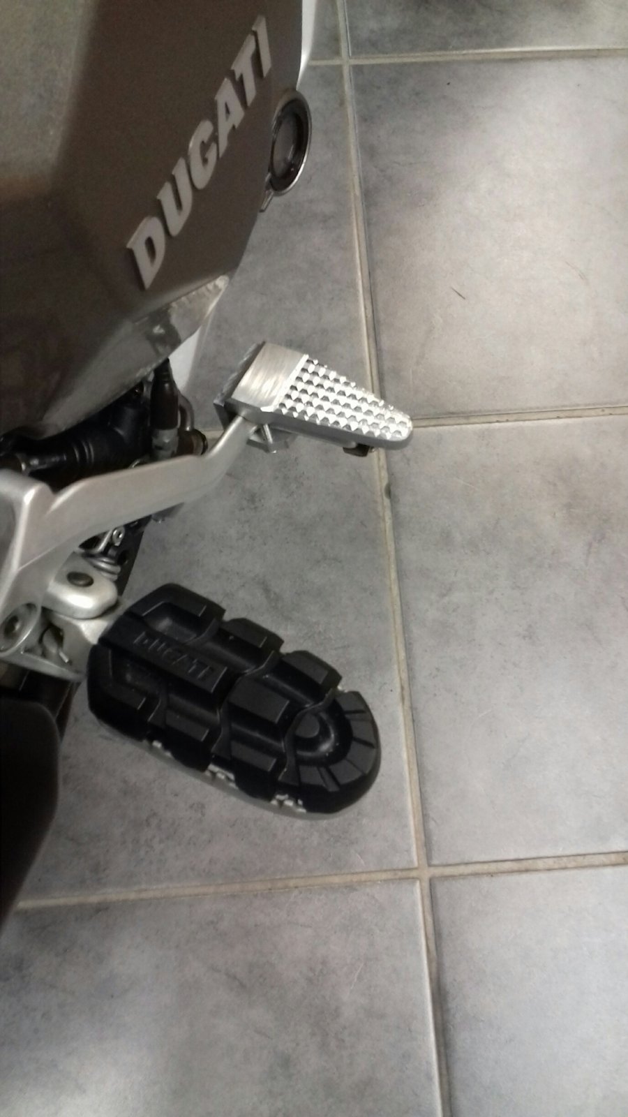

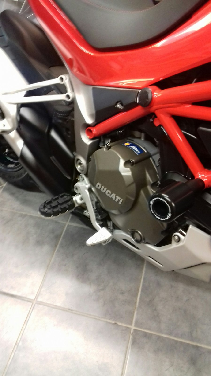

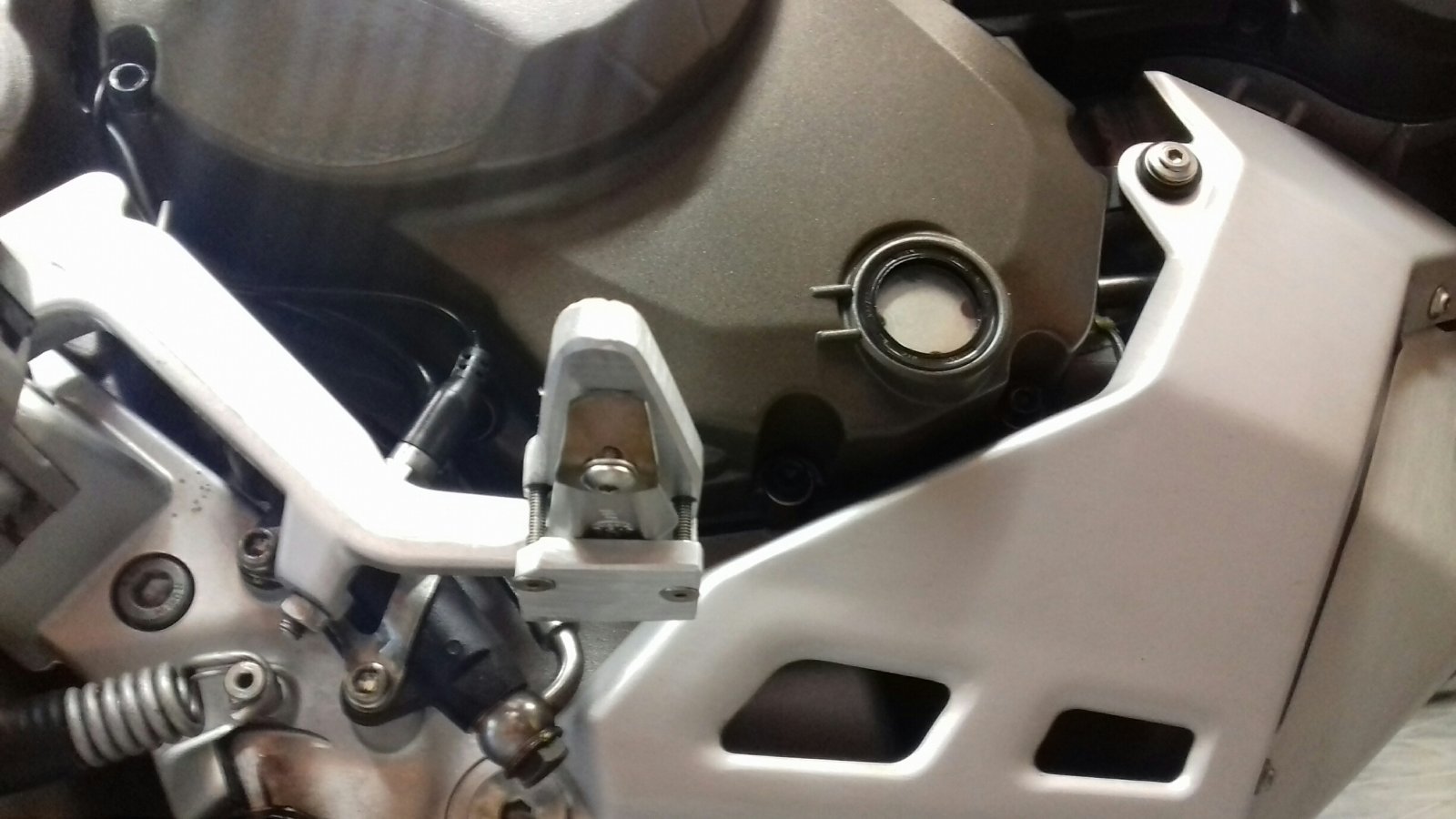

  3. Hi
    I made one up myself - I posted on here before - but here are the photos again.
    Sort of the opposite of the one on Revzilla
    Basically a flat plate and a bit on angle on back and underneath.
    A bent Stainless washer at front underneath and 3 screws
    About 3 to 4 hours F*** About.
    Just bolts around pedal - works well - maybe a bit long?
    I had a break in my leg about 12 years ago from a bike accident and my right foot is rotated maybe 5 degrees - so almost impossible for me to get it in on the standard pedal.
    20160902_184809_resized.jpg 20160902_184815_resized.jpg 20160902_184829_resized.jpg
