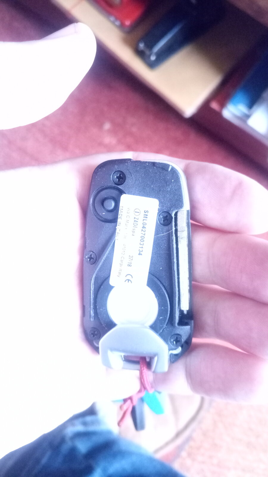

    Just had my fob replaced by Ducati, I now have a reset button but haven't had to use it yet.
    Strangely the active key won't work as a passive key when it gets in this state. But red key will.
    2016 1200 Enduro by the way.

  8. Get in touch with Ducati if you haven't got the reset button in the fob, they should be able to see the update on their system. Mine hasn't disconnected since I got the fob changed a few weeks ago.
  9. I don’t know what “the reset button in the fob” is or looks like.
    My fob lives in a waterproof jacket pocket in a plastic bag all the time. I hope it’s still there as not used the bike in three months.
  10. Well, leaving the battery out for 20 mins did the trick so thanks folks. I don't know what a reset button is either but now I'm keen to find out :D
  11. See my picture 2 posts up for the reset button. No idea if it works as my fob hasn't lost contact with the bike since I got the updated fob.
