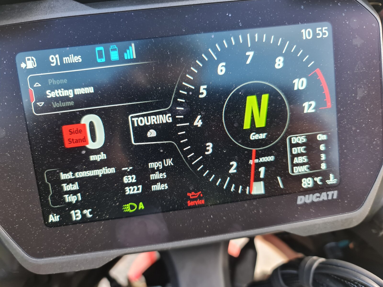

I've travelled from Kent to Devon visiting my daughter on my new Multistrada. It's just gone past 630 miles and the red oil service light has come up. Is this literally just telling me that it's due its first service? Or is it something more ominous? I'm concerned because I wouldn't expect something non critical to be illuminated in red. Any red lights usually mean stop immediately, don't they? Please help, what should I do?

1st service is required at 1000 km which is 620 miles. I'd say the light refers to the oil service now being due.
Here's the online user manual. I don't carry the manuals on my bikes either (should do I suppose....) so, I always have the online version saved in favourites on my phone: V4 PP User Manual. Page 271 for what it's worth.
An indication of the times ; the first sections cover the cruise control and Infotainment and the controls aren't mentioned until page 127!
That makes sense. I've only ever seen it referred to as the 600 mile service. I know for a fact this wasn't showing at 600 or just after, but the next time I looked at 630 the light was showing. I feel silly for panicking now but I thought a red oil symbol meant low oil pressure universally. I've never worried about carrying a user manual before but every bike I have had been before has been so much more basic in tech in comparison. These Multistradas are every bit as technically complex as most modern top spec cars.
Understandable really. Oil pressure lights have always been red and the symbol does have an oil can symbol. I see though that there is an oil pressure warning light to the right of the dash which will come on at switch on and go out when the engine is started.
