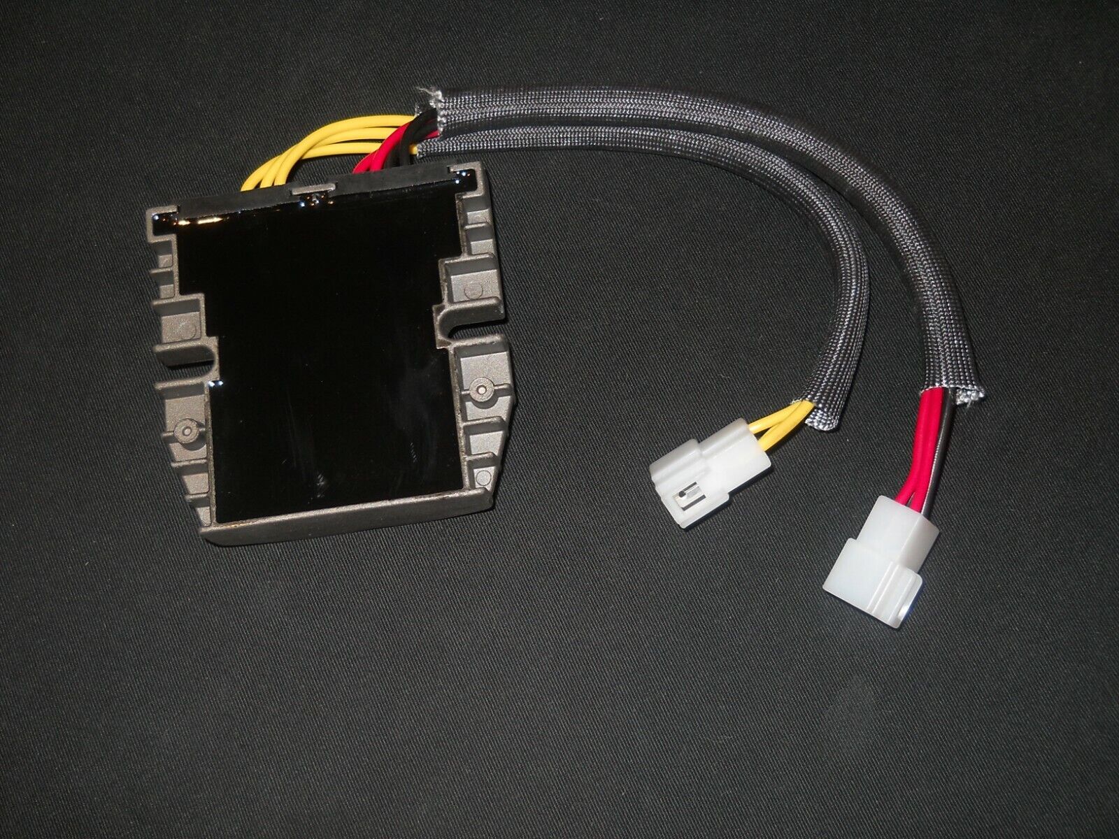

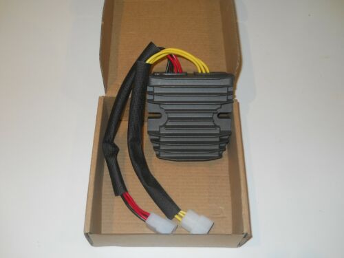

    [​IMG][​IMG]

    It appears there are 2 types of shindengen clones out there. The first is shown in the pictures above and has black potting compound that fills the unit from the back. The second and, in my opinion, better one has a heat sink identical (not just similar) to the shindengen with the correct amount of round casting lugs and has a aluminium plate at the back.
    I've been using both types but the aluminium backed unit simply looks and feels better quality. As neither has failed on me it's quite subjective. The "better" unit is a few quid more but still around the £20 mark from China. I'm pretty sure that's all your getting from a European eBay seller anyway.
    Pictures of the "better" one for comparison.
