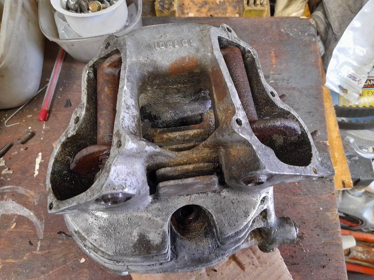

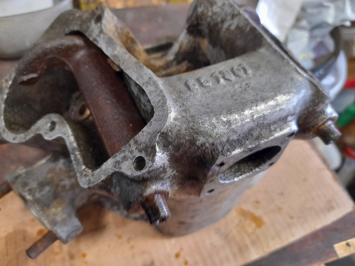

    Here are couple of pics.

  3. I'm happy to try anything Andy. The main trouble as I see it is that the rockers are about 75mm long and have quite a close clearance to the spindles. That's a long way to penetrate.

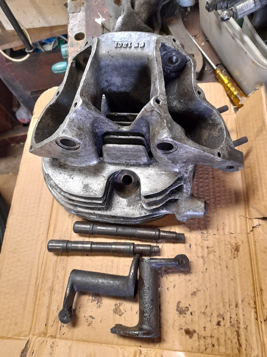

  14. Got them out. After 4 days in Deox-C, a week in diesel/acetone mix and (thanks @finm), 3 days of applying DeBlock XS and a fair bit of heat most times I tried to get anything moving. On Tuesday I got some movement on the exhaust rocker, yesterday some movement albeit stiffly on the inlet. Today I got both rockers moving freely and after judicious application of a propane torch got the exhaust then the inlet components out. I think the most effective thing was to fill the oil ways in the spindles with DeBlock and plug the inlet so that it was contained and soaked it's way through to the bearing surfaces.

  16. Yes, the DeBlock worked a treat. I was on the point of thinking I was going to have to cut through the spindles. The rockers are definitely salvageable, I managed to damage the thread on one of the spindle although bit would probably dress up. I bought a spare set of rockers though in case the worst came to the worst, so I'll probably use them. Next task is to find an exhaust valve and collets. They are rarer than hobby horse shit.
