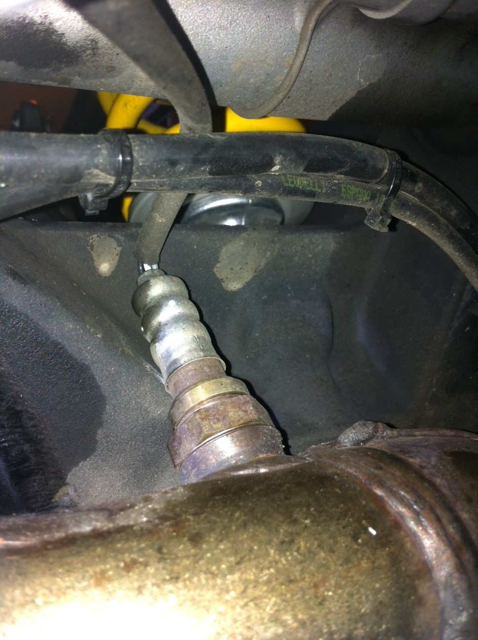

  1. I have got to the stage where I'm attempting to remove the mid pipes on my 848 Evo so as I can swop the rear shock over.
    After 5 hours hard work I have the pipes just about to pull free but It appears that what is preventing the pipes removal is the Lambda sensor, which is hitting the swing arm.
    Is removal of the Lambda sensor just a question of undoing the nut, I don't want to twist all the 4 wires going into the top of the sensor, which unless I can find the other end of the cable where it disappears into the engines innards is going to happen, or is there another way of removing the sensor without twisting the wires?

  2. Cant you dangle it out of the way, use a bungie to hold it up? Fwiw I diteched mine and put a bolt in when I had the ecu done, coz you think its hard getting it out: wait til you try and put the pipe back on and get the fecker back in the swingarm hole...

  4. I just unbolted, but its easy to trace back to the connector first. I may even have a pi in a box still somewhere...its a terrible design, even a know nothing (pedant notice, its not 'no' its 'know') like me used to whip out a shock, remove cans etc quick and easy, where this takes hours
  5. Hi john. The connector for the lambda sensor is next to the connector for the exhaust servo motor. If you look at the R/h crankcase, find the breather pipes that go into the belly pan. The cable for the lambda is inside the metal clip holding the breathers
