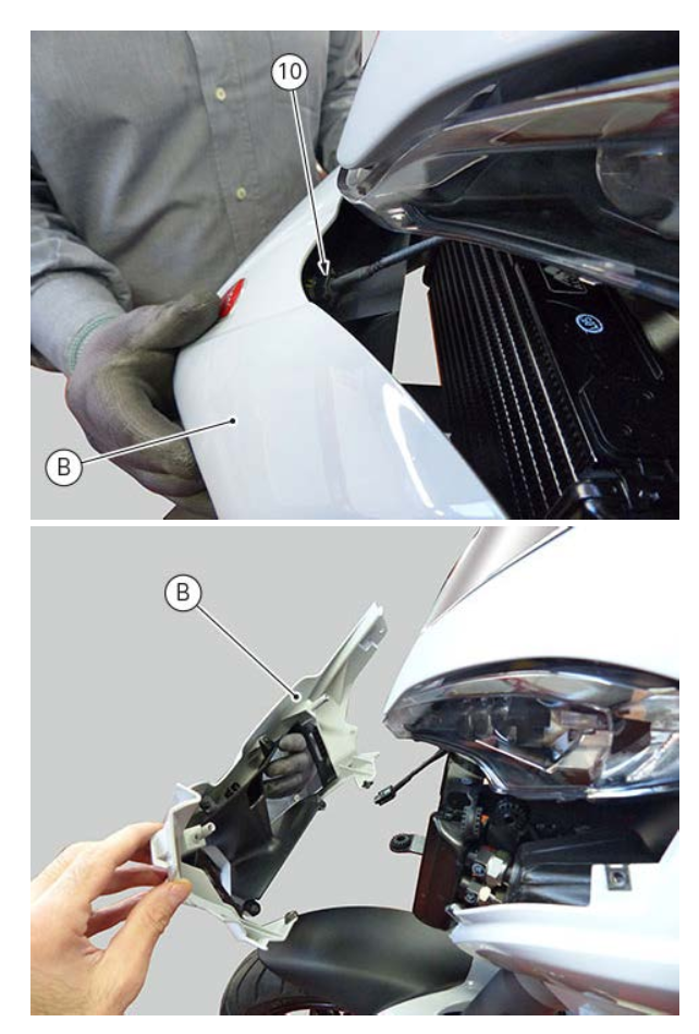

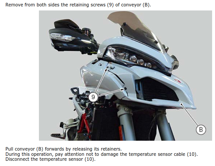

  1. I attempting to remove the nosing faring but can't see how to release the temperature sensor connector. In the past I've left the cable connected and managed to install oil cooler guards. This time I 'd like to remove the nose faring completely so I can give the bike a "deep clean".
    So does anyone know the trick for releasing the temperature sensor connector?
    The 1200 DVT workshop manual (2015) isn't much help, all it says is to take care not to damage the cable :-(

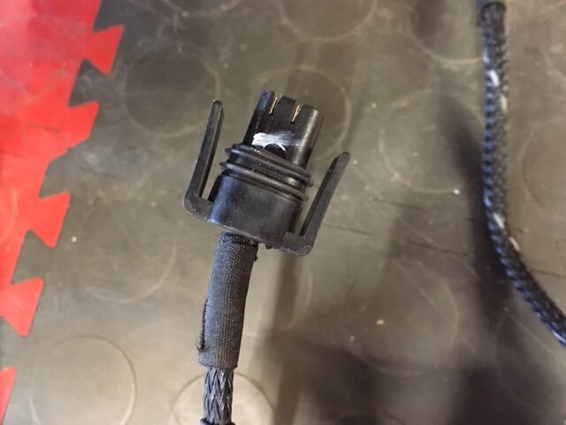

  9. Here's a picture of the connector. The tabs need lifting, rather than depressing. As said, fiddly rather than difficult. IMG_6368.JPG IMG_6368.JPG
    • Useful Useful x 2
  10. @nelly, many thanks for the photo as it is makes it a lot clearer what is required. In fact I just popped to the garage and released the connector :)
