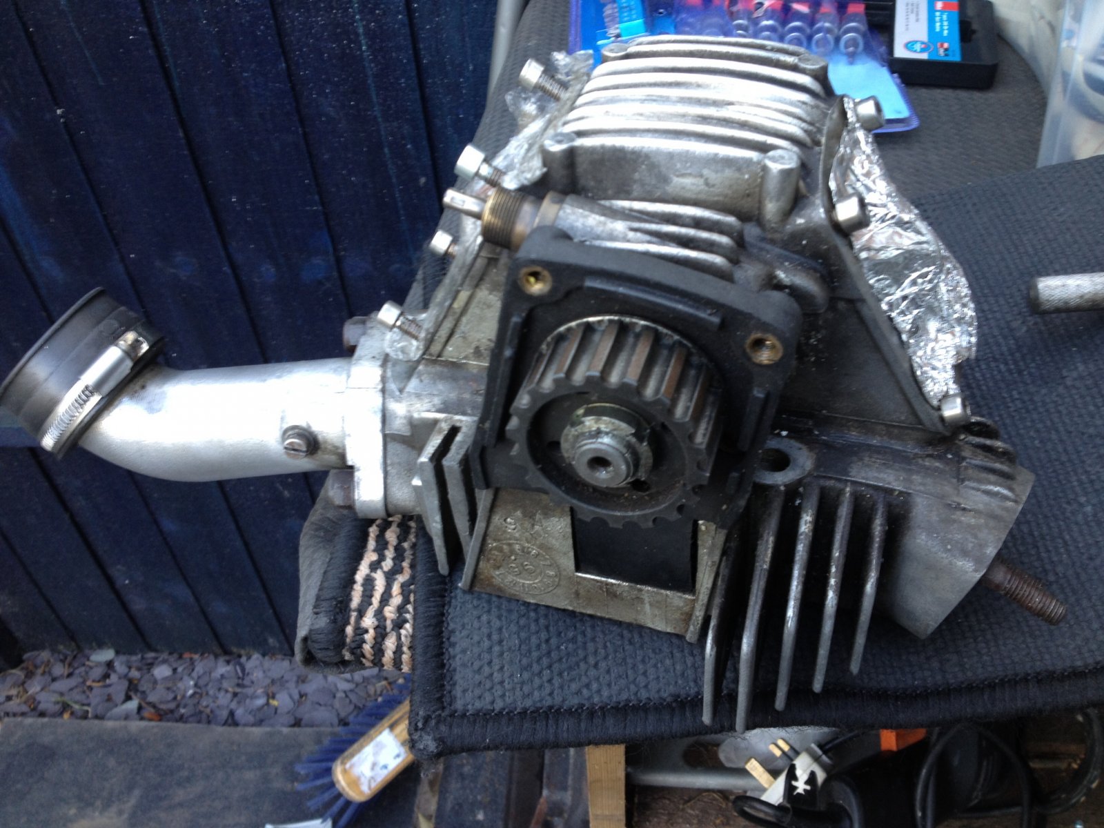

  1. image.jpg Is it possible to remove the cambelt pulley while head is removed?

  2. Yes, I use an old cam belt wrapped around the pulley and pinch the ends together tight in a vice.
  3. There is a tool available that will hold the pulley in place, check out eBay. It does take a bit of effort to undo from my experience but you do need to get a good purchase on the "nut" as a slip can cause damage to the nut and or the tool itself.
    I believe it is recommended that you replace the "nuts" once they have been removed, I did when I last did this job but i did have a spare supply of "nuts" and I wasn't going to take any chances.
