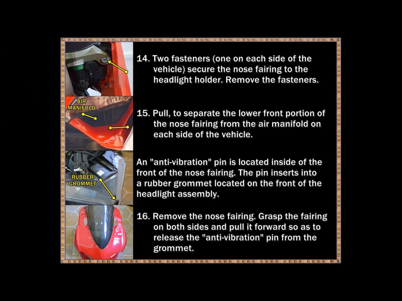

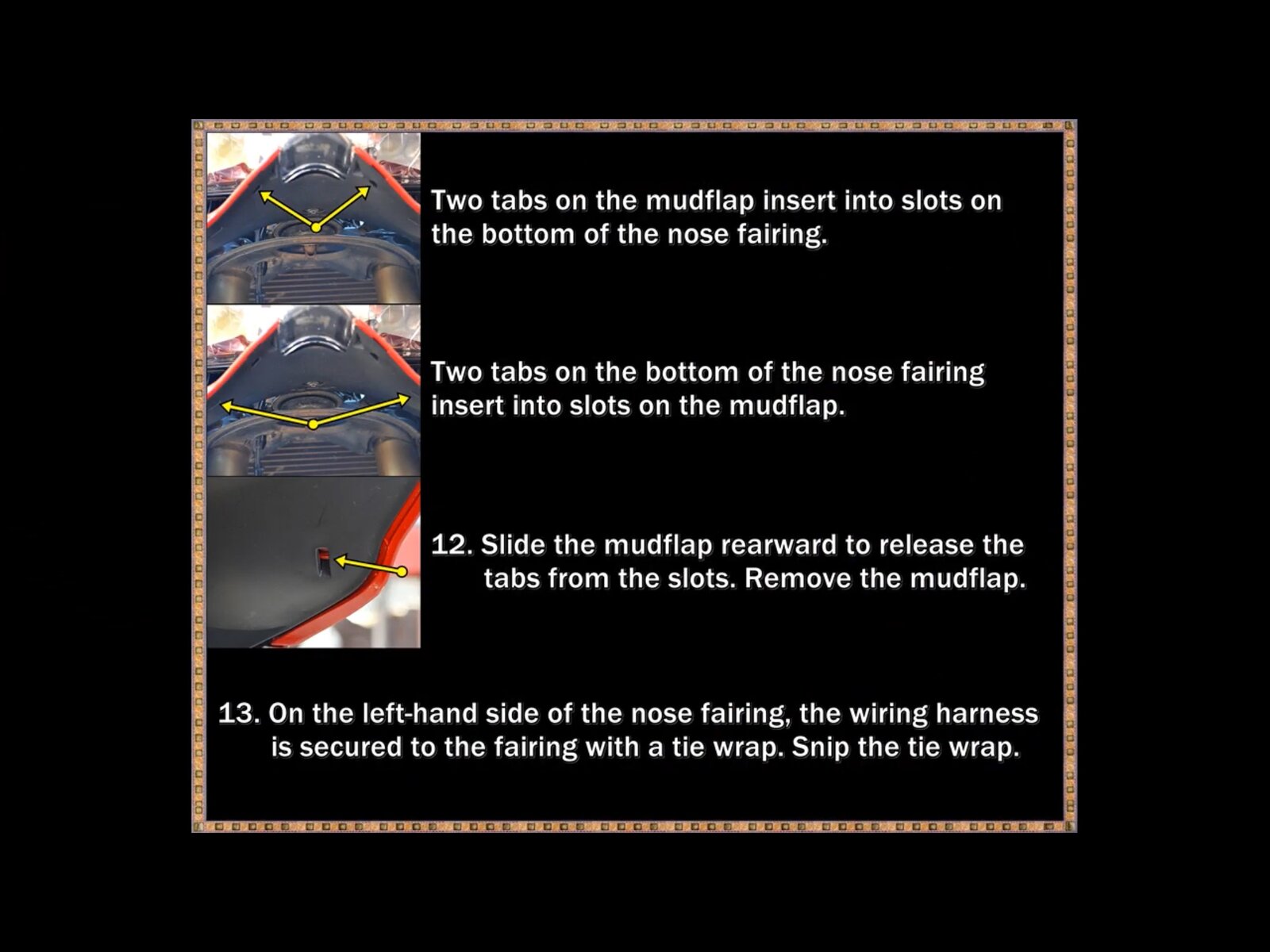

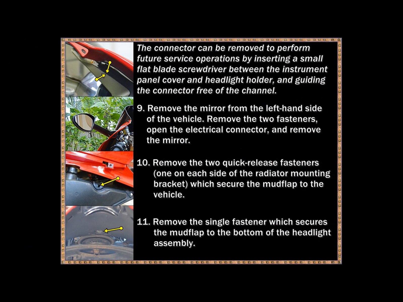

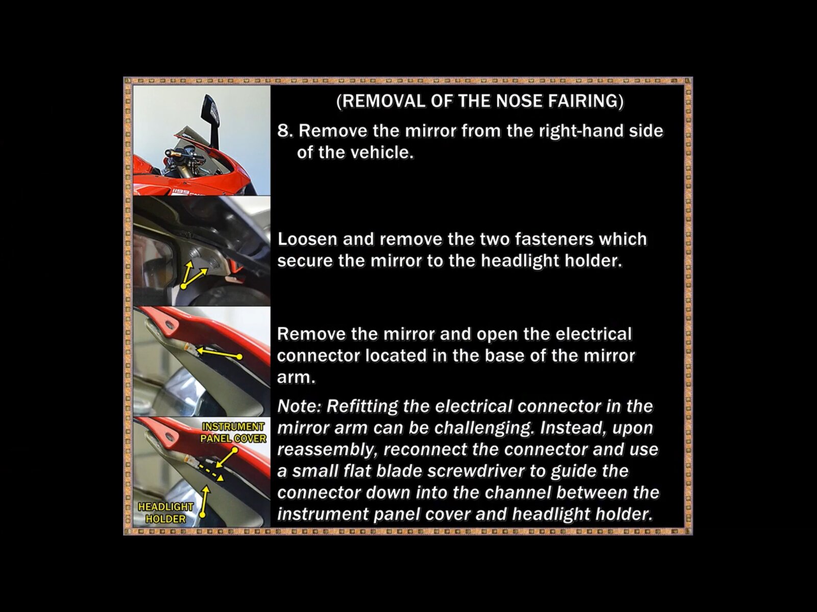

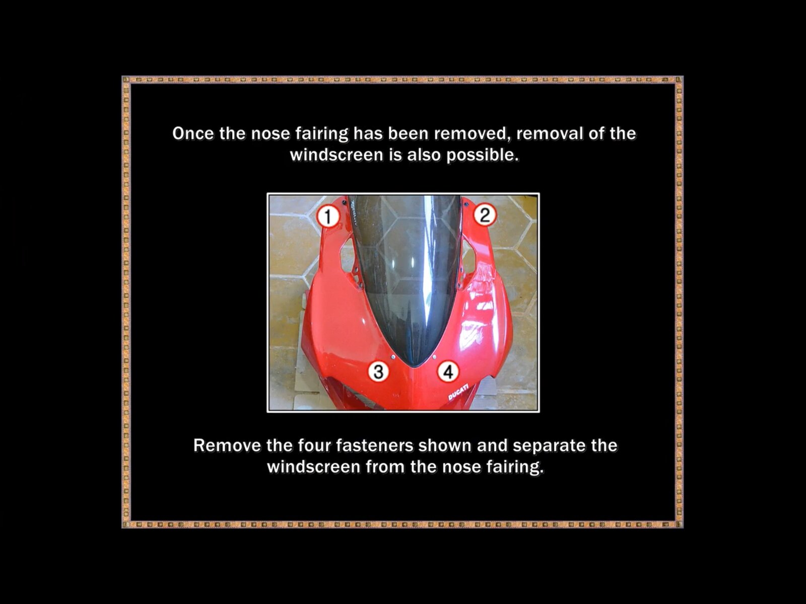

  1. Is there a numpty guide, need to get it off to remove the screen as the 2 lower bolts aren't turning side panels are off, can't see what's holding it on now
  2. Pinched from YouTube A9AE7E9E-8582-403B-BFDC-32799494ADF3.jpeg 1650AE88-2FFE-44DC-B13A-29AF76E1F48E.jpeg D73789EC-3337-4F72-9530-9B876763DFD4.jpeg 4F0FB720-4363-48E3-AA92-80764ECE4185.jpeg C9C92670-4964-4952-9CB4-FE349E826686.jpeg
  3. Thanks so much, didn't actually try a search thought there would be a guide on here, much appreciated, apologies for my laziness
  4. Mine wasn't like that but removing the mud flap thing was key and pulling the sides out just behind the headlight,
