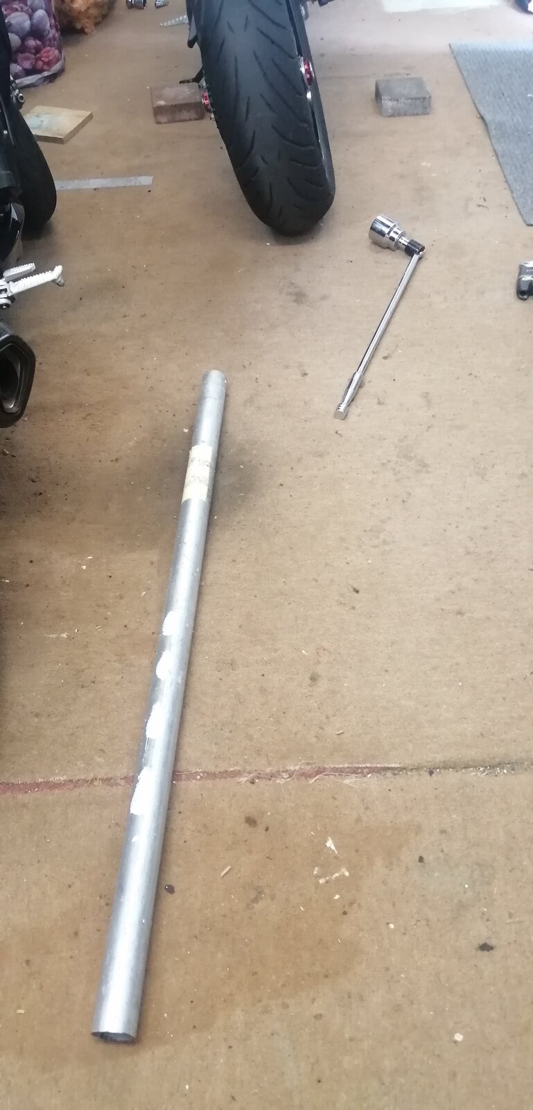

  4. I've just had the joys of this. I normally undo both rear nuts a couple of times a year so they don't get seized on. Daughter sits on the bike in gear and on the brakes. Wife (a chunk) sits on the pillion seat. Breaker bar and a large scaffold pole, mega effort but they both eventually came undone. I think next payday I will be buying a impact gun, buggered about for years struggling.

  7. You need to buy a bigger breaker bar! My old one is bigger than that and flexes about 20 degrees before the nut will spin off, I'm terrified of it snapping and taking a chunk out the wheel so bought a 1m long proper 3/4", only £25. Using that reducer isn't the best either so I'm told.

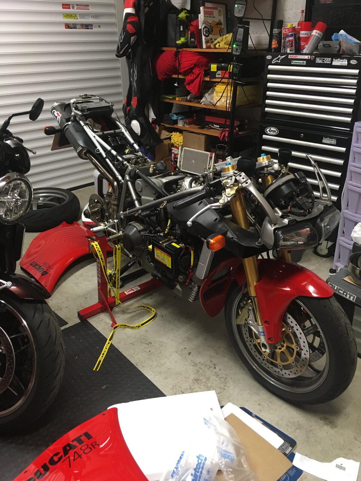

  9. I have used an ABBA stand with ratchet strap down to the base of the stand to hold rear brake on before the days of ekectrickery. That worked. But why bother when it’s so much easier to cheat?
