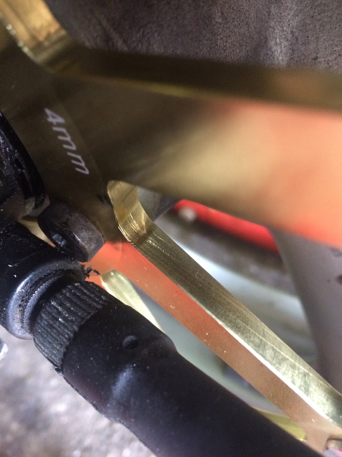

  11. 275302D8-7312-4A0E-A209-E84919716662.jpeg One thing I did notice when reassembling was that the speedo drive casing was lightly fouling against the disc fasteners, at first I thought I’d missed a spacer but had a look on my 900ss and there’s virtually no clearance, so I removed about a mil from the plastic housing so at least the bolts don’t contact it now.
    Photo is before I removed the material.
