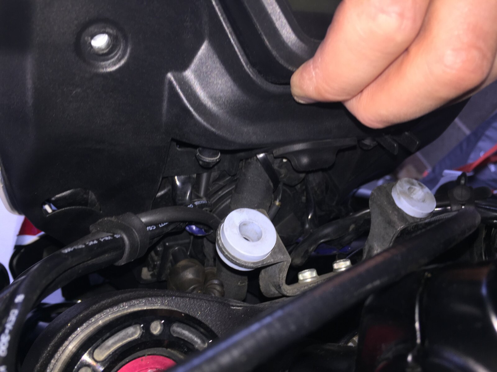

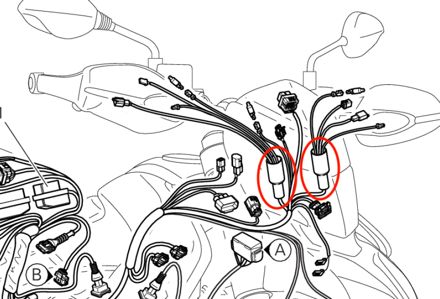

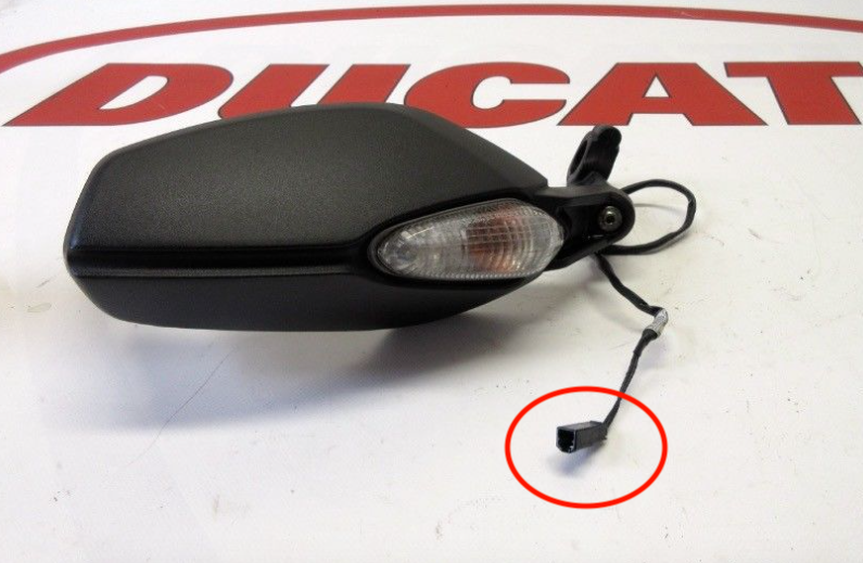

    Im wanting to remove my hand guards and replace with normal indicators and replace the plastic guards with alu hand protectors.
    Trying to find the connector but without success. The part i found on google shows the connector but when i look at the wiring loom on the OEM spare parts it seems to go straight into the main loom. Unless its under those 2 plastic grommets. Hopefully it not as it looks more than just a 10 min job!
    Anyone done this?
  2. Those parts you circled are just rubber covers, the connectors you seek are hidden within!
    To get to them ...cowl off, 4 screws, headlight out, bit of a struggle. There's a mass of wires tightly packed in there, and if I remember correctly, you need to cut some zip ties to move some of the connector blocks to access some hidden screws to fully access all the wiring or get the lamp out.
    I replaced a smashed handguard a couple weeks ago, probably more than 10 minutes to get it all apart, but easy nuff once you're in there.
    Dave

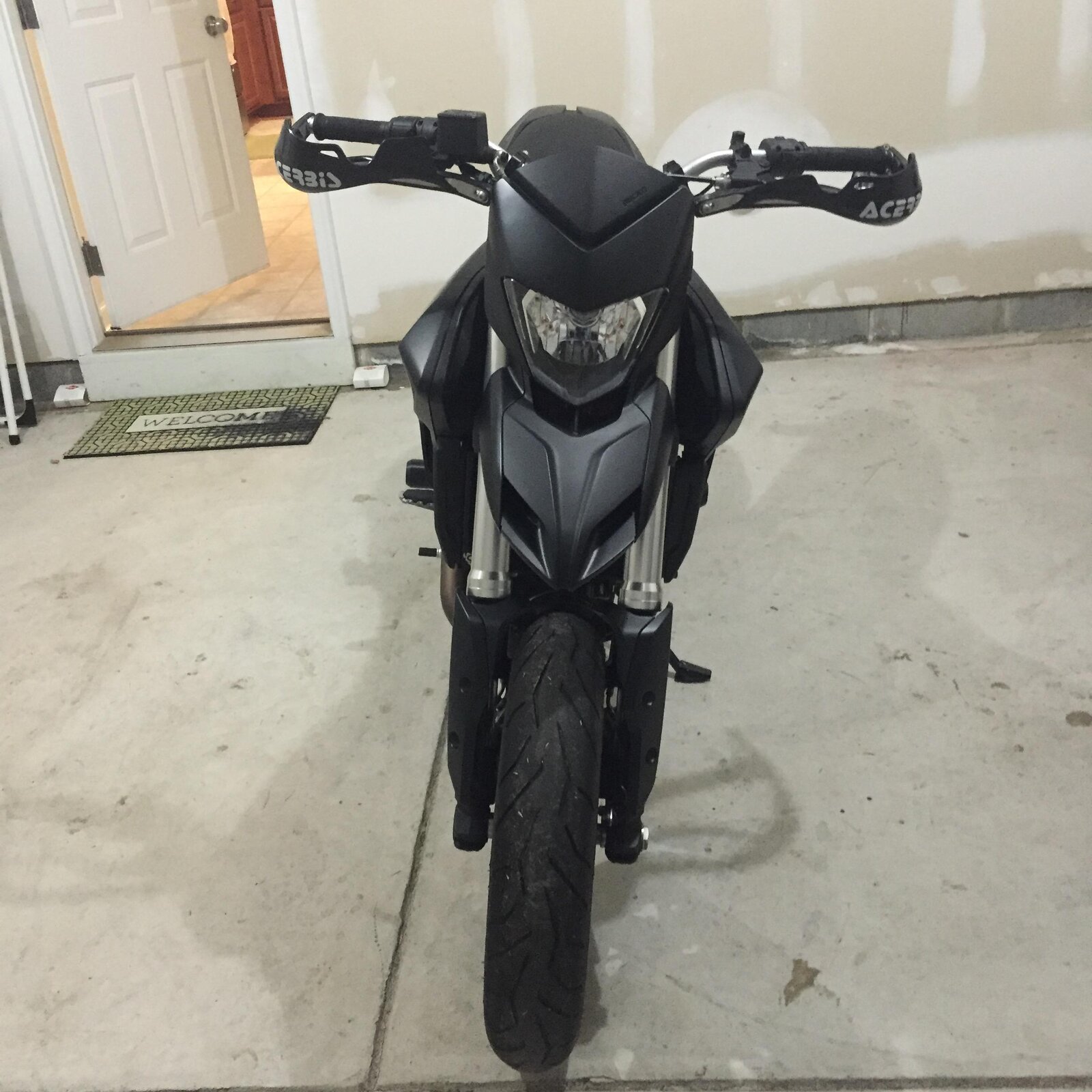

  5. Bump! Does anyone have any pictures of their 821 without hand guards or different hand guard options? Looking for inspiration
  6. Interested in this also
  7. I'm either going to take them off completely or found this chap who fitted the Acerbic guards..
    Doing some research into which guards they are, I think it's these, £65.00 on Dirtbikeexpress;

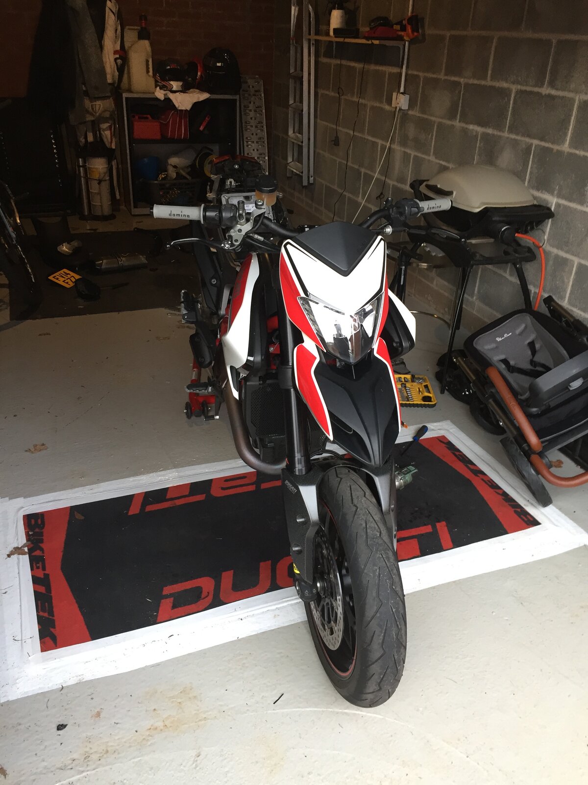

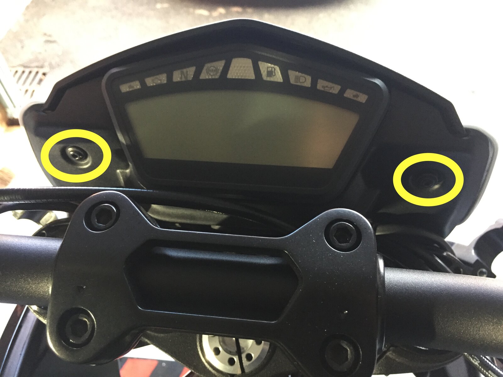

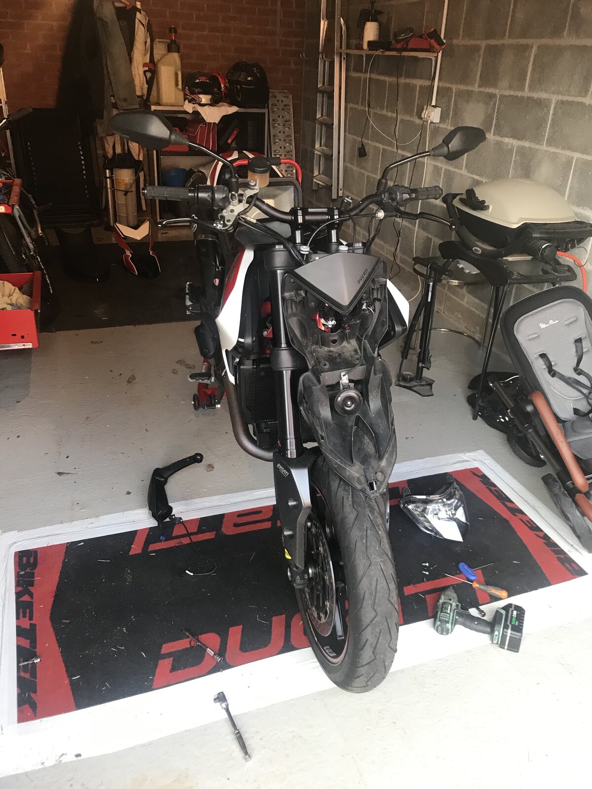

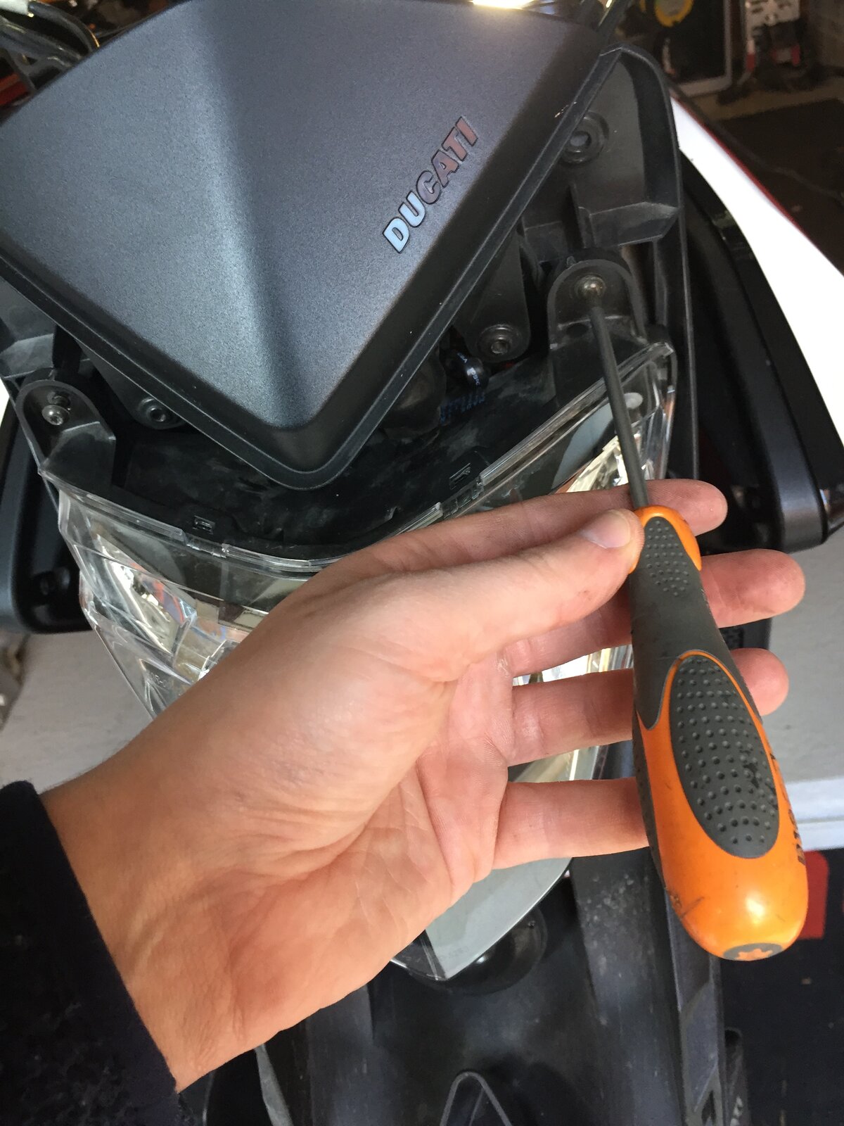

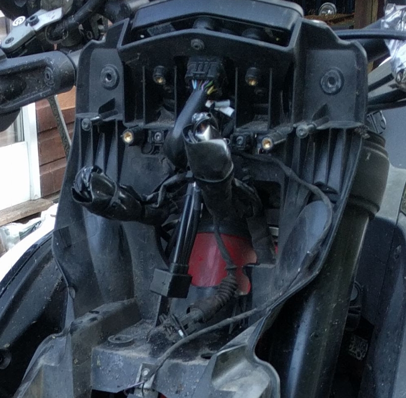

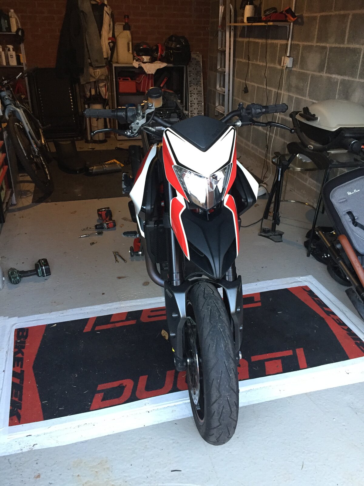

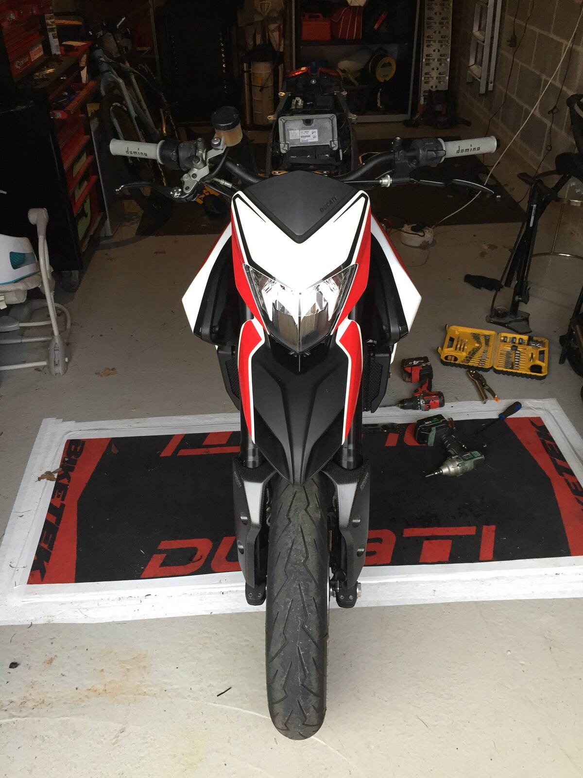

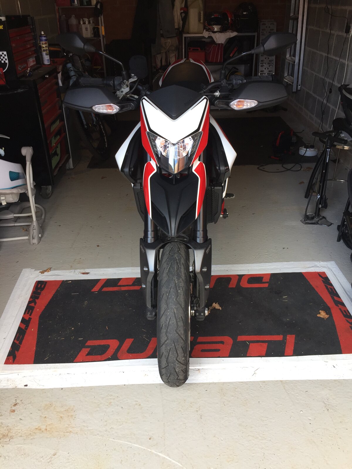

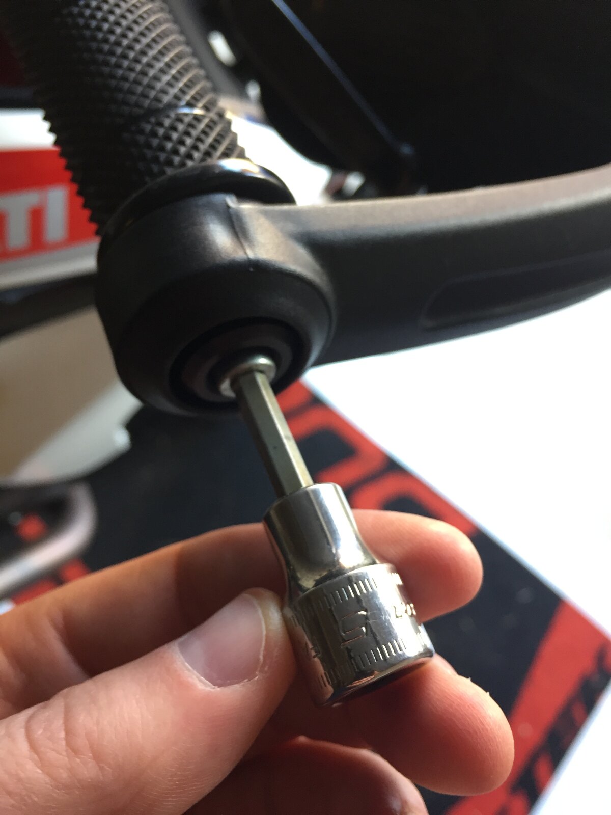

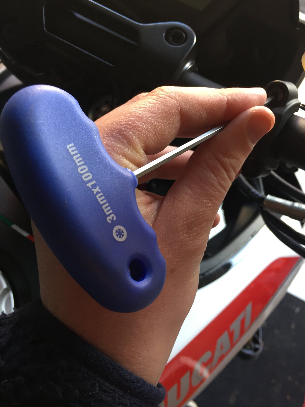

  8. Just removed my hand guards, as Dave said, very simple but just a quick how to to assist noobs like me in future;
    Before:
    5mm Allen for both bar ends:
    3mm allen handlebar clamps:
    These two (3mm Allen):
    Lift the whole headlight / mudguard unit up. Lifting them out these two lugs:

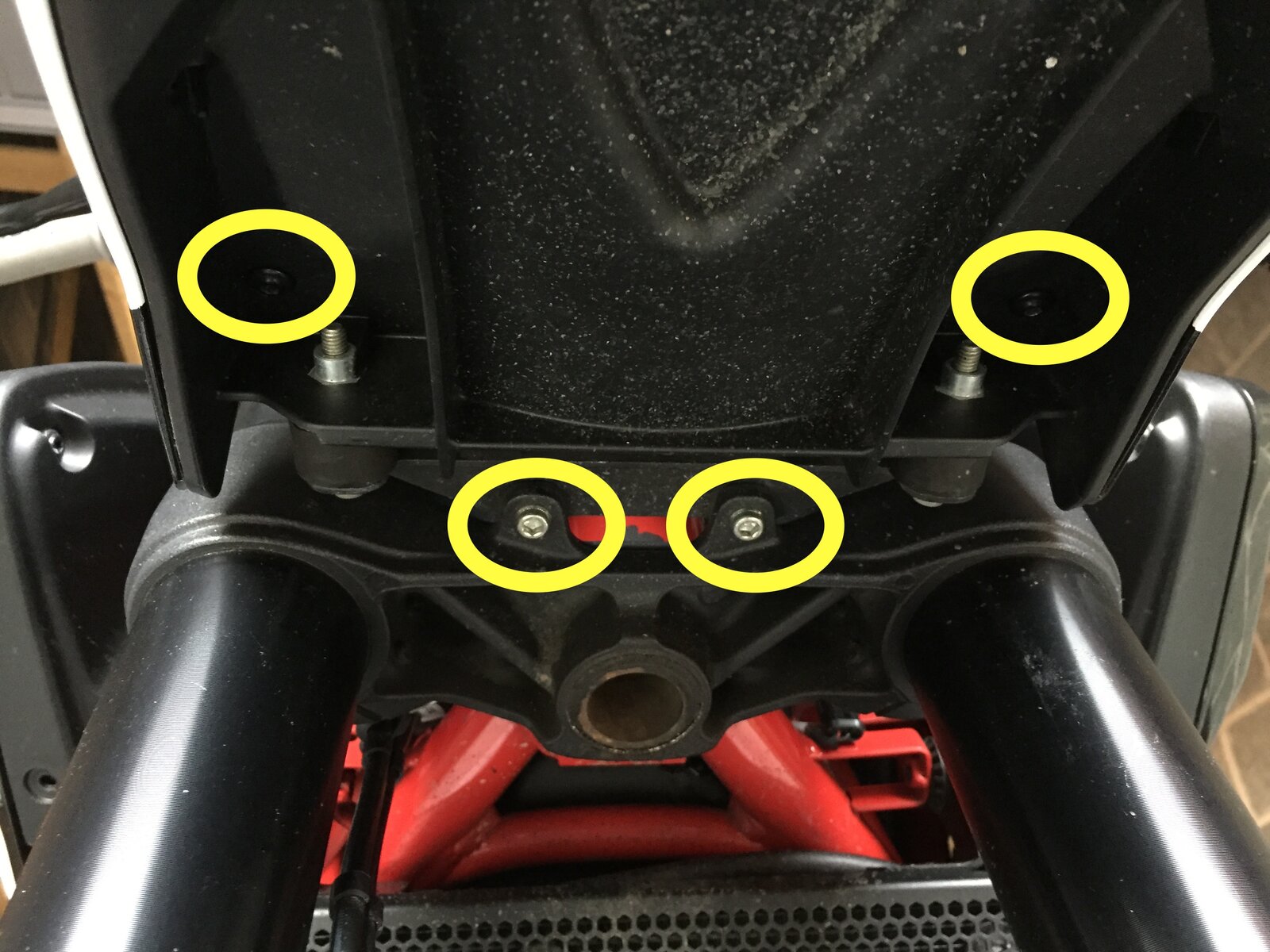

    Looking under mud guard, remove these four:
    You can now remove the outer fairing allowing access to two hex (T29) at the top of the headlight. Once removed again this lifts upwards from some lugs:
    Looks quite cool:

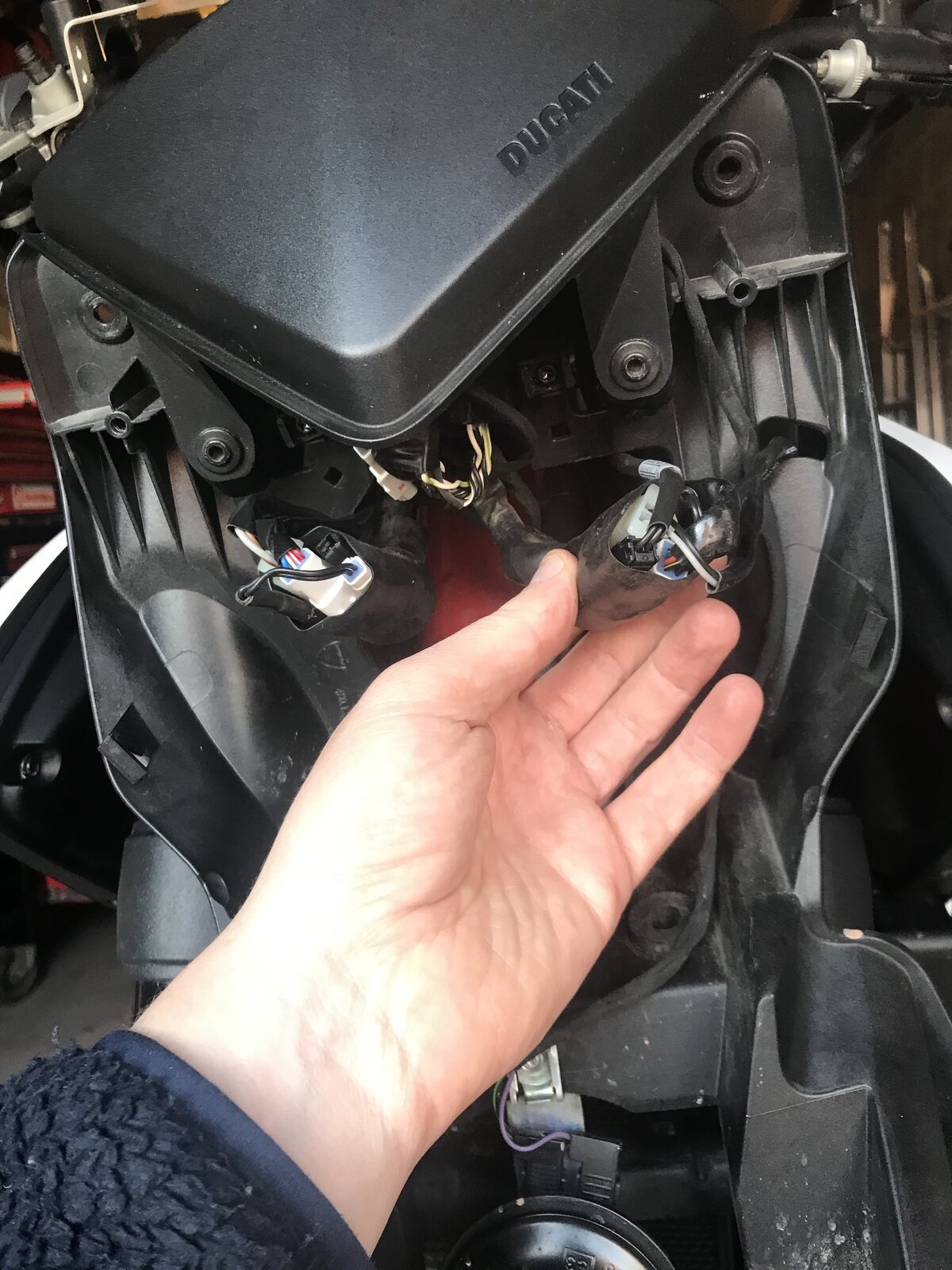

    Pull out the two bundles of cabling from behind the screen:

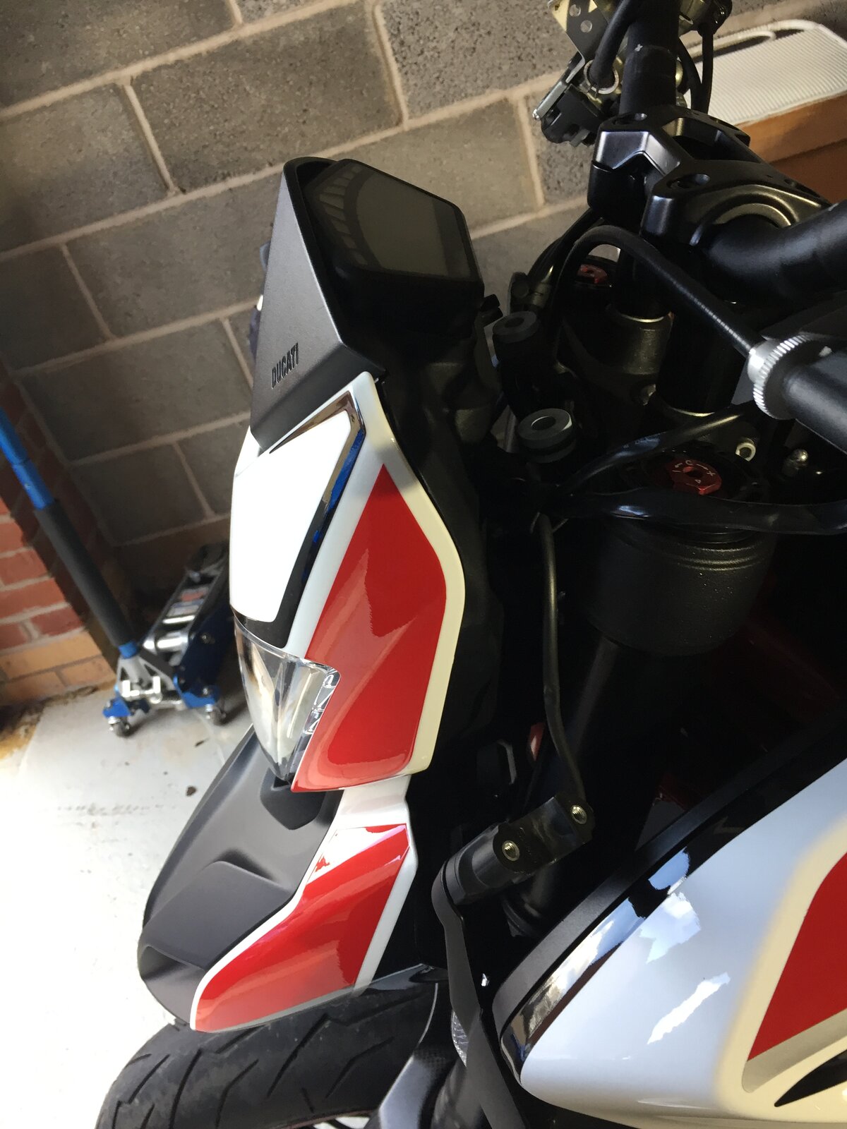

    You can then pull of the indicator cables out and completely detach the handguards/indicators. Once removed I wrapped up the open sockets with electrical cable. Repack the bundles and re-assemble everything.
    After:
    I had some Domino spare grips laying around from my Panigale so fitted them and looks heaps better imo :cool::
