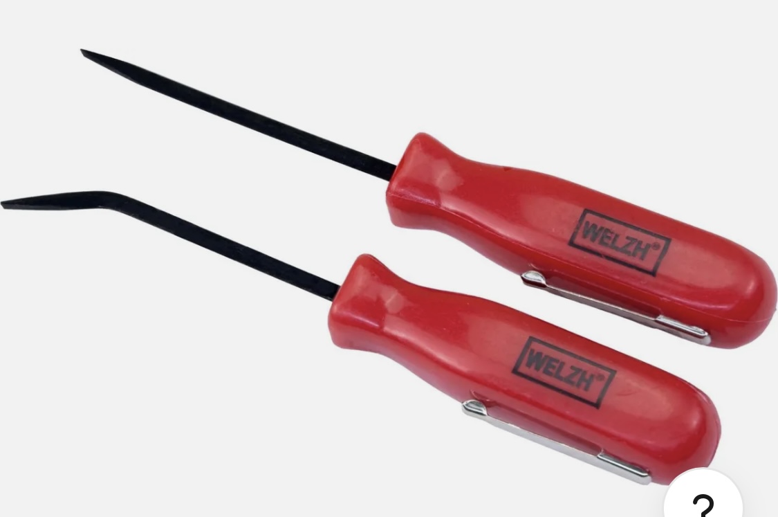

  4. I got mine off with a hooked pick... wasn't too difficult, but installing the new ones was a bit of a struggle..I found it easier to lightly grease the insides and install them without the valves in place. :upyeah:
  5. How did you use the hooked pick? Did you pry from under the seals?

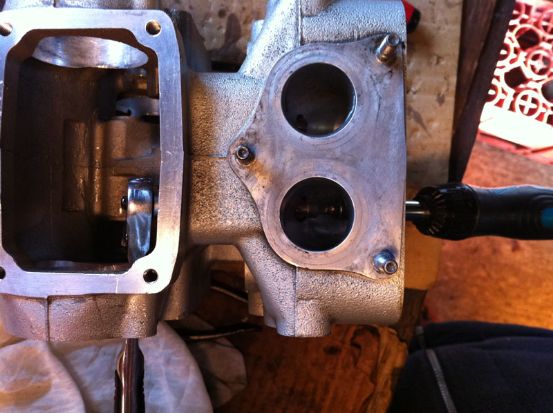

    I have taken some pictures of the 888 heads - Looks like later designs made a better reserve for fitting a plier.

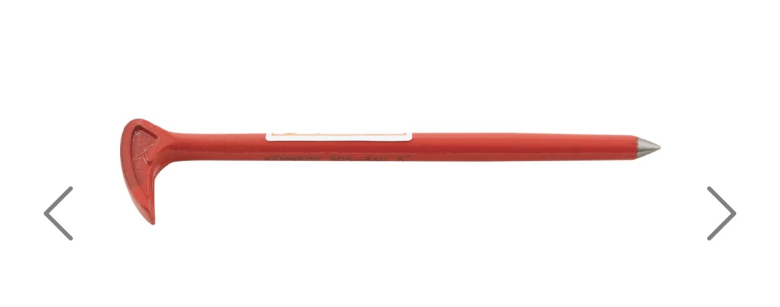

  7. IMG_8855.jpeg IMG_8854.jpeg as you said, a horrible job to remove if all original. As hinted at, any sturdy dentist-type pointed tools or small heel/pry bar (similar to below but with a bent end), definitely sharp-straight bladed or pointed is the only way. I have used modified pry bars in the past where close to the tip is bent to achieve around 90 degrees* but depending on how well hardened they are, how far the hardening extends beyond the tip, makes even this difficult to do. Ingenuity and invention is the clue, as you well know already. I've tried to find videos more info but without luck so far.
    * this is so the end of the tool can rest on the casting "floor" to achieve upwards leverage but even then, you only have 15 degrees or less of "prying movement" due to the confined space. Two prys would be perfect but "rocking" action applying tool 180 degrees alternately usually the most practical.

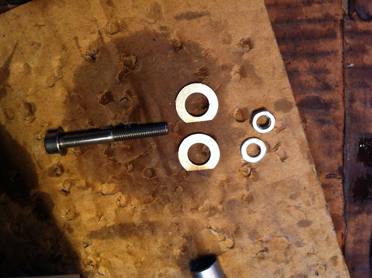

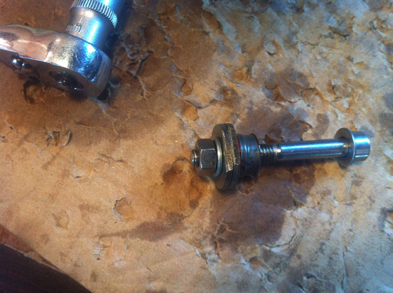

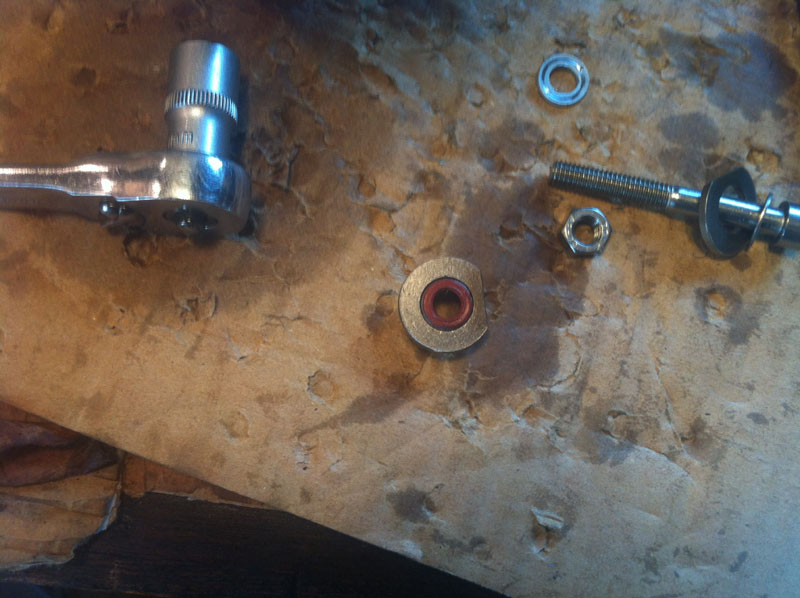

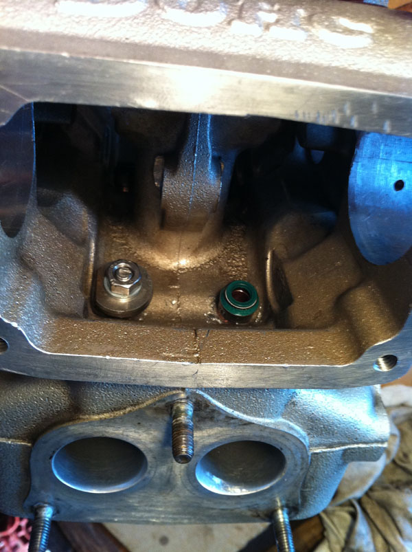

  10. I replaced the seals on my 916, IIRC I used a pair of bent, long-nosed pliers to pull them off AFAIK 888 heads are pretty similar? (though looking at the above pic, maybe a bit more room in a 916?)
    As for fitting new ones, I used a nut/bolt and 'modified' washers to pull them into place rather than try bashing them in with a hammer - much safer and less likely to damage anything.
    Some pics;
  11. tip of the iceberg stuff here, but fitting is, or providing valve guide diameter is reasonably correct for that stem-seal, fairly easy. You should always use a "draw-bar" that is similar in appearance and diameter to the valve stem - I wouldn't use the above with the threaded portion of a bolt adjacent to the valve stem lip upon fitting. Sometimes when stem seals are at the tighter fitting end of the acceptable fitting diameter spectrum, the seal will compress slightly and spread inward at the lip seal area (sometimes 2 or 3 lips over the years) and so could be cut/slit by anything other than a smooth surface.

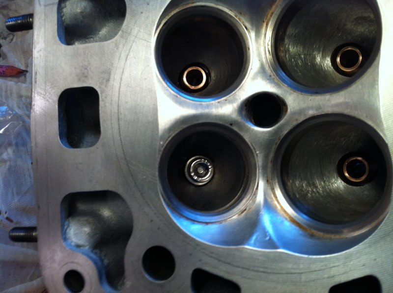

  13. I was planning to use this approach too for insertion, except that I was looking to insert the smooth side of the bolt nearer the seal to avoid exposing the seal to the threaded bolt.
    If you see the space inside the heads that I posted for the 888, the casting is very different to your 916. A lot less clearance between seal and wall in the head. The thickness of a valve removal plier ends does not fit between seal and wall. And you can't position them top/bottom because then the pliers do not fit in the inspection cover anymore.
    The more I am reading about it, there does not seem to be any clean way without butchering the seals.
    and if I butcher the seals, I am thinking that I may as well carefully cut the metal band as it is probably the best way to avoid creating any damage to the valve guides.
  14. As I mentioned in my post, a nice sharp narrow chisel does the job with no fuss.
  15. I've got '91 851, '92 851, 888, 916, 916SP and 888/926 Corse "G" heads here and there's NO difference in the placing of the Valve guides in relation to the wall of the heads.
    Steve R
  16. If you look on the above pictures, the inside does not look quite the same, does it?
