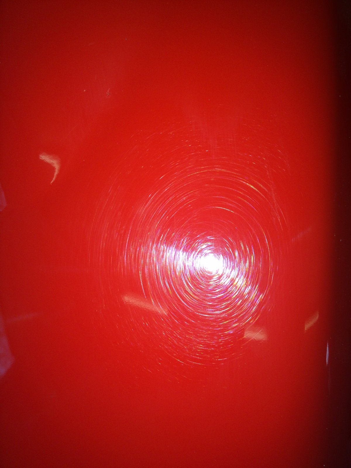

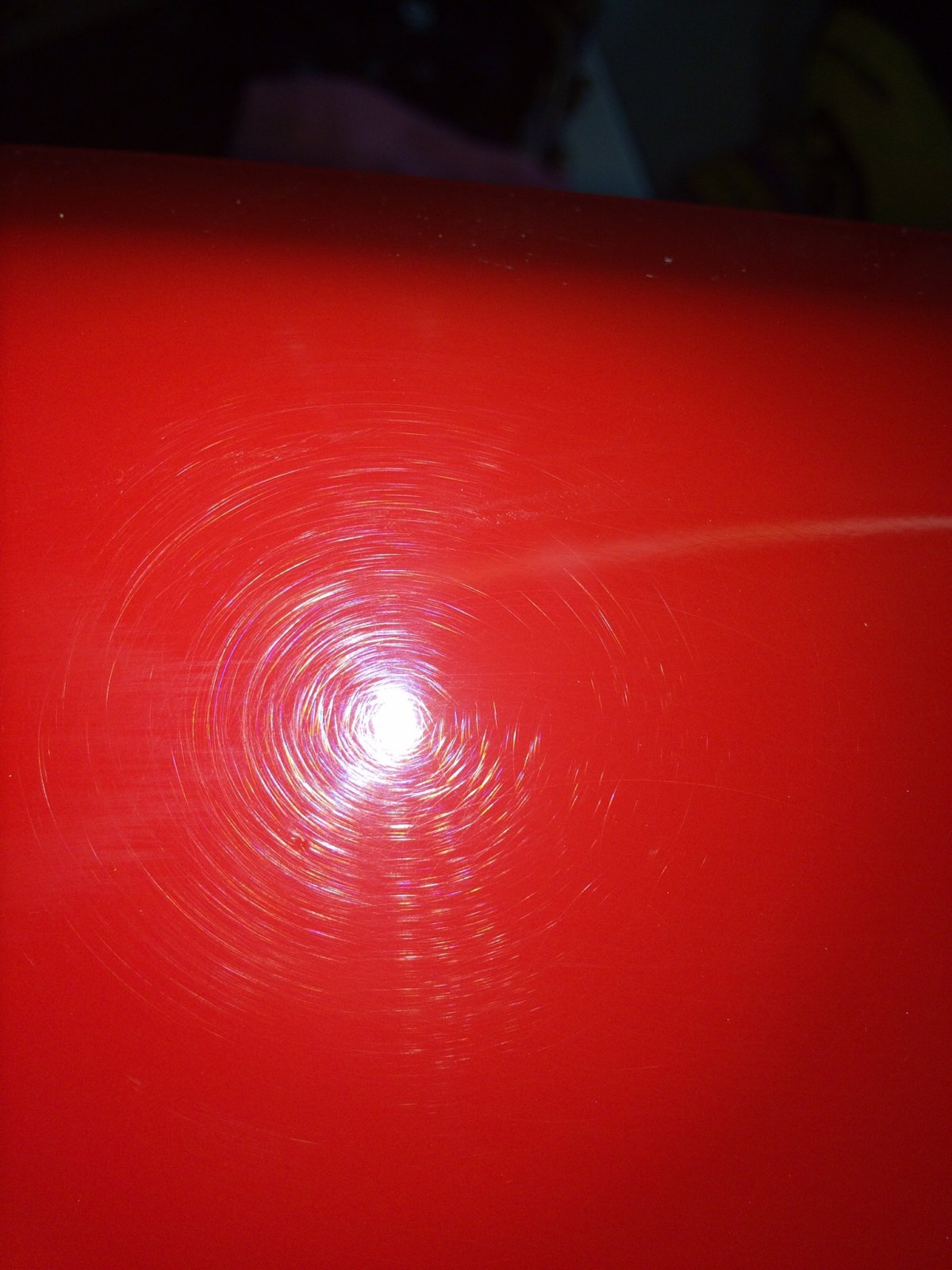

  14. Seeing as I was cleaning my car anyway I dug out my old cbr seat cowel and set about inflicting some swirls on it with a rag off the floor so you get an idea of what can be done without cutting compounds.
    This is it after buffing it with a gritty cloth-
    All I did at this point was two passes with dodo juice lime prime by hand working it in well and buffing straight off followed by one coat of their Orange wax.
    There are still very minor marks but they are very hard to see in natural light and the camera flash only just picks them up, I'm pretty confident a sealant before the wax would cover them completely.
    After-
    Hopefully that helps you out, I have no doubt that super resin polish would give the same if not better results after a few passes but I don't have any so couldn't try.
