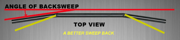

Renthal Bars 1200 Mutly for sweep..? no i don't mean sootie.. I mean am I the only one that thinks the Multistrada's bars are built for offroad only. The sweep on them mean you have to ride the bike with your elbows high Now thats great if I am standing up doing a bit of off road, But How many of us actually do off road. I recon at a guess about 95% of us do not. So a better sweep back on the bars would make it more ergonomic. A better fit our genral riding style. ANY WAY . my question is this does any one else think [FONT=arial, sans-serif]this ? [/FONT]Has any one else fitted a better set of bars? love to hear, regards Biker Dave.

HI guys than's for replies. however i really don't see how risers can help. As I have tried moving bars around, this helped a little. My ideal fitting would be with the sweep at the ends in more. this would fit my natural body arm/and position as i ride the bike. Im 5.10" and find the bike really comfie apart from the bars.
I agree, I too want the with a more backward sweep. Using the risers allowed the bars to be rotated backwards to achieve this to some extent. Without the risers the controls would hit the tank on full lock.
Derek hi Glad Im not the only one then. As I say if i stand up in an off road position it fits great as my elbows and stance is much higher. But as soon as i sit down my wrists are twisted inwards meaning I have to raise my elbows high to sit right. Now thats alright for a bit but once you relax your arms. (twisted wrists) So has any one ever seen a set of bars or used a set that gets over this? Get on your mutleys riders and see for yourself and give feedback. ( maybe its just my bike? )
