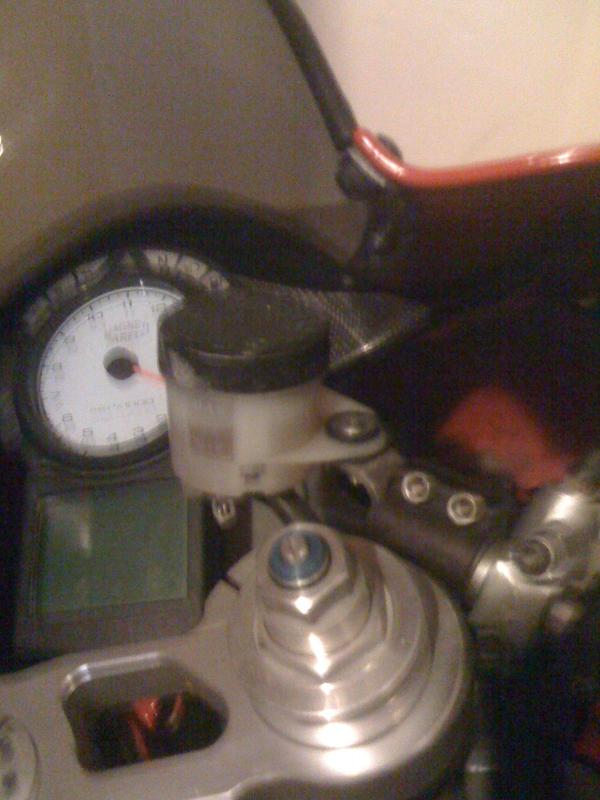

  2. I've fitted Cyclecat raised bars on my 999 that come with adaptors to use old stylee round reserviors. All the parts are standard Brembo as far as I know, the shaped reserviors just unbolt from inside. Then a plastic elbow with 'O' rings goes in the fluid hole. You could probably get the parts required from a breaker or ebay cheap enough to convert. the inner end of my bars are drilled and threaded to hold the bracket.
    Keith.
  3. Thanks, I think if I'm going to change the reservoirs then I'll go the whole hog & upgrade to a brembo master cylinder & lever. I do rather like the shape of the originals though, especially with their Titanium covers. :cool:
