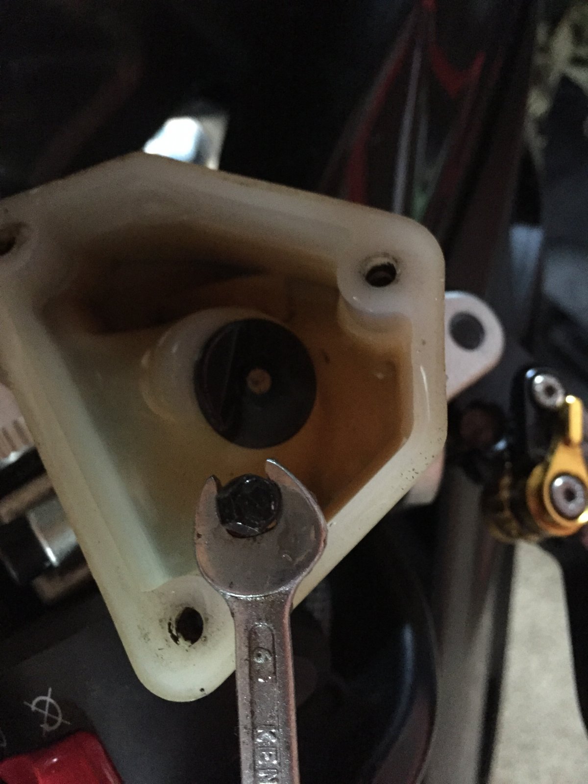

  8. Looks like I'll be needing that Nelson, tried loosening the screw and the head snapped off :coldsweat: IMG_1096 2.JPG

  9. Just thought I'd close this thread with an outcome. I tried to carry out Nelly's instructions and unfortunately snapped the head off the bleed screw for the master cylinder.
    I then received the master cylinder from Nelson (thanks!) and amazingly and thanks to Matt managed to change the master cylinder. Having done so, I then tried bleeding and repressurising the system according to the instructions from Matt and the Youtube video he supplied. It didn't go quite to plan as the brake lever would still not get upto the pressure I needed. I then reverted to Nelly's instruction and tried loosening off the bleed screw for the master cylinder (as described above) and everything came back to life. Which makes me think, if I didn't snap the head off the screw, maybe I didn't need a new master cylinder at all!

    As you've found out, this video misses out the fact that on a radial master cylinder you have to bleed it at the cylinder as well as the calipers.
    As for the old master cylinder, you could always get a new bleed nipple - providing you can get the old one out - put it back on and then see whether or not it needed replacing. If it's ok you could either sell it on or I guess, keep it as a spare. :)
  11. As Ducati don't sell seal kits due to indemnity issues, a spare master cylinder may be a good idea if you can get the broken nipple out.
